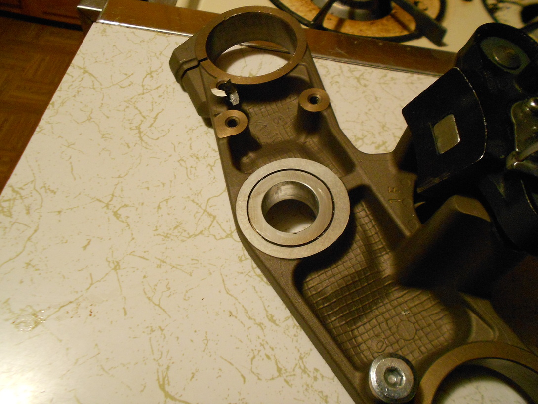

Today was steering stem day. I did not try and cut the ZX7 stem flush, so I pressed it out and cut it too long.
Then I machined it back down to the correct dimension
I pressed them together and got this item, ready to install
Pressing the new stem+bushing into the ZX7 lower tree was going great......UNTIL....the dreaded SNAP!!!. I thought I had the tree supported correctly, but I was rushing to get home and I screwed up. This is what 40 tons does to an off kilter triple tree
Whoops. Good thing I am going with ZX9 forks and the triples are the same, so I get another chance.

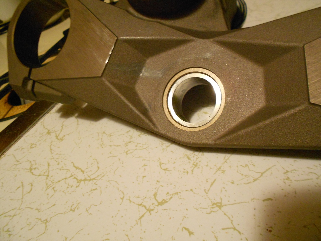

New lower tree arrived. Got the stem pressed in with no problems this time, But something was bothering me. The top triple has a tiny bit of slop at the top between the ZX hole and the KZ stem.
I chucked the ZX stem in a lathe and bored out the inside of the top, past the threads to the outer diameter of the KZ stem. Then I band sawed the threads and the portion I needed off to make a tiny spacer. (it isnt pressed in yet because I need room to put the adjusters in first. Since the KZ item bolts from the top, it should work out OK.

glad you got it worked out.having to bush the upper triple to fit the kz stem is pretty common in these front end conversions.
here is a zx10 upper i had to do.
