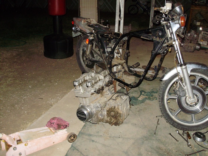

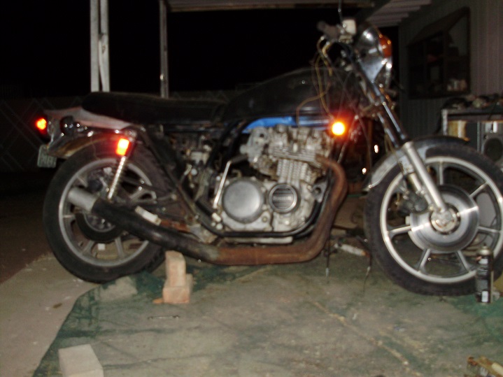

First pic is with the 650 engine with a Yosh pipe mocked up. Looked cool I thought
Second pic is with the 650 engine out, I thought I had pics of the 750 engine in. Hmm, gonna have to remedy that later.
I don't know why the last pic is in twice.

Here she is as she sits now with the '82 KZ750 engine

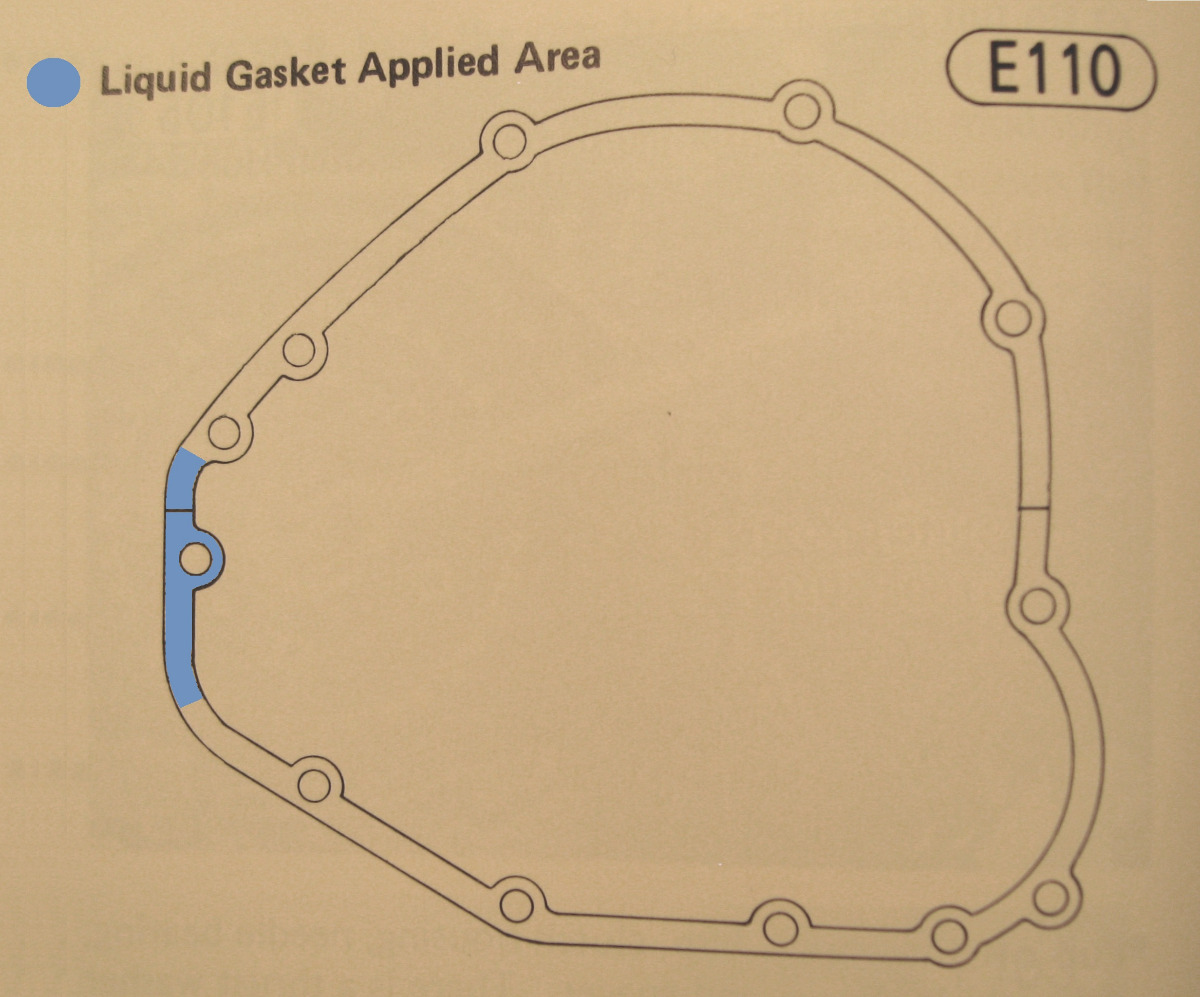

Pics 1. The new cable holder. The others are of polished covers temp installed to see how they look. Does anyone know if the late KZ/early GPZ cases were machined to take the kickstarter like '80 and later KZ 650 cases were? I don't want to take the clutch cover off without a new gasket handy. I have a kickstarter assembly and clutch cover ready when I do get the gasket. It's a good thing to have when the battery is low or just "cool factor". The covers look the same screw placement wise. I'm just hopeing the machining is there to install the kickstart hardware.

I have to check out some pictures in my manual. i plan to pull mine down a bit--starter clutch again. You really dont need a gasket Yamabond will work fine to seal it up. When you want to get the cover off, a good few raps with a rubber hammer, or a wood piece against folded towel,down or up on the cover will crack it loose.... you need a bike stand for your ride. Either wheel off ground .......pics for you........Ray+KAZU the Staffie....

27 May 2014 06:16 - 27 May 2014 06:17azman857 wrote: ........... I don't want to take the clutch cover off without a new gasket handy. I have a kickstarter assembly and clutch cover ready when I do get the gasket. ......
You are a smart man. Use a gasket; it's there for a reason. Also, check the Kawasaki Service Manual to see if and where a small amount of sealant is required. On the KZ650 there is one small spot near the rear of the gasket on the engine case side where sealer is required. This is where the upper and lower engine cases meet and the sealant is used there to seal the spot between that seam and the gasket. The image below shows the sealant area for the KZ650-C1 clutch cover. I have used this method and never had a leak. Ed
