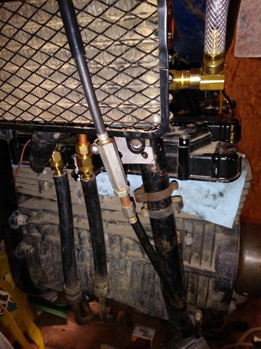

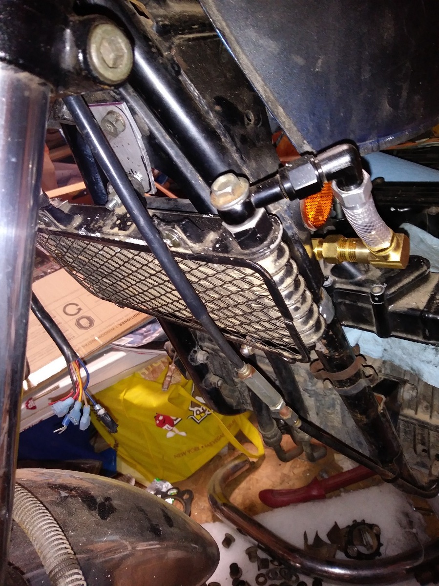

I have been working on the project now and again but nothing of any major progress until of late. I've added a rear wheel and brake from a later and probably bigger KZ. I still need to finish connecting the brake stator rod as it is different attachment design. Also a larger oilcooler is going to used. It needed o be modified to be used and a mounting to the frame will be a custom. Oil cooler lines will be sliced and diced to fit. I will attach pics after I resize them. I still need to cut some steel flatstock for the brake rod. Pics will be taked when that happens.

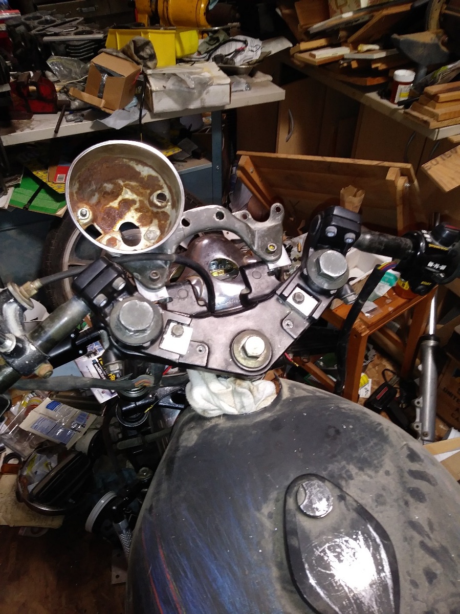

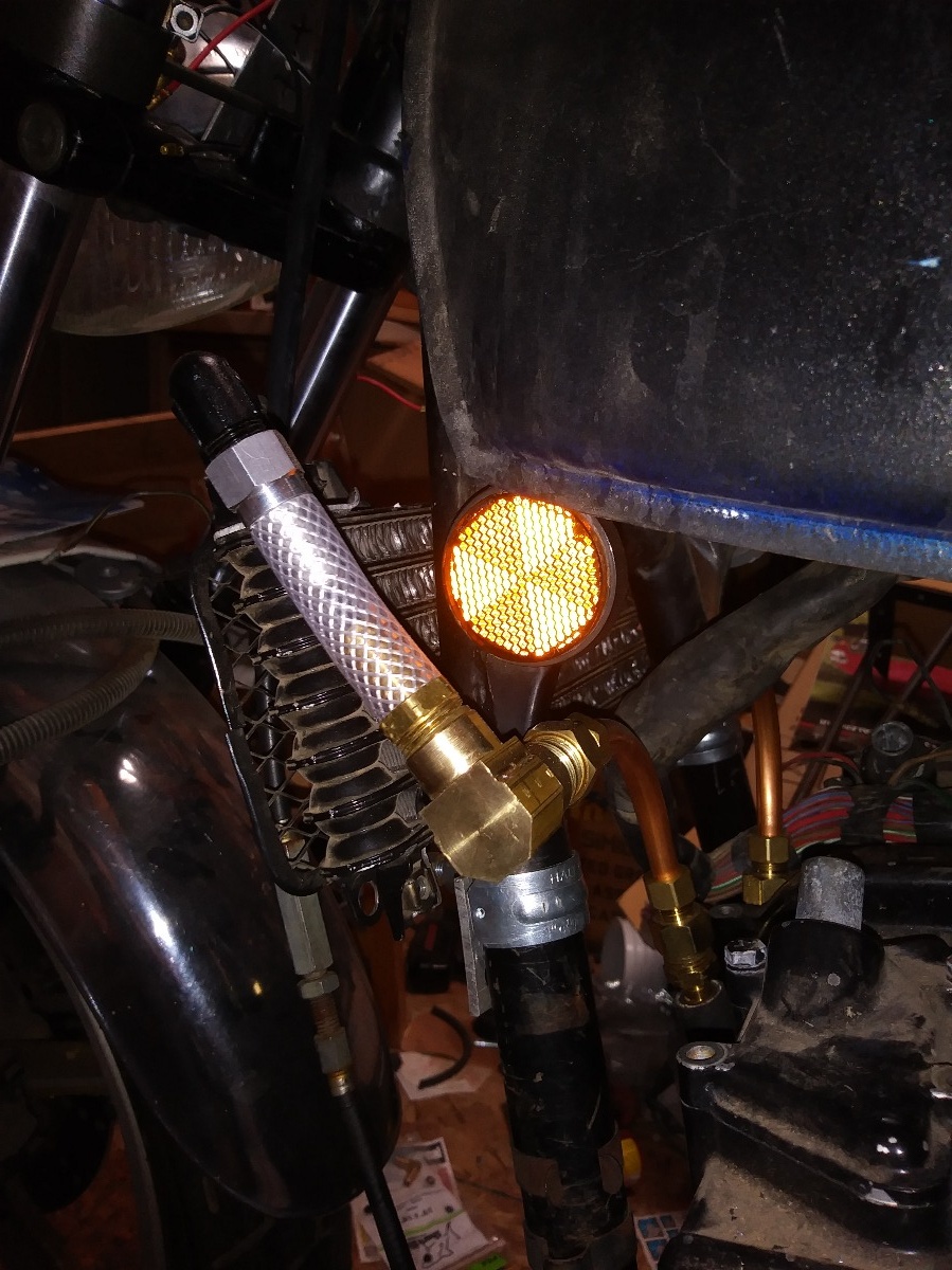

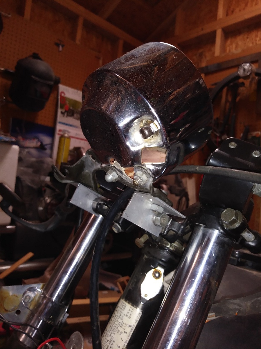

Can't believe its been this long since I've added anything. The project is still progressing! Plumbed the oil lines with some copper tubing. Installed the oil cooler upside down to keep the oil in the cooler between runs. Instrument mount complete. I'm using XS 650 housings and a Digital Speedo/Tach in one and USB port and voltage meter in the other. No mechanical gauges. I'll have to mount magnet or 2 on the front wheel. Haven't done that yet. Still working out what will work. Of course, anything is subject to change.

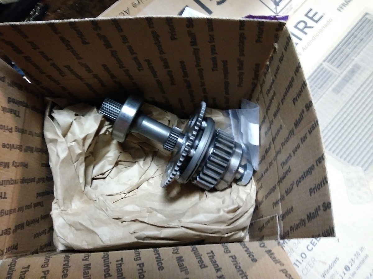

Look what showed up in the mail!
A ZR starter clutch and shaft. Now if an oil pump would show up on ebay at a reasonable price...

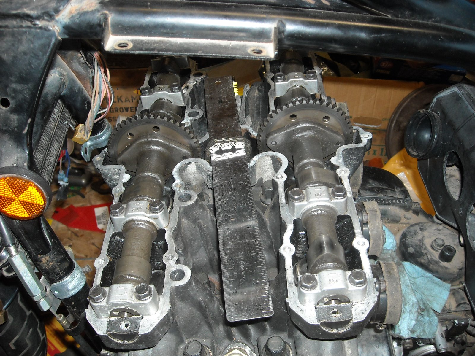

Last night I finally got the clutch nut loose to get the clutch out. Used the heat gun on it. High temp. Been trying a week with the holding tool, socket on a 1/2" breaker bar and a cheater pipe. Took 2 tries but it broke loose.Got the secondary shaft out after the oil pump was taken out. Everything is in position to be installed tonight. Get the later ZR starter clutch in, get the clutch reassembled and the cover on. It'll be nice to move forward again. Next would be to finish getting the head finished. Installing the buckets/shims and cam chain.Get the shims right for the valve clearance. Progress!

Been messing with valve adjustments. It's taken quite a few nights and 2 trips to the old bike store to get the shims needed. Now to get it all timed up. WHEW!
