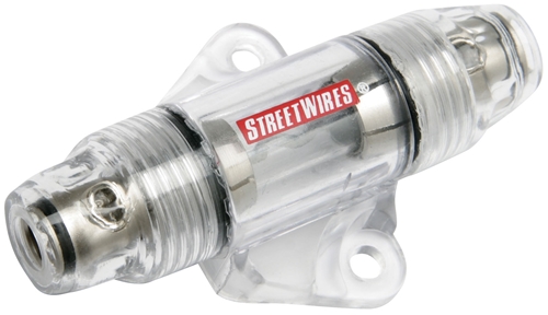

Also whilst I remember, did you put a fuse between the m-unit and the battery as they suggest in the manual?
I went for one like this in the end as there aren't many choices for thick wire fuses
On some installs people have put a fuse in, on others they have not.

No I put in a breaker switch that powers both the M-Unit and my mosfet R/R. I don't like carrying fuses, it's part of the reason I went with the M-Unit.

18 Mar 2016 09:31kaw-a-holic wrote: No I put in a breaker switch that powers both the M-Unit and my mosfet R/R. I don't like carrying fuses, it's part of the reason I went with the M-Unit.
Interesting, do you have any more details on that, so I can see whether I can source one. As the fuse system isn't ideal and I would prefer not to have to worry about carrying a spare fuse.

18 Mar 2016 14:12531blackbanshee wrote: here's some
www.delcity.net/store/Auto-Reset-Circuit...ZIKjH-Rw8aAstA8P8HAQ
Thanks a lot. Interestingly they only seem to being sold in the US or Oz. Not found a uk supplier yet. I've ordered a blade style one instead to see if that would be better than my current setup.
