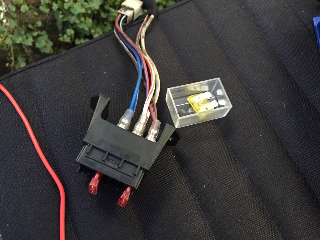

I also tested the new headlamp, but discovered a problem. The side light ring was working, but not the main or dipped beam arggggh!!! I was hoping what I had done already would have fixed that, but no.
I started attacking the loom with a multimeter to try trace the issue back to it's source. I ended up back at the fuse box and this seemed to be where the issue was. However the fuse was fine which confused me. It took me a moment to work out that the issue was actually the connectors being old and rusty.
So I decided to replace the fuse box and see if that solved the issues.
That would be a big fat yes!
I was so relieved as I've been trying to sort that issue out for some time. I even considered getting someone else to look at it, but I was determined that I could find out the issue.
