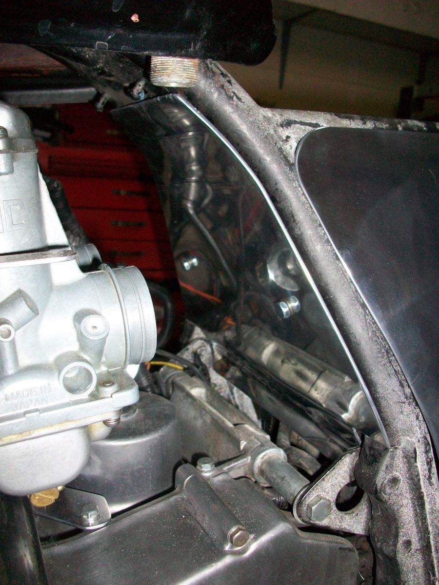

For what it is worth I had relocated my key before I started the Retro-Mod build. I was running pods so I put a piece of aluminum where the airbox opening was in the frame. That's where I put my key. It never fell out. All I ever had was the ignition key with a cloth Kawasaki key ring. I was always told that a heavy keyring is hard on ignition tumblers.
This is a pic of the plate installed prior to moving the ignition.
motogadget.com/en/electrics/rfid-ignitio...fid-zundschloss.html

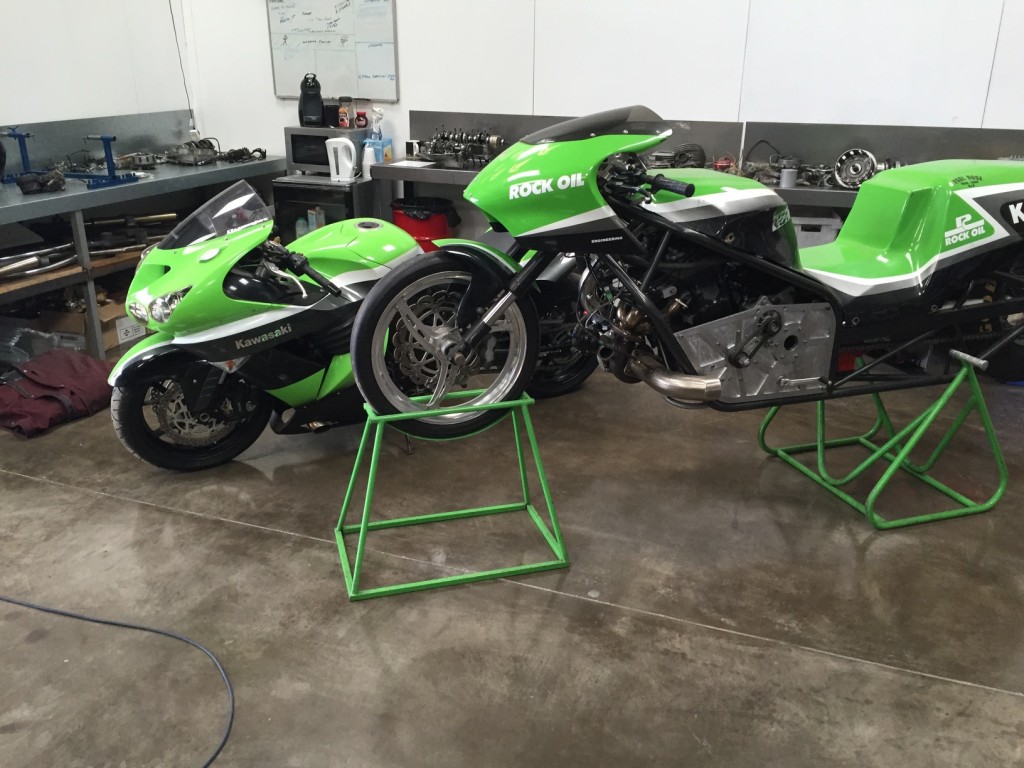

So I promised an update. Well Tim worked his magic on the carbs and timing. He got it so the bike stopped surging at mid revs and re-jetted so that the power was actually smooth line as the revs increased. Test riding it round the lanes and it was transformed into an amazing ride.
However as with this whole project my luck sucks, I rode in the center of town feeling very happy however on my trip the bike completely cut out with no warning. I managed to get it restarted, but the same thing happened three more times in less than a mile. I managed to get to my destination, but I was pissed off. Interestingly when I started the bike to go home it worked fine all the way home.
Once home I checked things through and with discussions with Tim, I think there is a dodgy connection to the coils. I will be checking the wiring through and changing old dodgy connectors.
I took a couple of pics of the shop
My bike hiding amongst many others. So many spares in this corner.
Some drag bikes
