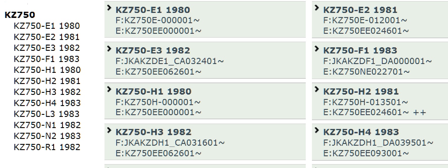

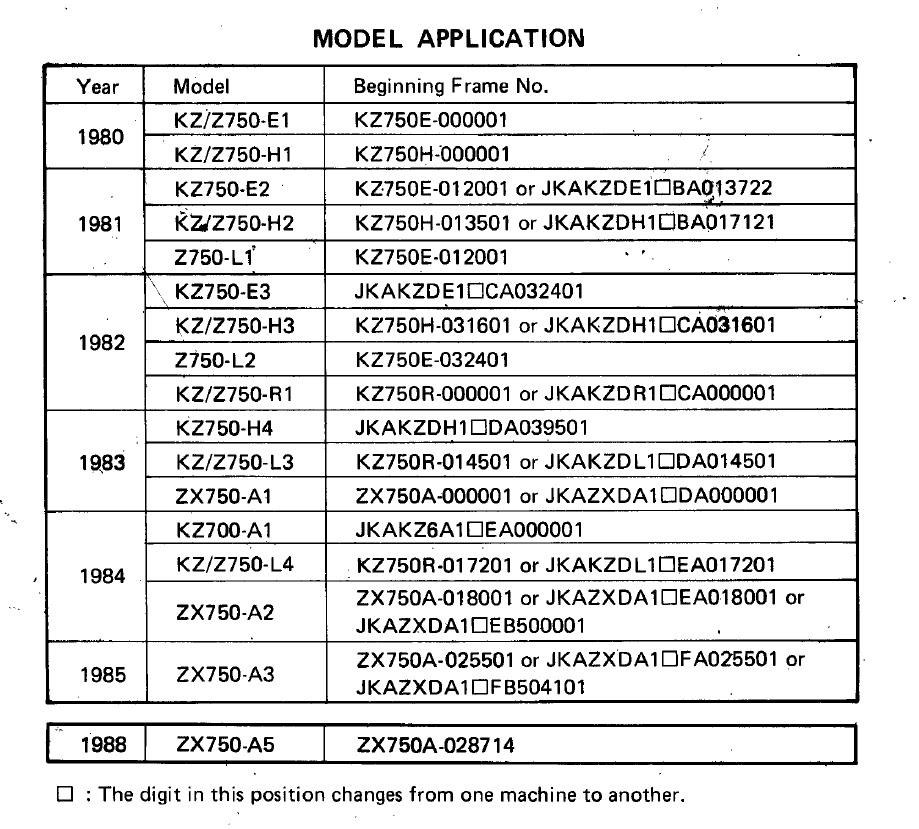

I have had issues with the vin. I tried using the vin but nothing came back on the kawasaki website or the DMV but I double and triple checked the vin on my bike and vin on my title match. Suggestions? Also, this may sound dumb but hang with me here, whats the difference between the 750h ltd and 750 ltd?

Your bike is the 1980 KZ750-H1 LTD. To me it's a 750-4 Ltd chain drive. Aka 750H or 750-4 Ltd, 750Ltd-4 or however else you can think of to arrange the info. :laugh: But not to be confused w the 750E Standard models, 750-4 Shaft models or 750-Twin Ltd models.
As for verifying it, does your bike have a 17-digit VIN? I think some 1980 models don't, so in that case the vin lookup at Kawasaki.com won't work. The muffler stays indicate that your bike is a 1980 model. The later years' stays are recessed in the middle & painted black there.

It's only a 1980, title confirms that. It only has 12 digits so that would make sense as to why it's not coming up. So, when buying parts for my bike, I should be looking for 80 kz750 ltd or kz750h? Like I said before all of this stuff is new to me.

Here's some info found at Z1 Enterprises.
www.z1enterprises.com
Good Fortune! :)

Patton, it is indeed a 1980 kz750 H-1. Thank you very much! Time to get to work now.
