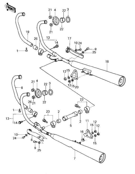

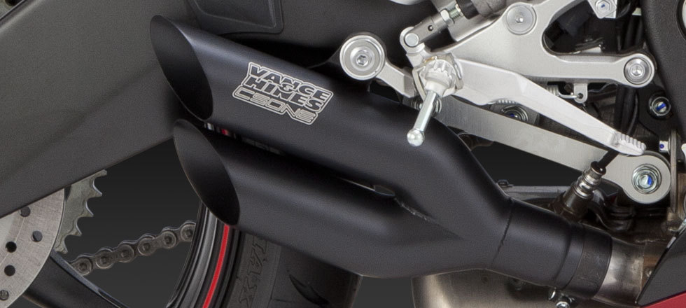

Alright, so if I wanted to attach a different set of mufflers to my pipes, would I just need to add the clamps or would I need to go further than that? I know that I might need to attach them somewhere other than where they would originally go. I am looking at urban brawlers (vance and hines) but I need more info. Any help or feedback would be awesome.

Is there a link available that points to the particular V&H "Urban Brawler" mufflers offered for a 1980 KZ750-E ?
Or is this a prospective fitment project where the desired mufflers aren't designed for the bike at hand?

29 May 2014 22:43Patton wrote:Polarbeezy wrote: Alright, so if I wanted to attach a different set of mufflers to my pipes, would I just need to add the clamps or would I need to go further than that? I know that I might need to attach them somewhere other than where they would originally go. I am looking at urban brawlers (vance and hines) but I need more info. Any help or feedback would be awesome.
Patton, this would be a fitment project for mufflers that were not designed for the kz750. They are designed for the Yamaha R6 and the Ninjas

As I understand the stock exhaust system on a 1980 KZ750-E, it's 4 into 2, with the left 2 header pipes entering a collector, and the right 2 header pipes entering another collector, with the two collectors being connected by a cross-over pipe.
Am uncertain, but the stock exhaust system appears to have each outside header permanently attached to the collector, and the collector permanently attached to the muffler. Whereby cutting would be required to separate the header from the collector. And cutting would be required to separate the muffler from the collector.
If the stock exhaust system is in decent condition, would consider not doing any cutting on it, as cutting would destroy its market value.
V&H Urban Brawler
www.discount-moto-direct.com/vance-hines...6-2012/#.U4jBeShZiSo
Is it contemplated that the urban brawlers will be clamped onto the stock collectors? Or will new collectors be fashioned?
Mounting tabs will likely also need to be created for each urban brawler muffler.
V&H Urban Brawler
