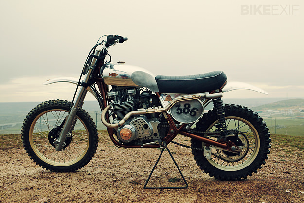

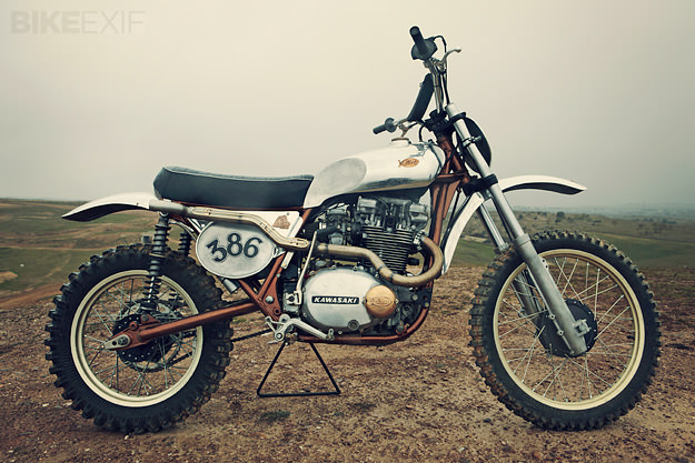

Thinking outside the box...this can be good. There is a member here who has (had?) a 1982 GPz750 scrambler.

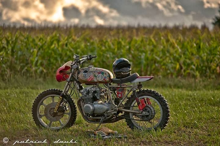

Re: KZ 750 P1 scrambler
05 Nov 2013 08:19
Hoi!
A sticker-scrambler
So the yoke is strait again and the half-baked product looks like this:
A general question:
With "sporty" exhaust and K&N (or similar) pods, what jobs must be done in carbs?
Both-in Keihin and Mikuni, any links in this forum....
greetings

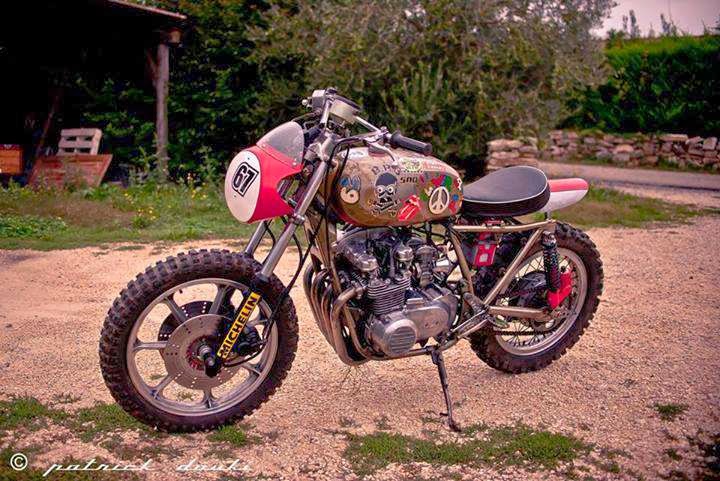

29 Nov 2013 14:07
Hoi!
Got the bike running
Have to make a small windscreen and-GO!
Some issues: the battery alarm is blinking-missing battery sensor?
Bit slow on the lower range of revs.......
And its getting some extra air from somewhere.
Video and picture
Video and picture
