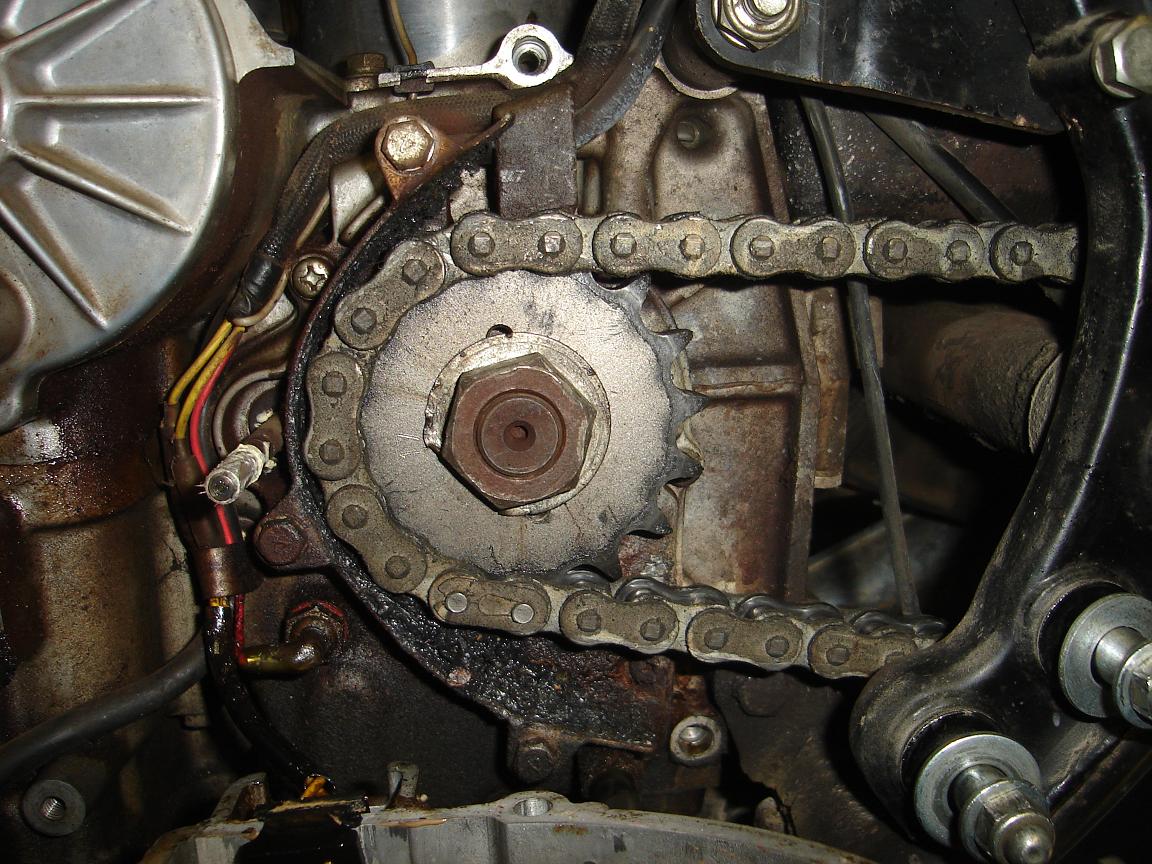

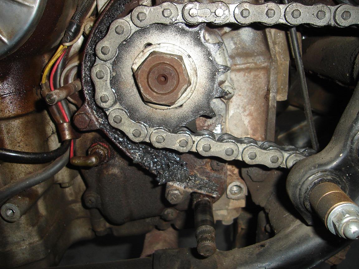

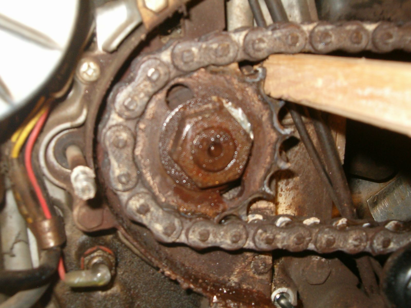

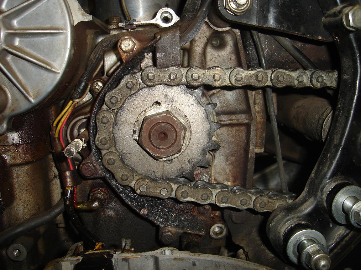

The 18 Tooth front sproket will fit, but the chain guard will have to be removed.
Stock 16 Tooth
1 up 17 tooth
Here is the "tool" I used on the original sprocket (lots of PB Blaster not shown).

Ha! that tool wins the simplicity award.
Great news about 18T fitting. I removed the chain guard (same as yours) and braced the new sprocket against the drive shaft and old sprocket. while slowly rotated the new sprocket the chain appeared to be gently hitting the clutch rod. I sincerely hope you're right and all is clear after my install.
Thanks for your input.
