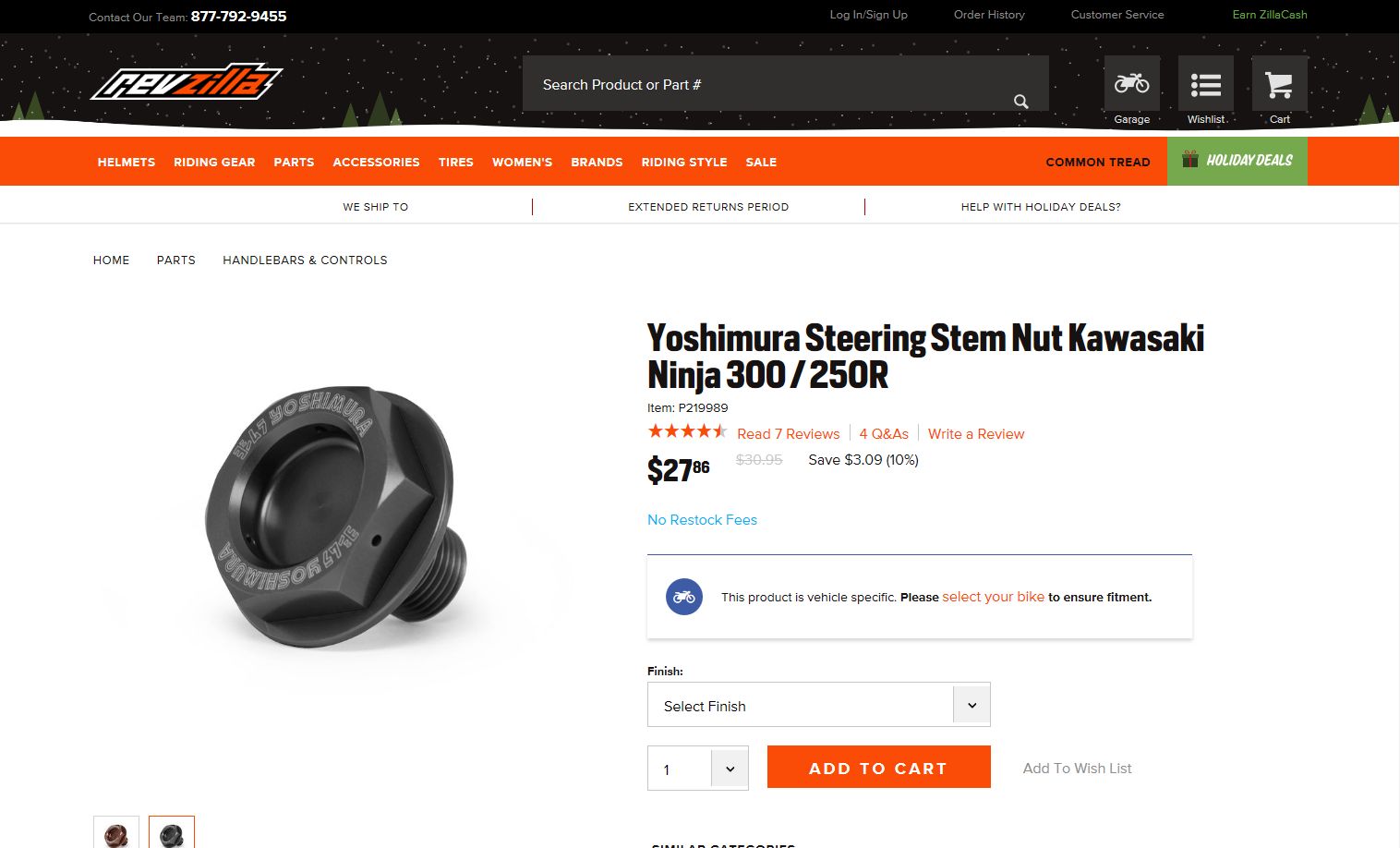

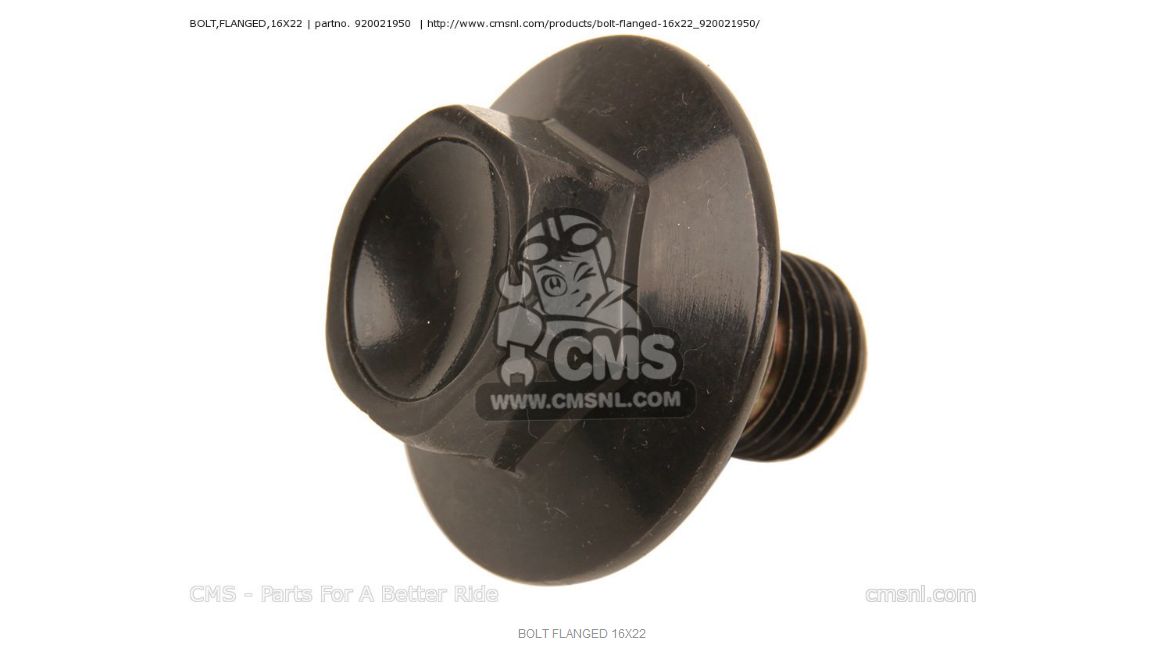

29 Nov 2017 20:46Dr. Gamma wrote: I also replaced the stock steel steering stem bolt with a aluminum one from Yoshimura. That alone saved 1.1 ounces.
Where did you find the Yoshimura Steering Stem Bolt? I can't find any place that offers a Z1/KZ bolt. Is that one intended for a newer model? Any idea which one?

Bolt, Flanged, 16x22 Ex250f4 Ninja 250r 2000 Usa California
fit: Kawasaki
product number: 920021950
CMS product number: KA0020.0627
www.cmsnl.com/kawasaki-ex250f4-ninja-250...021950/#.Wh-xEsZFt-M
Yoshimura Steering Stem Nut Kawasaki Ninja 300 / 250R
www.revzilla.com/motorcycle/yoshimura-st...asaki-ninja-300-250r
DOHC, this could be the one you are searching for.

30 Nov 2017 08:58 - 30 Nov 2017 08:59DOHC wrote:Dr. Gamma wrote: I also replaced the stock steel steering stem bolt with a aluminum one from Yoshimura. That alone saved 1.1 ounces.
Yes Sir, like Scirocco posted. The one foe the 250 Ninja has the same diameter and thread pitch as the KZ1000.
It bolts right up.
Someone out there makes a titanium copy of that same bolt. I just couldn't find it anywhere to order it!!!!

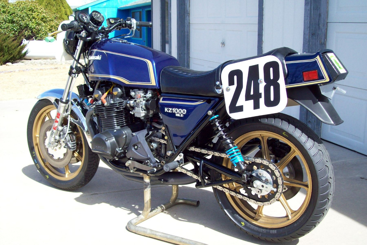

As soon as I get my last order of titanium fasteners, and the hollow front axle for my KZ1000 Superbike, I am calling its restoration complete. Due to health reasons, its looks like my riding days are on hold. This bike is going to be a fixture in my living room from now on. Hope my landlord don't go through the roof. Here is what the final version of my Kz1000 looks like. Its been 39 years since I started building this bike. And this past year marked the first time in 32 years that it has been all together, and running!!!
