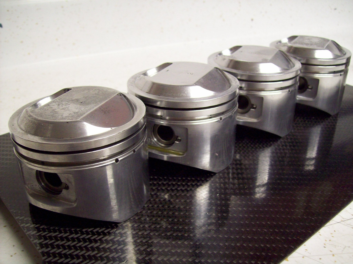

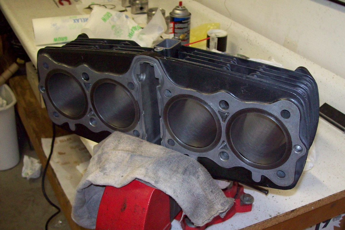

Getting ready to put my top end on my MK II. My fancy cylinder head will be back shortly!!! Found me some new piston pins for my Moriwaki pistons. Got all the gasket areas nice and clean. Spent some time cleaning my pistons up, and ready for the new rings, and then assembly!!!
Wish someone would let me borrow their Kawasaki factory ring compressor tool (57001-532) This will be the first KZ motor that I have put together since 1985!!! And the first without the factory ring compressor. This should really be fun for me. Just wish I could rent a factory ring compressor from someone.

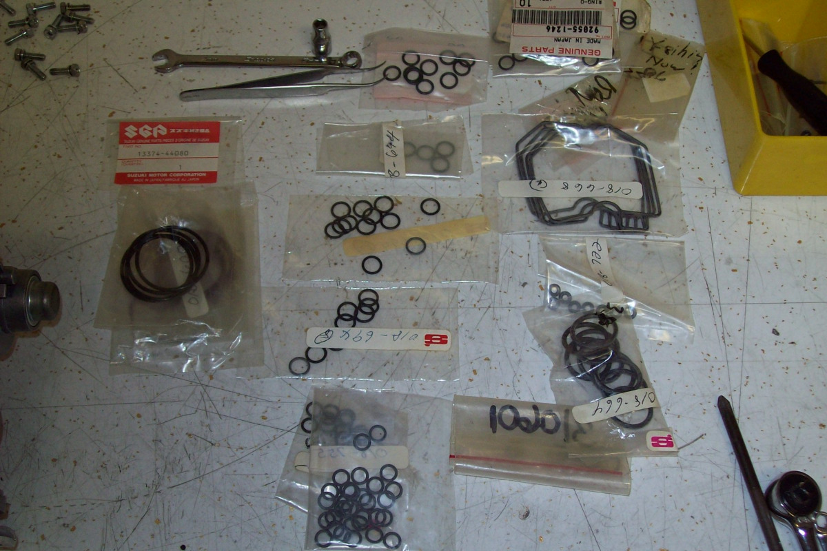

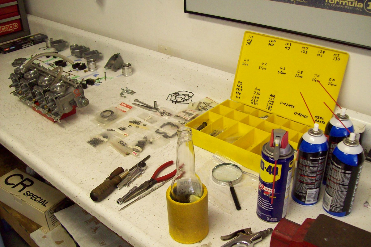

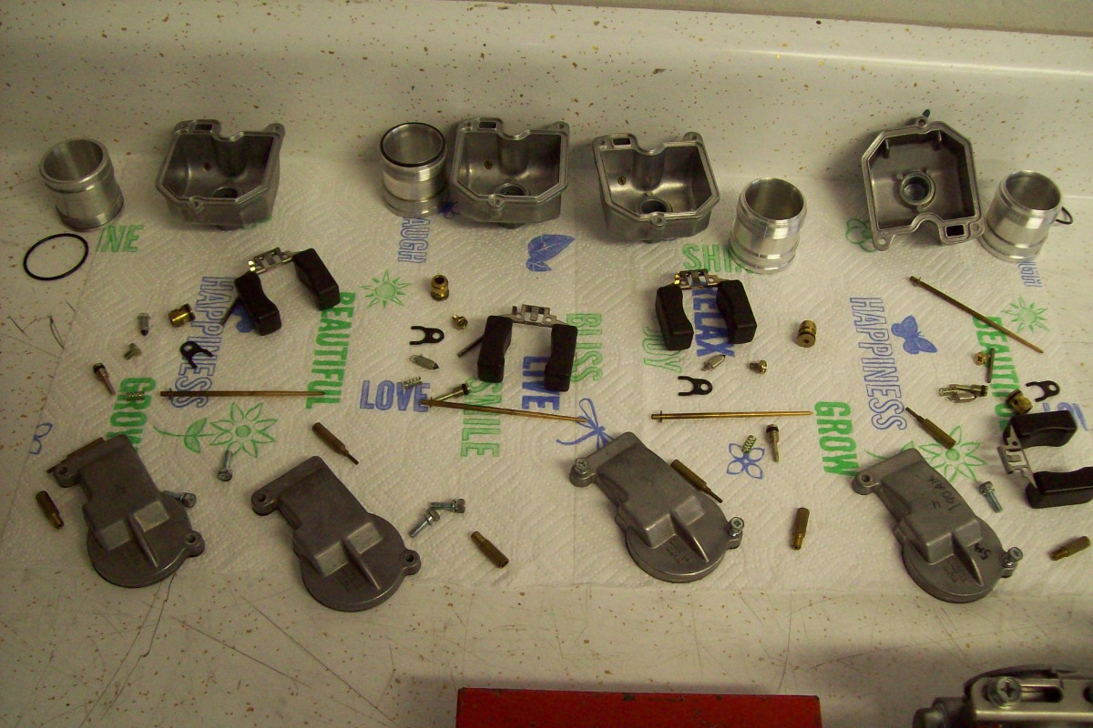

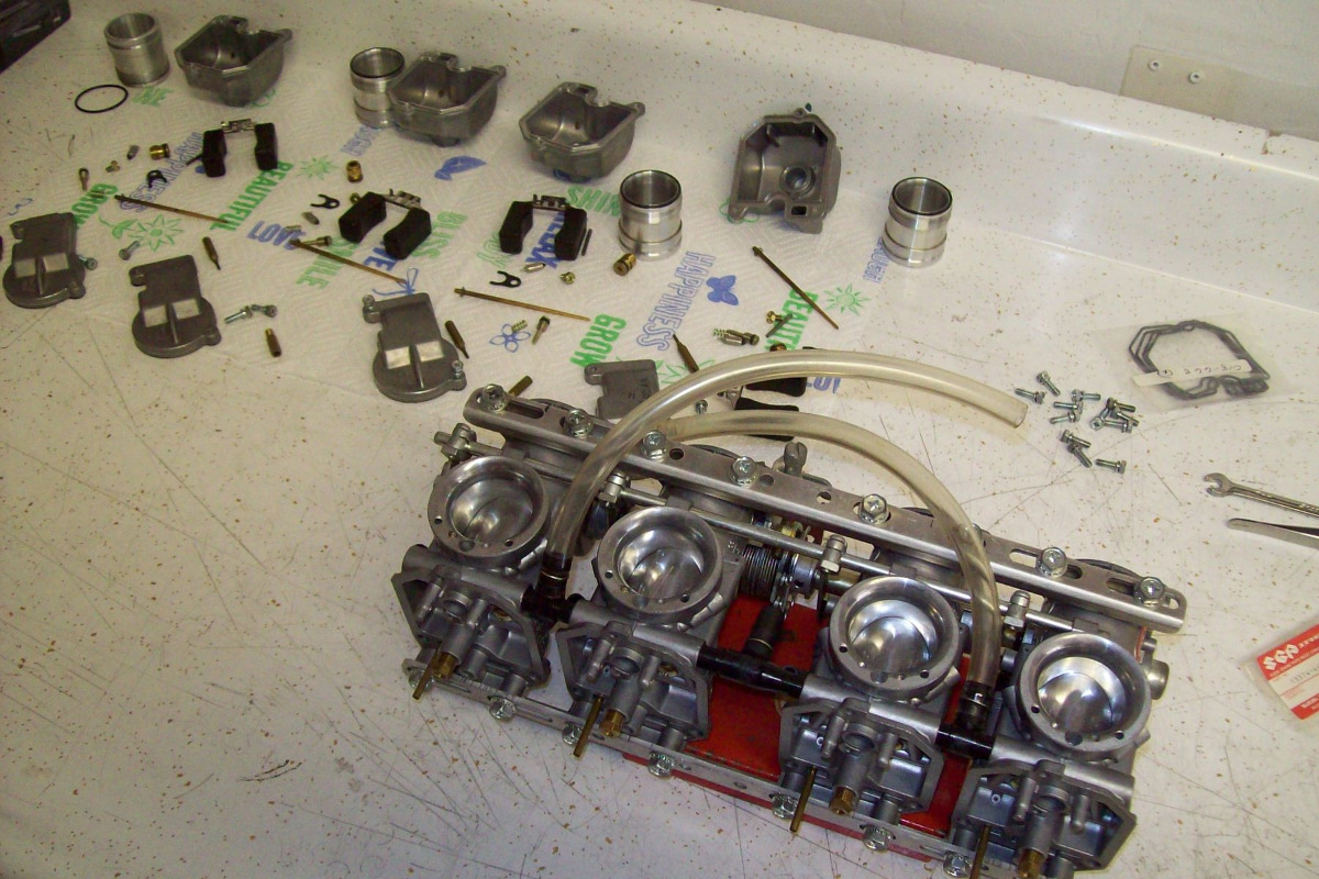

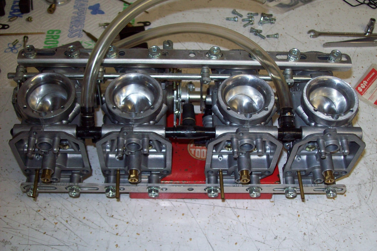

Still waiting on my cylinder head to arrive. So I am getting everything else ready for final assembly. The CR Keihins that I am using on this bike have sat in a box for 32 years, When I fired the bike up last year for the first time, I had some fuel leaking out of the inlet fuel tees. So I decided to replace every O-ring in these carbs. Glad I did!!!!! They were all flat, and mostly hard as rocks. I had all but one O-ring on hand. So I only had to order one O-ring. Plus I decided to lean the jetting out just like I had to for my Mikuni flatslides on my GSXR750. I had to drop 4 main jet sizes just to get a nice plug color. So I did the same on the CR's. Lean is mean.
I can't wait to start putting this motor back together. I kinda remember it sounds like it will rip your arm off!!!! YEA BABY!!!!

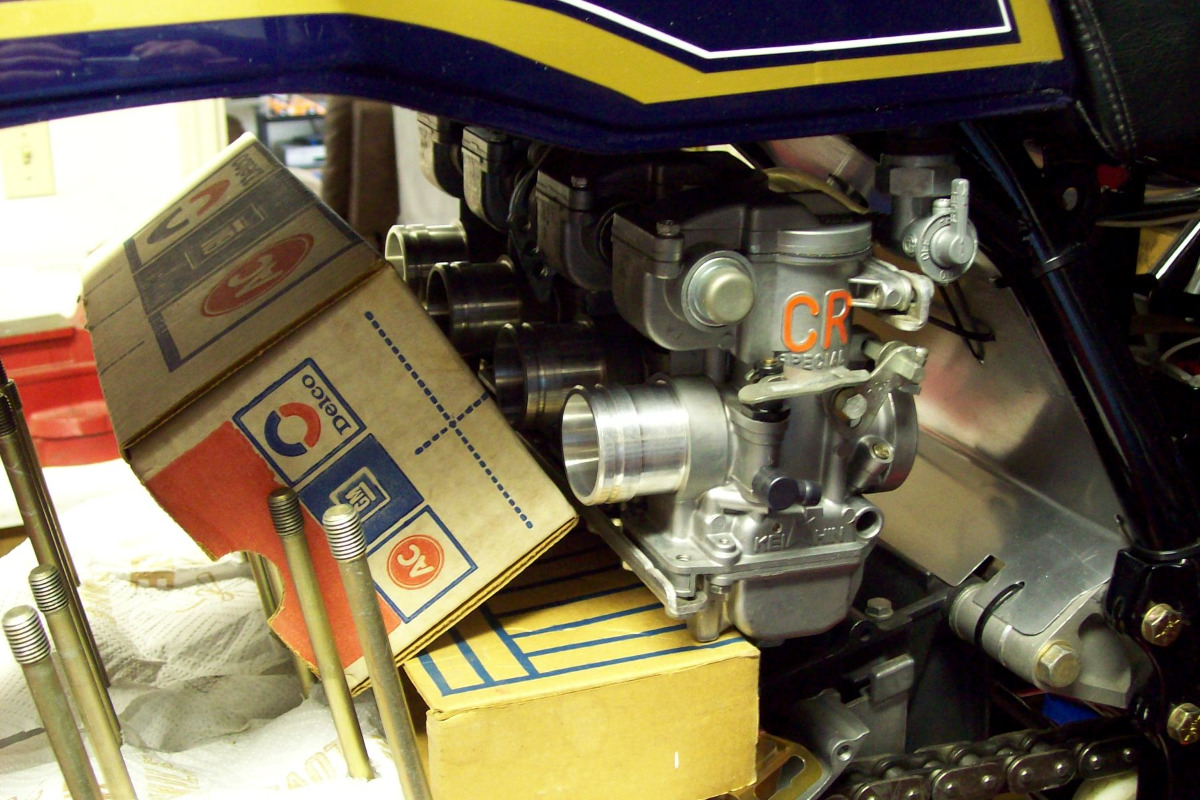

BENCH TEST!!!

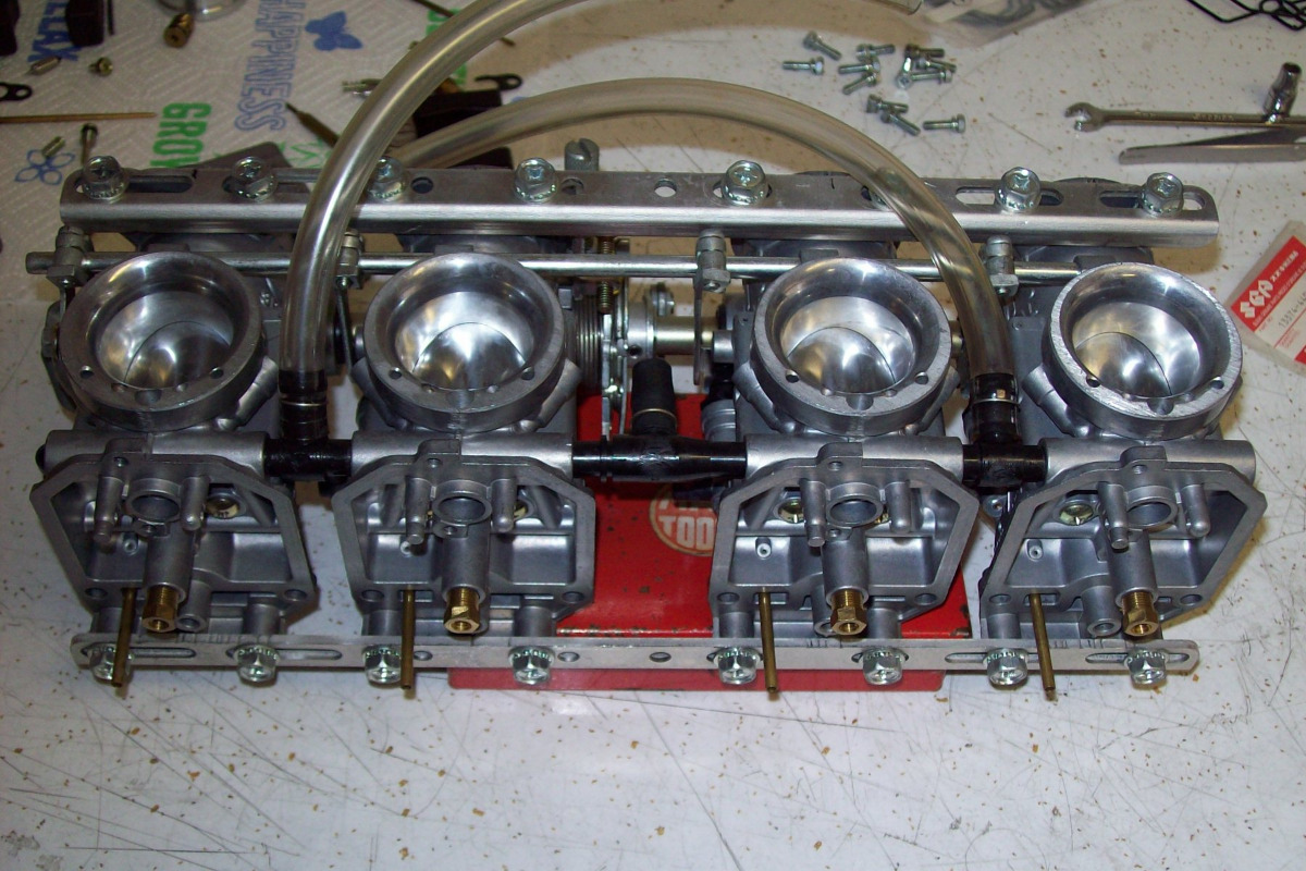

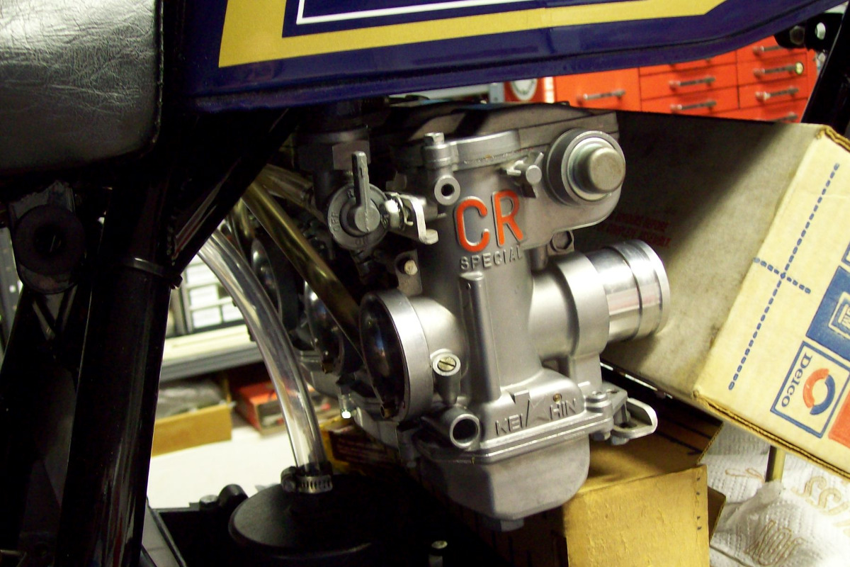

Can't find my test bottle, so I rigged up the freshly rebuilt CR's to my recently repainted fuel tank to see if anything leaks.
Well after 3 hours with both petcocks turned on, NO LEAKS, or any sign of fuel coming from anywhere!!!!
Now on to the pistons, and other things I have to do before I can assemble the top end.
I love it when a plan comes together!!!!!

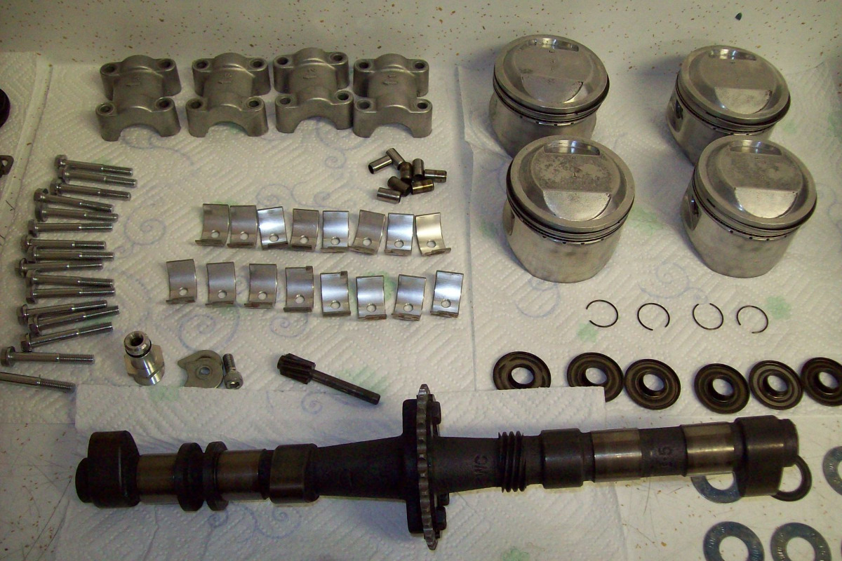

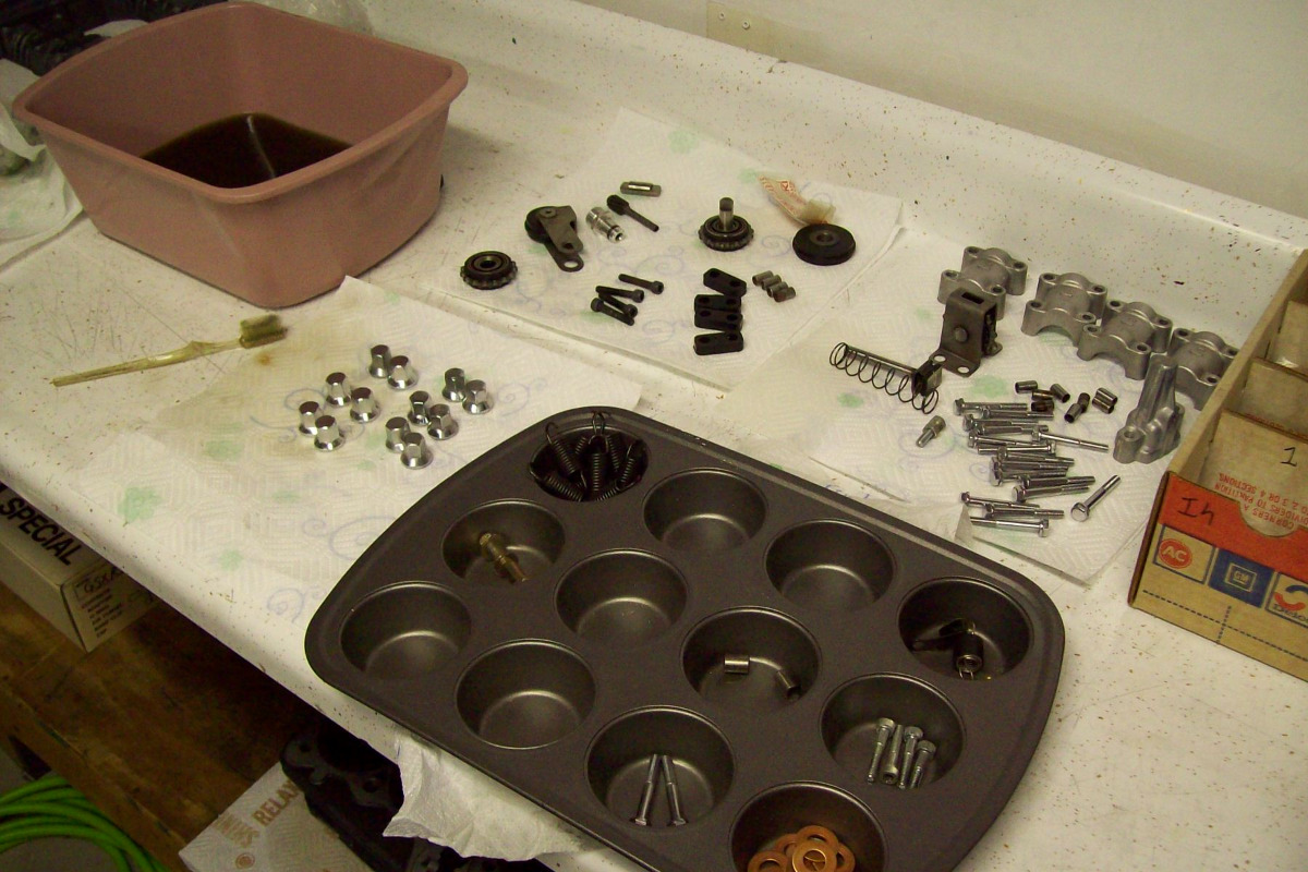

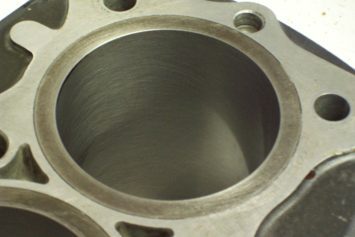

Got my butt in gear today!!! Getting ready for top end assembly. All the little parts have been washed in Safety Kleen, inspected, and ready for assemble. Waiting for OOPS (UPS) to drop off my cylinder head today. Then I can to start to put that together finally!!!

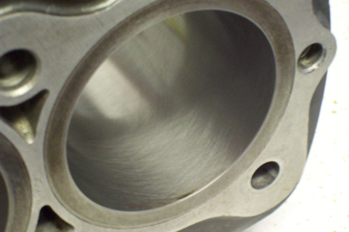

The cylinder has been freshly honed. Got a real nice cross-hatch pattern. Smokey would definitely approve of the way it came out. I forgot how messy honing really is!!! I got little drops of honing oil all over my nice clean bench, and surrounding areas.
Lunch time now for sure!!!
Might be burning gas by next week!!!!!

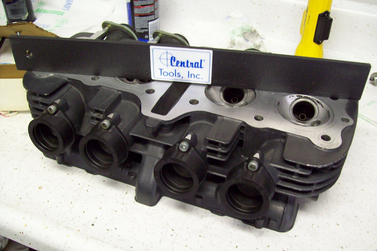

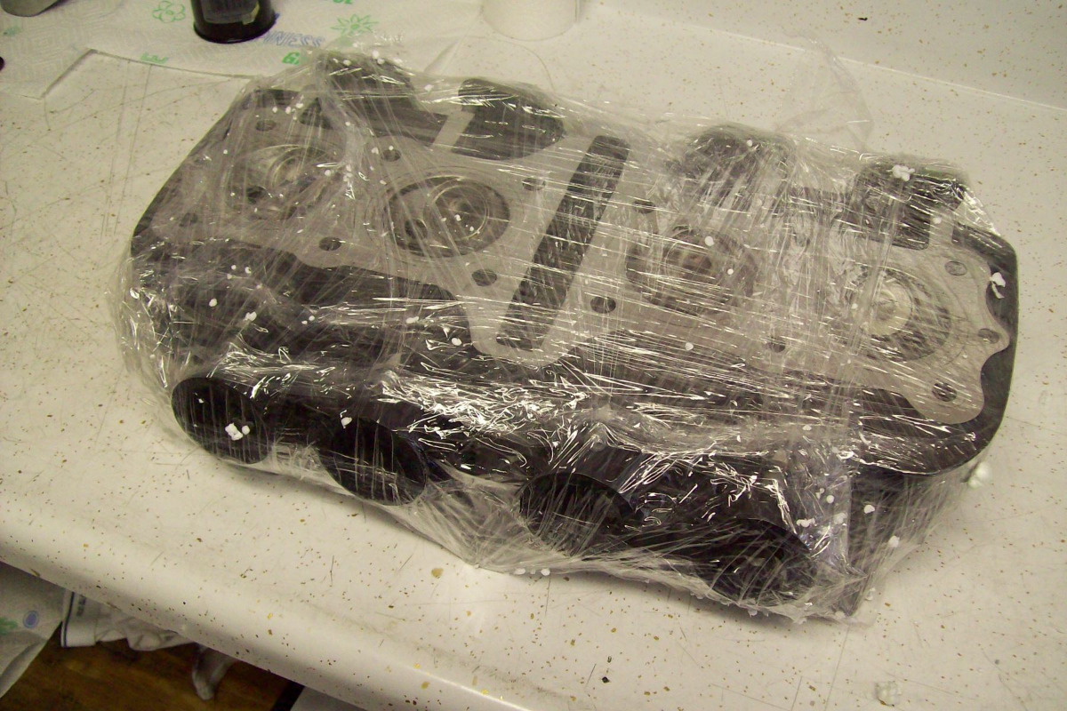

ITS FINALLY HERE!!!!!!!
Very well packed, and hermetically sealed. Final wash then assembly time. Going to take it nice and slow. I have waited 32 years so I got all the time in the world.

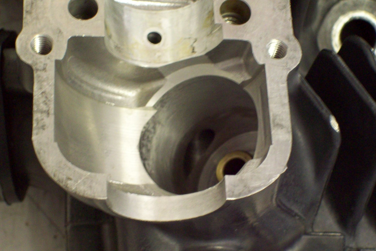

hermetically sealed!!!
Nice and flat ZERO warpage!!!!!
