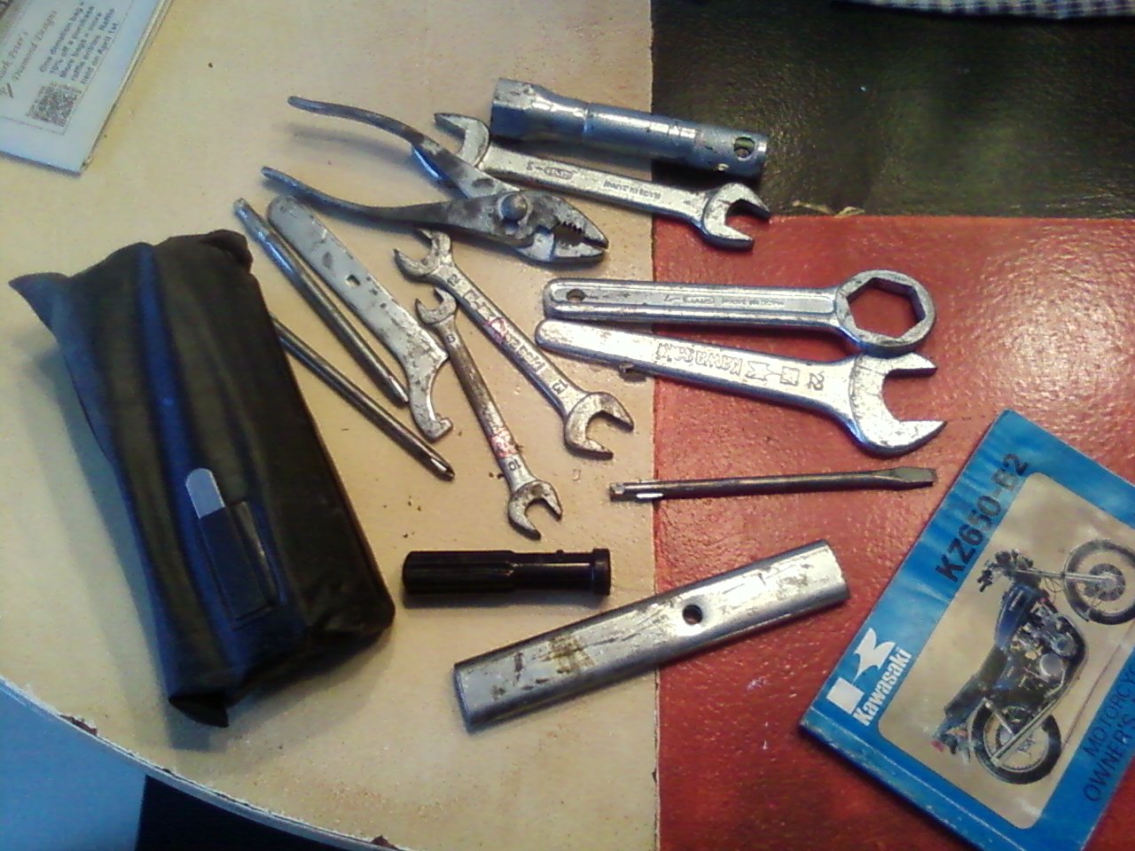

The bike is very dirty and it looks like very little maintenance has been performed on her although it has a good battery ,new air filter, front tire and it looks like the fork seals have been replaced based on the new looking dust covers.
None of the screw heads are stripped and the tool pouch has all the candy including the feeler gauge and looked like it was never removed, most of the wrenches still have their inspection stickers on them B)

The tool kit B)

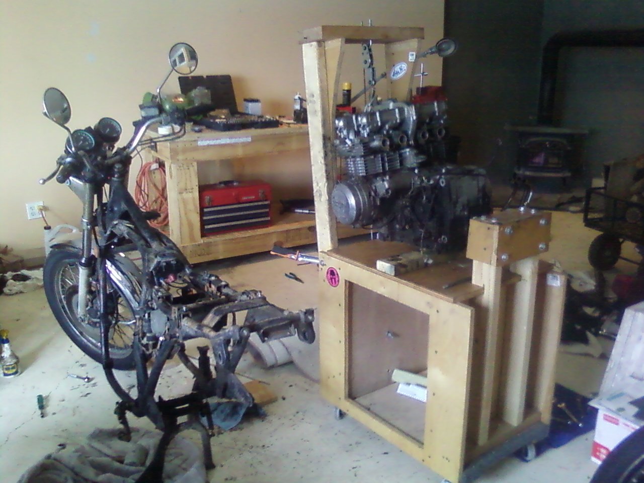

My son came over this weekend and we got busy tearing her down .
He really got into it and I was enjoying explaining everything as we went along.
We ran out of time before we could get to the front forks but the engine is out and sprayed down with WD-40 and will keep until he can get back, he's doing the scrubbing on that filthy pig.
In the mean time I'll get started on the carbs.
The 650 engine should be a lot easier to clean than my 1000, it seems like they eliminated a lot of the tight, hard to get spots plus most of the grime is melting away .
I don't think that this bike was ever kept out side like mine was.

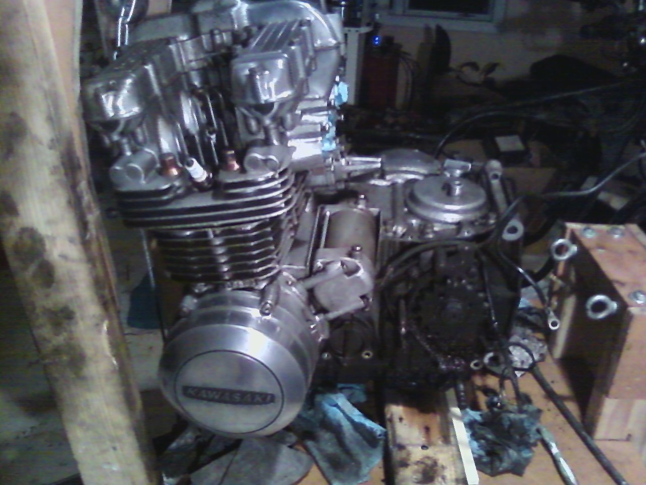

Cleaned and polished the engine a bit,mostly the easy stuff just to show him what it will look like after all the hard work he will be putting into her.
especially around that sprocket area :sick:
