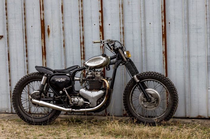

a scrambler would be cool :evil: .
doesn't kenda make a dual sport tire?
here is some inspiration,
