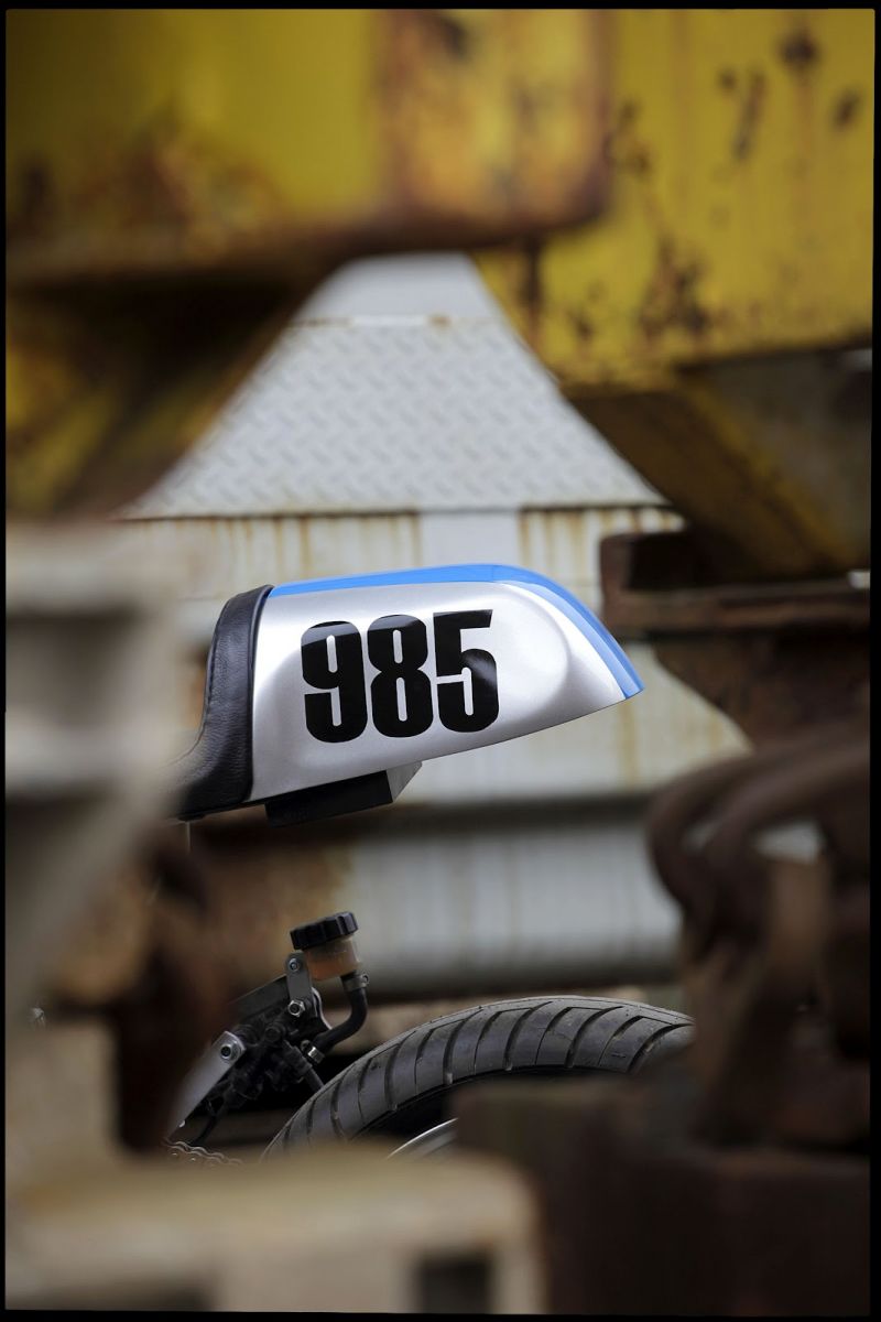

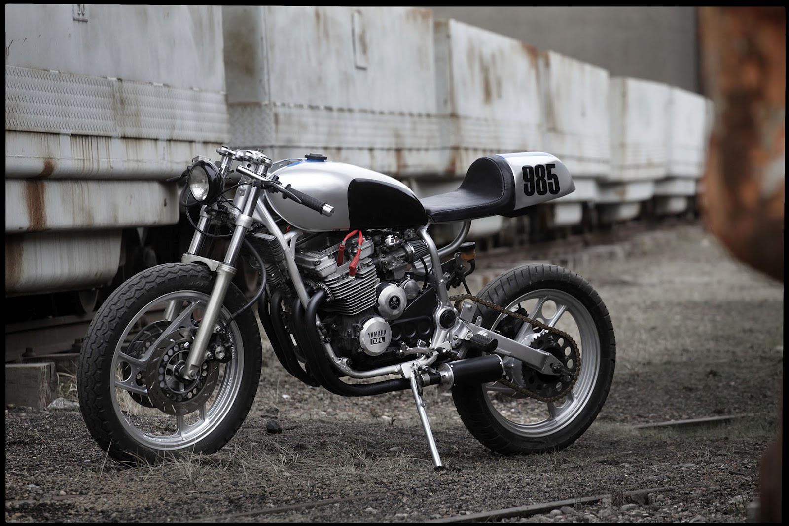

maybe with a minimalist rear sub-frame and the vintage ducati tail.
something like this perhaps, :whistle:

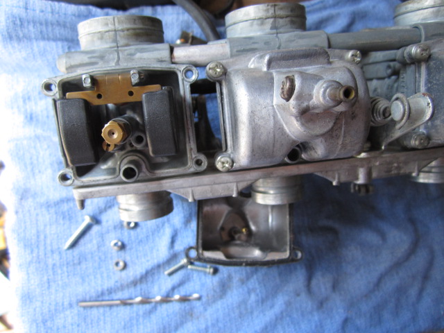

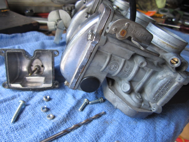

12 Sep 2012 23:06 - 12 Sep 2012 23:08I loves me some virgins :evil:
carbs, that is. Everything just as it left the factory, no stripped screw heads, everything is as it is supposed to be. Drilled the plugs out and cleane dthe air screws and idle circuits.
Teeny tiny jets in this thing :laugh: , should be good for 50MPG. :woohoo:
WOW! Leon, you have vision man!!!
