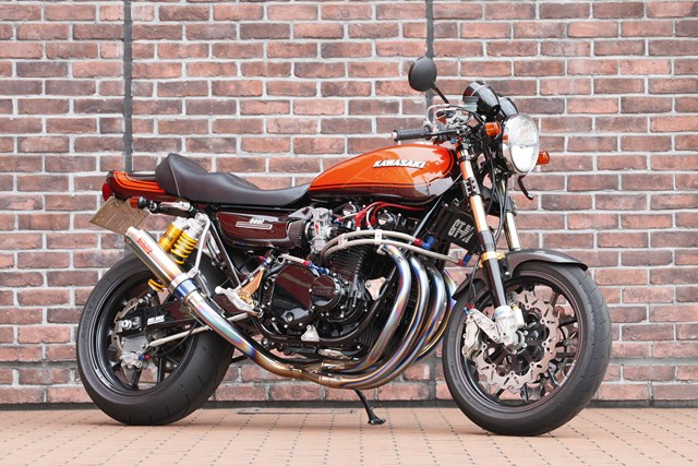

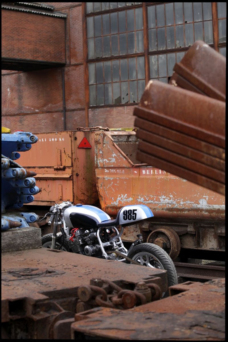

something like this perhaps, :whistle:

WOW! Leon, you have vision man!!! Killer ride. Let me show that to my son, you reckon he'll change his mind about the "old LTD" :laugh:531blackbanshee wrote: maybe with a minimalist rear sub-frame and the vintage ducati tail.

he's prolly got enough of ol' dad's sense of cool to be able to see his way through :lol: !
