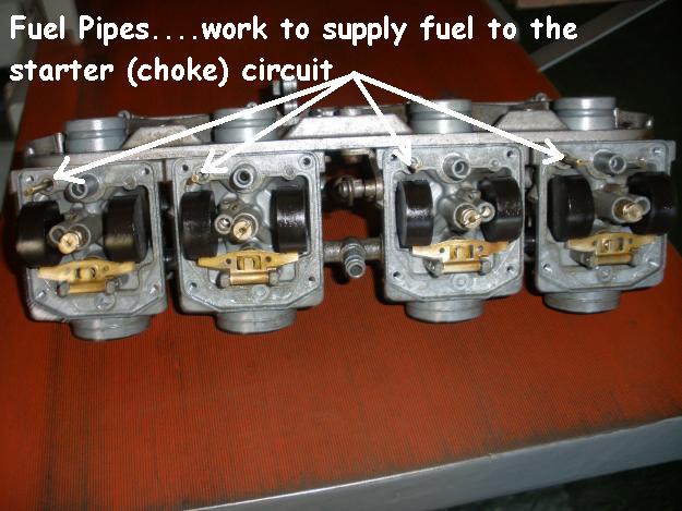

Does anybody know if the fuel pipes are available for the carbs? The Kaw parts diagrams don't show them but they pull right out of the carb bodies....you'd think they'd be available somewhere. Mine are a little beat up from pulling them to clean them and I'd like to replace them if possible....just can't find them....not even a part number. These are different carbs, but here's a picture of what they look like:

Finally got to try the carbs last night....they're fixed! It was the fuel pipe inlets in the float bowls....the choke circuit works great now. :woohoo:
