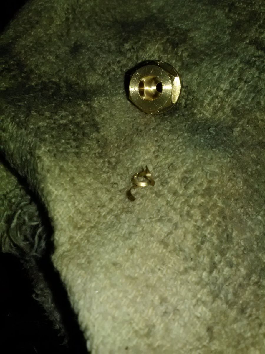

I learned two lessons the hard way, both relating to the carbs. I haven't been happy with how the bike runs when it's first started....really, really "cold blooded". I decided to check the service fuel level using the clear tube method. The float levels were all off...all were much too high. 1st lesson....Never count on setting the float height by measuring the floats, always measure the actual fuel level. I had them all set perfectly to 26mm and the actual fuel levels were all way off.
While I was setting the levels, I could not get the #2 carb to stop filling...it would slowly trickle until it got way too high no matter how much I bent the tab. I finally pulled the BRAND NEW needle and seat out for an inspection and planned on polishing them up a bit. I found a huge metal chip in the seat! 2nd lesson....Never assume that new parts are good just because they are new. They all need checked and/or cleaned before installation. I've read this before but didn't bother to check them when I put them in. Lesson learned. :blush:
The float levels are all great now so hopefully it will solve the cold start issue. For the record, the service fuel level for the '79 and '80 MKII (28mm pumpers) is a little different than most...it's 3mm - 5mm. The LTD models might be the same, not sure. This is according to the factory service manual, in the supplements for the 1979 A model and the 1980 A model.
Here's what I found in the needle and seat!

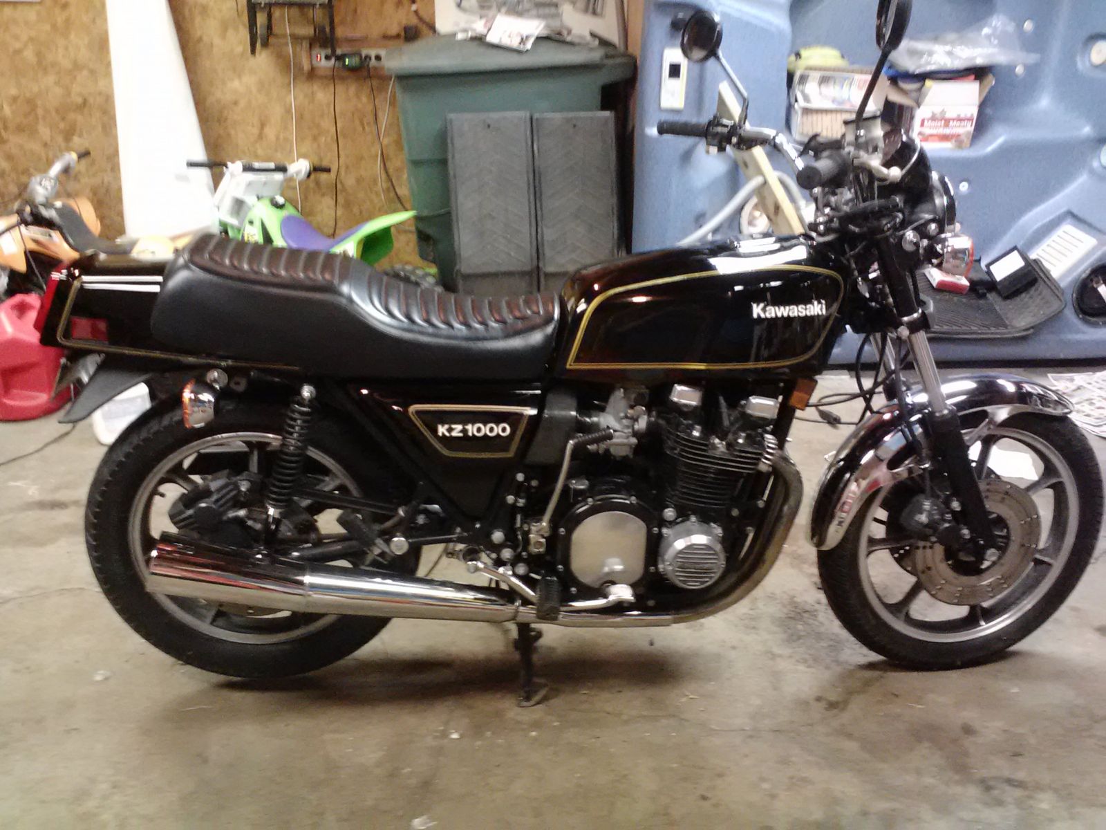

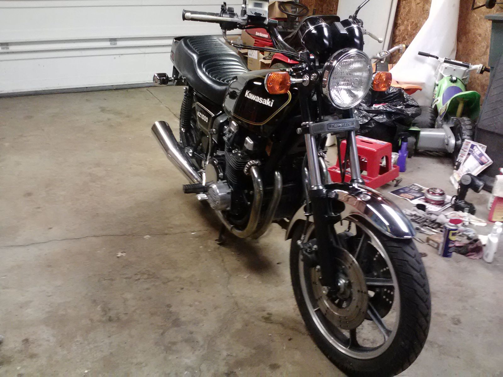

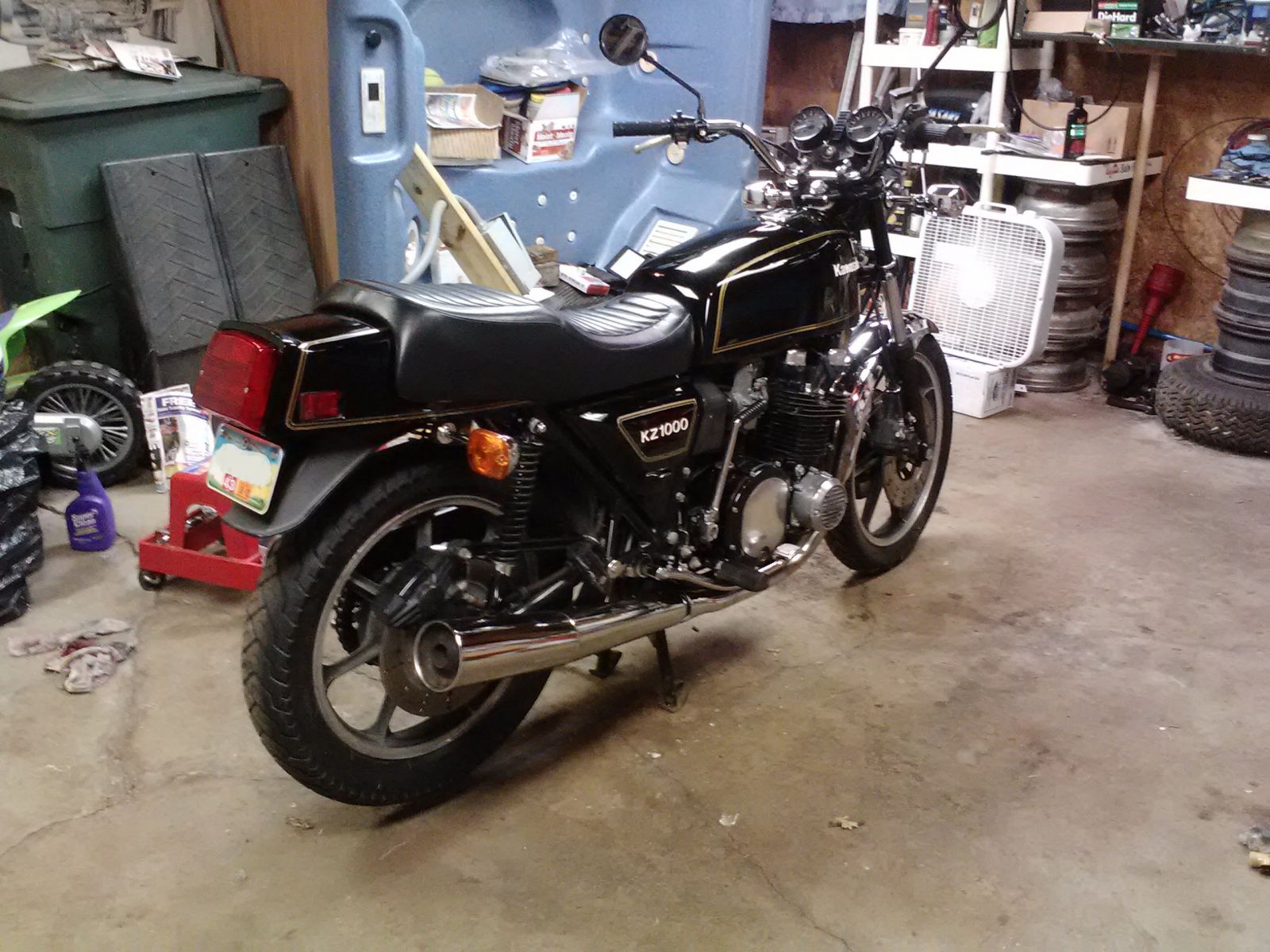

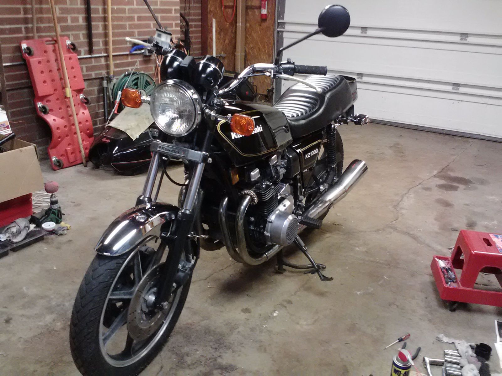

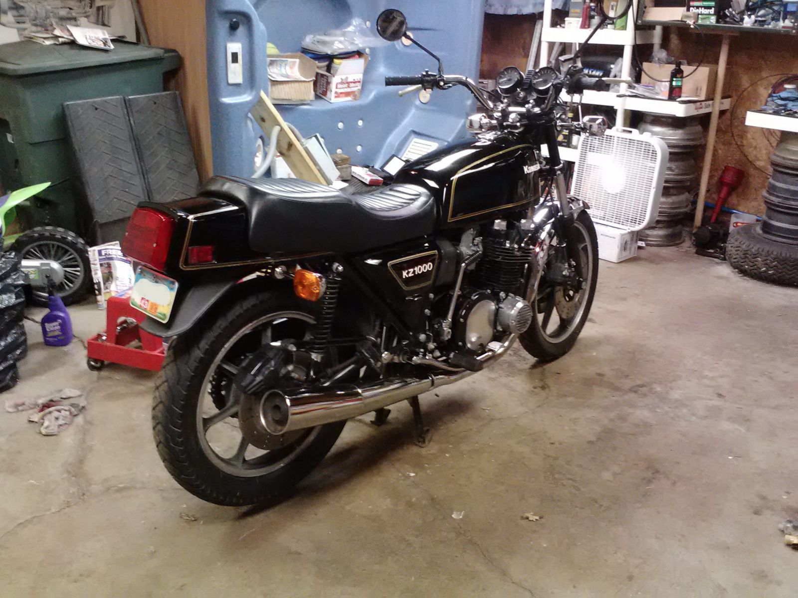

I bought the Meguires "Ulitmate Compound" at Auto Zone and thought I'd give it a try. That stuff is AWESOME! It took old gas stains and oxidation and all that stuff off the paint...what a great product. :woohoo:
I've got it pretty well cleaned up now...here are a few pics:

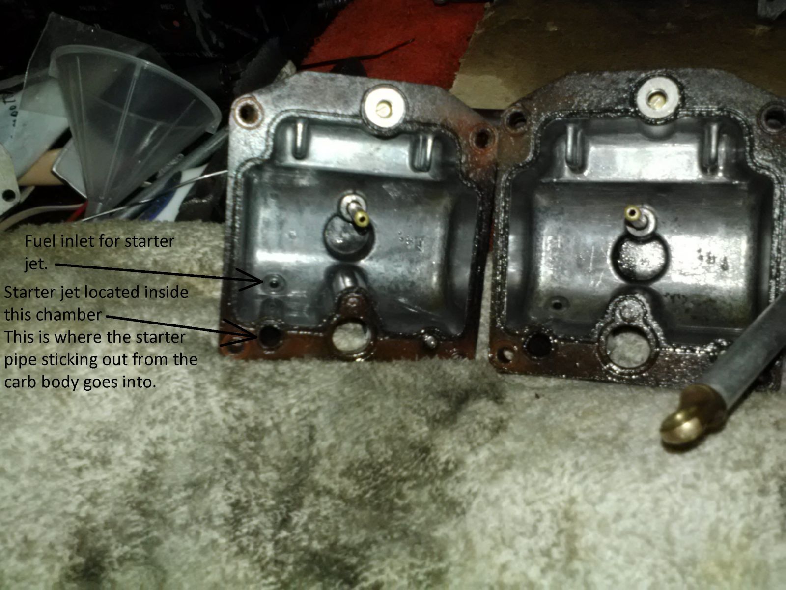

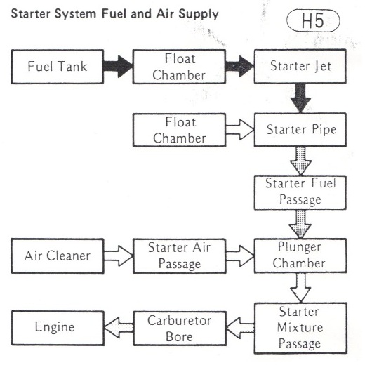

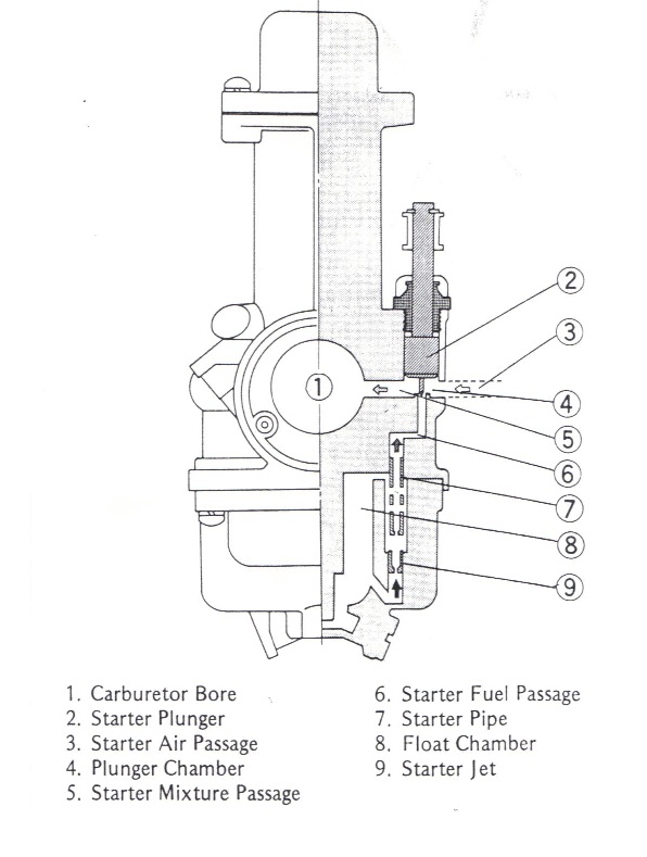

I just looked over everything again and a light bulb went off. I didn't check the starter jet in the float bowl! I checked the whole starter circuit in the carb bodies but not the part in the float bowl... :blush: ...sure enough, all 4 were plugged up solid!
I was able to clear 2 of them but 2 are still plugged. I have tried carb cleaner, wires, and 100+ psi of air pressure with no luck so far. I'll let the carb cleaner soak for a while and if that doesn't work....I'll use the ultrasonic cleaner at work tomorrow. Hopefully that will clear these things up.
I'm sure that's the problem....those work with the starter circuit (choke) to supply fuel. No fuel, no run!! These are hard-learned lessons that I won't forget!
Thanks again Patton and 650ed!!
For reference, here's a pic of the inlet and the starter jet location on the float bowls:
