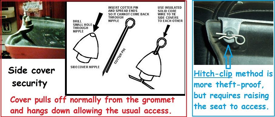

Bah! This thing is literally falling apart under me. I took it on a 30 mile trip on the freeway and the left passenger peg and right side cover fell off at some point.
Go green, buy a Kawasaki!
82 KZ750M CSR Build Thread
89 ZX600C Streetfighter
  • Patton
  • Patton's Avatar
  • KZr Legend
  • KZr Legend
  • Posts: 18564
  • Thanks: 2103
Re: What direction should I go with my new KZ?
11 Apr 2012 17:37 - 11 Apr 2012 17:38
#515279
When replacing the side cover, would fit new grommets,
and
Good Fortune! :)
Last edit: 11 Apr 2012 17:38 by Patton.
