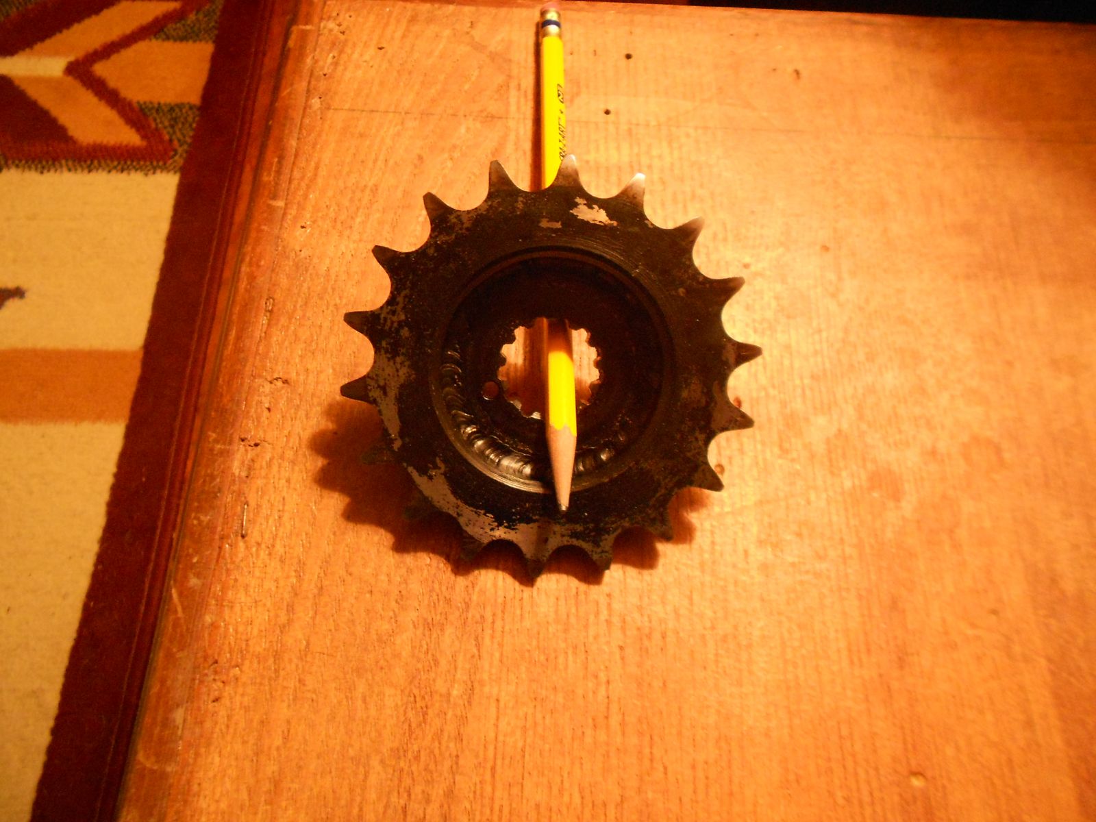

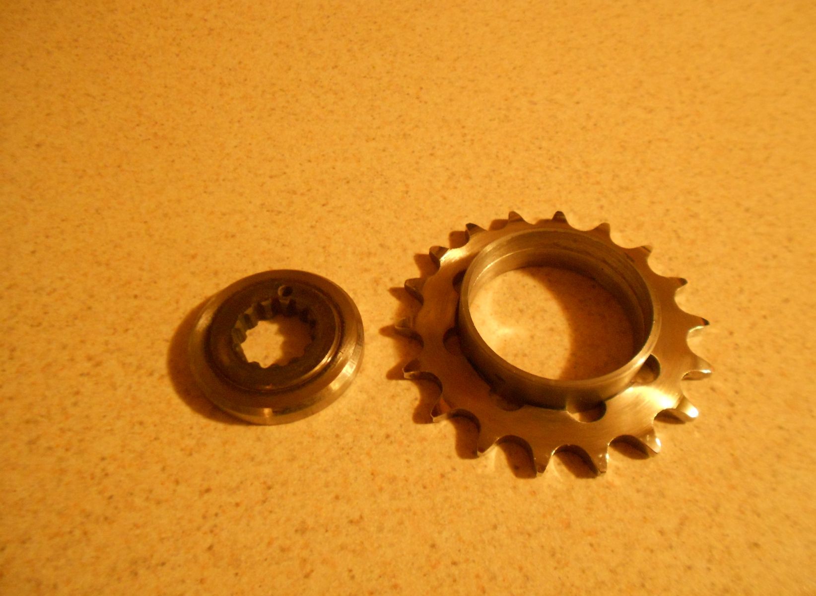

i use a 520 chain and have for several thousand miles.
both non-oring and o-ring,i wouldn't hesitate to run a 520.
i fabbed up ramtoughs offset countershaft sprocket from his old one and a new one.
before welding,
after welding,
before welding,
after welding,
