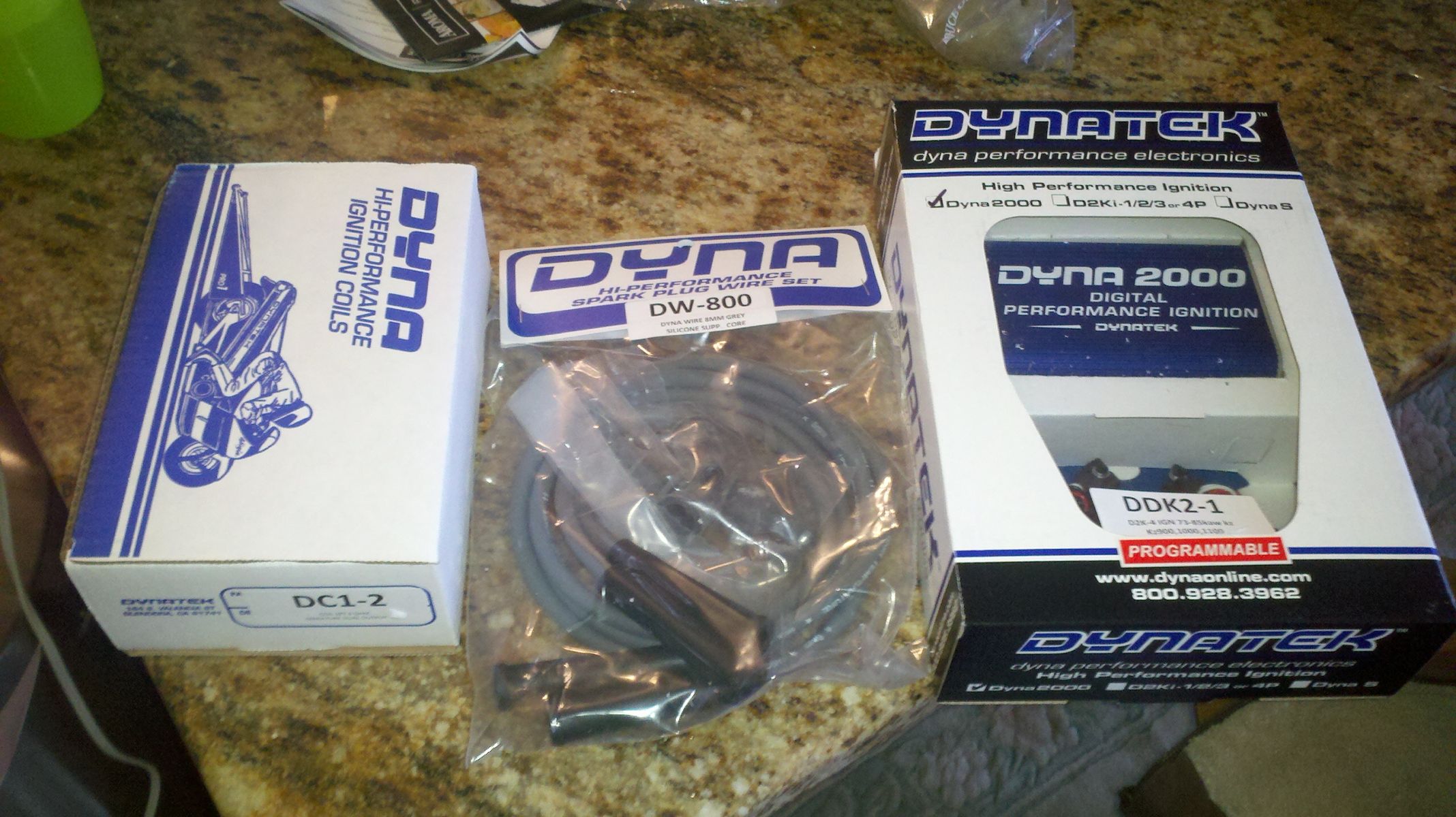

This is my new project, a 1981 KZ1000j dolled up like an ELR. The engine is all there minus the electrical, which gives me free reign in the parts acquisition department. I ordered a Dynatek 2000 ignition system, a Kerker 4 into 1 from Dennis Kirk, a set of K&N air filters, APE valve cover plates, a set of carbs from ebay that I'll rebuild and rejet, and all the missing parts for the front brakes that are missing, including a set of stainless steel brake hoses.

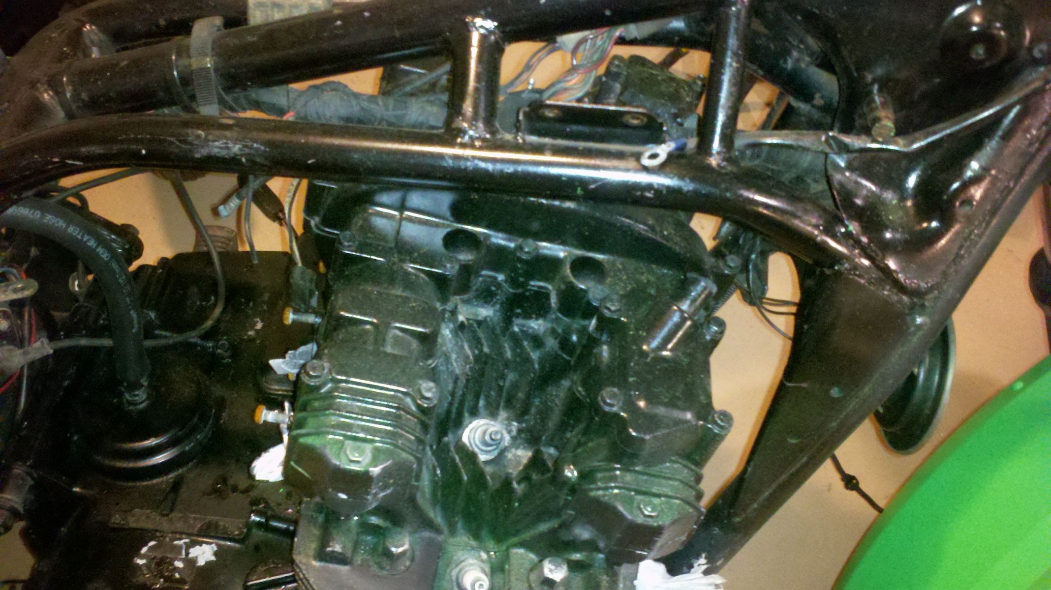

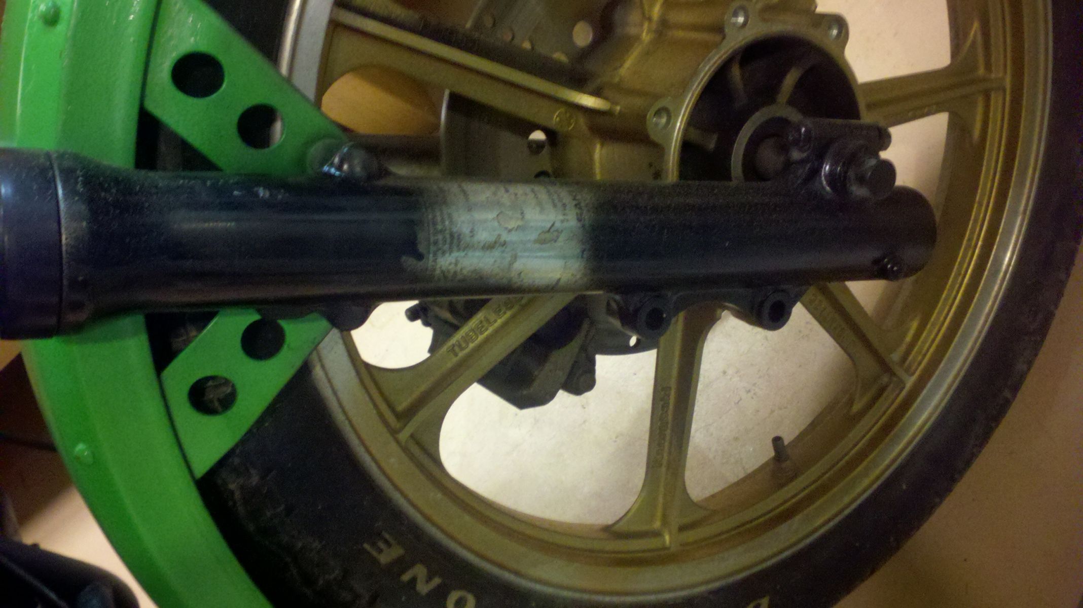

The front forks, Leading Axle, and the Instruments/ Triple Clamps, are LTD. Any Chrome under the black paint? At the Valve cover or Stator cover? When you pull the valve cover off, check the cams for how many grooves are cut into the un-machined boss near the #3-#4 lobes. If there is two grooves, those are the standard cams shared by the LTD, CSR, Police, etc. Not the "J". Look in the Manual in my signature, it will explain it all for you.
Looks like someone took off the second brake rotor, and caliper from the RF.
What Carb's did you get with it, BS-34's?
Look at the Identification Tag on the Steering Head, and look at the serial # and the Model #, K is the LTD.

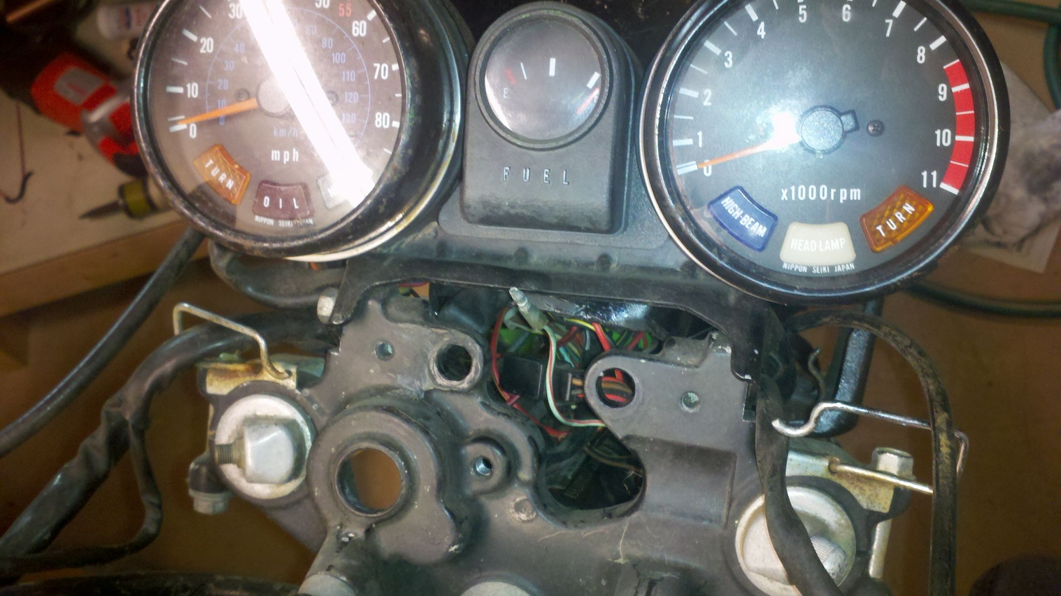

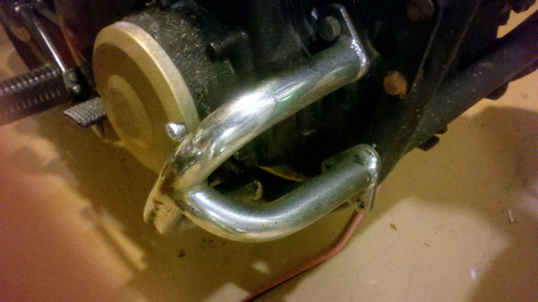

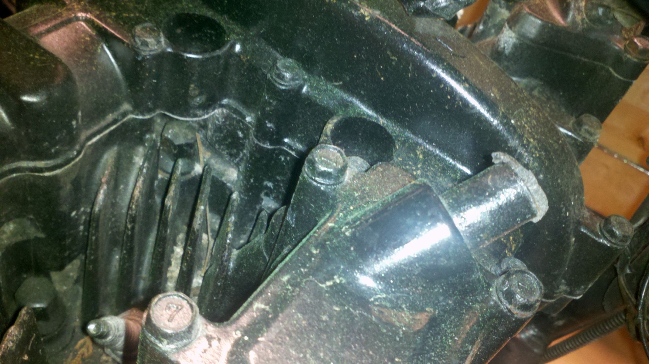

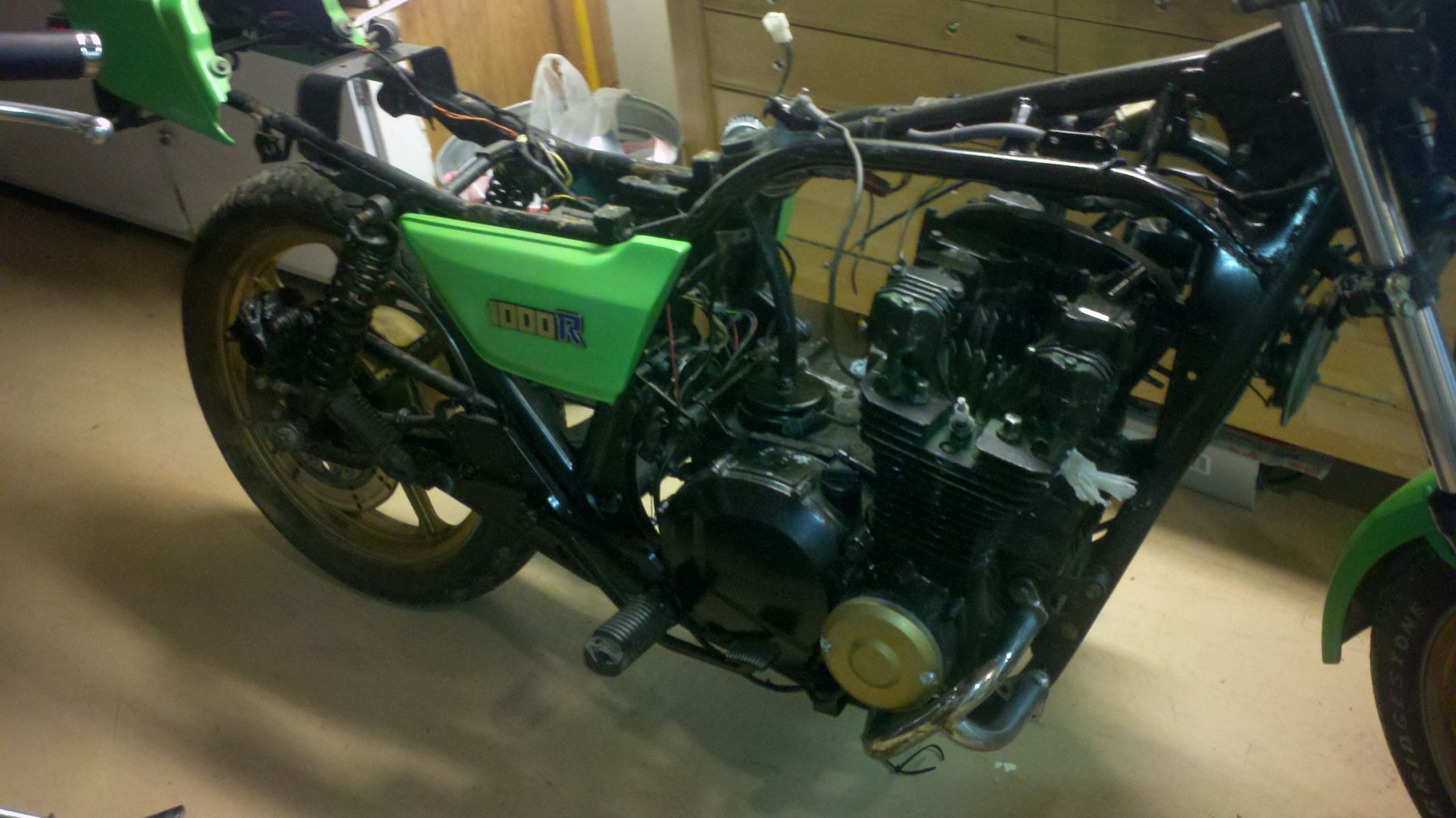

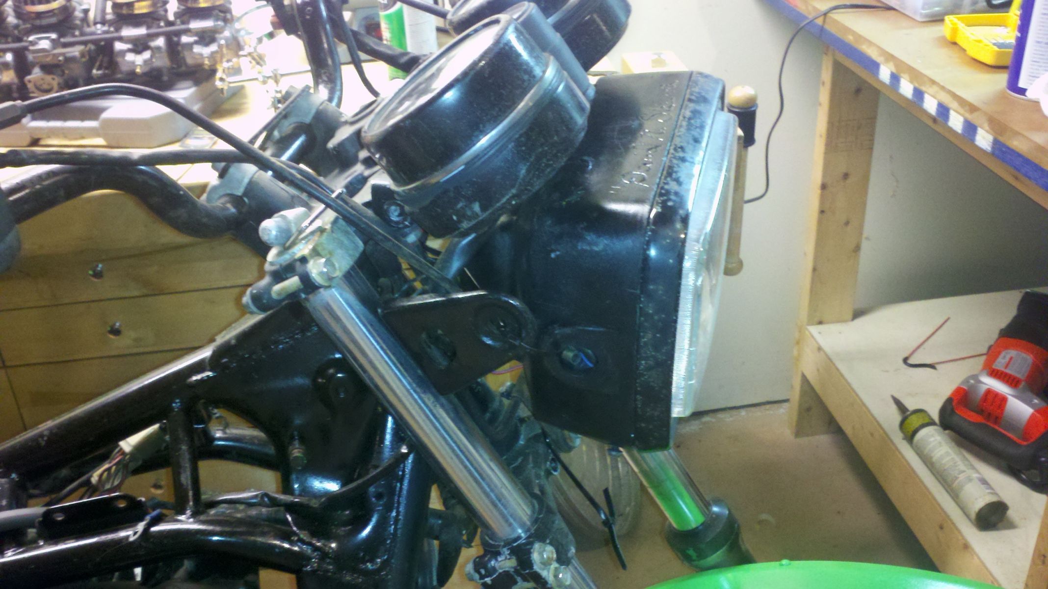

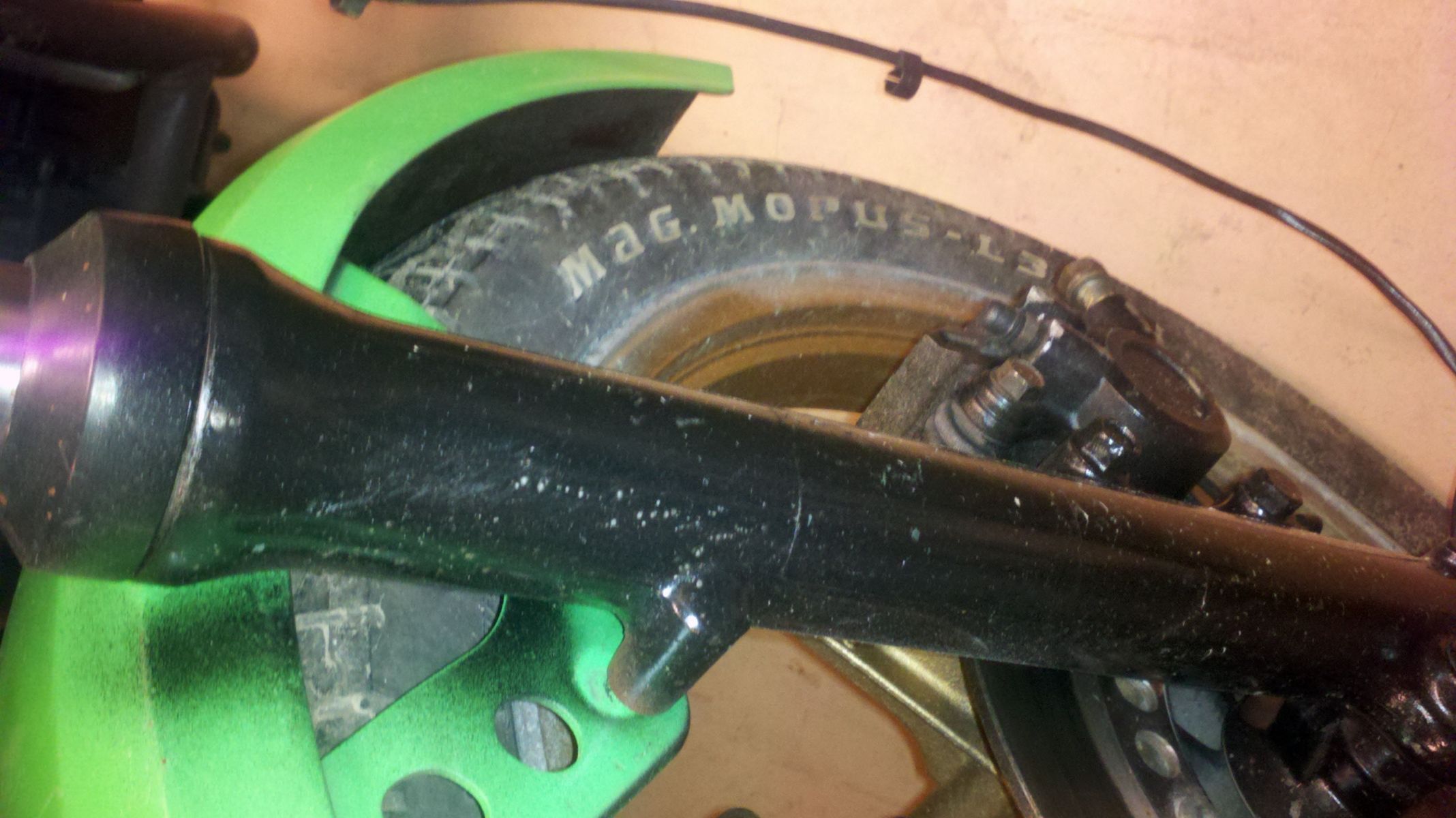

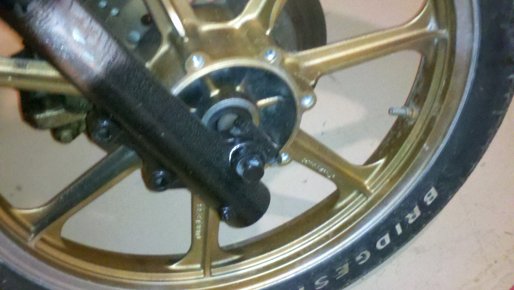

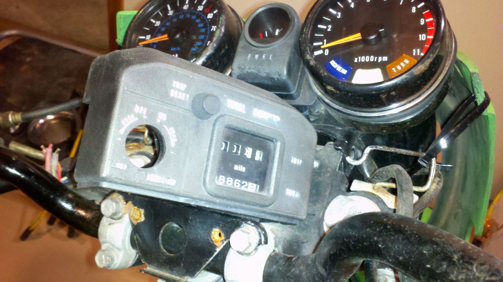

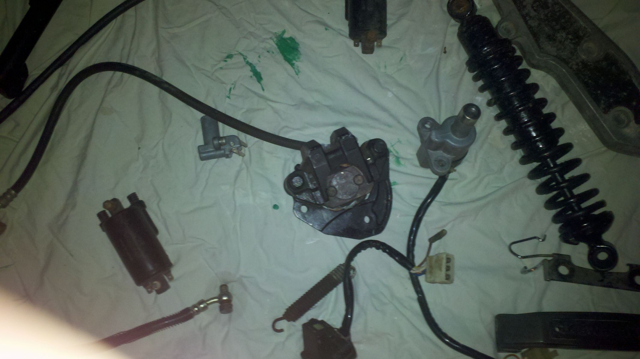

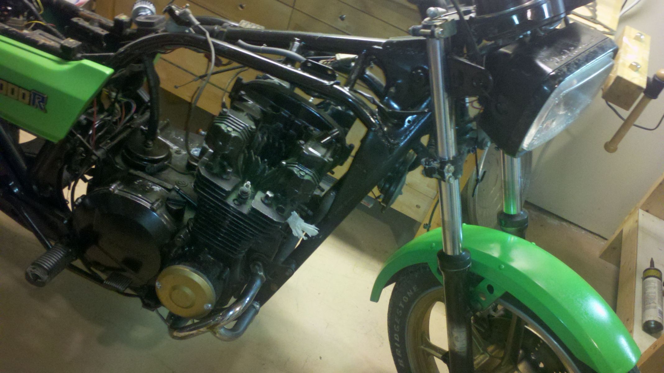

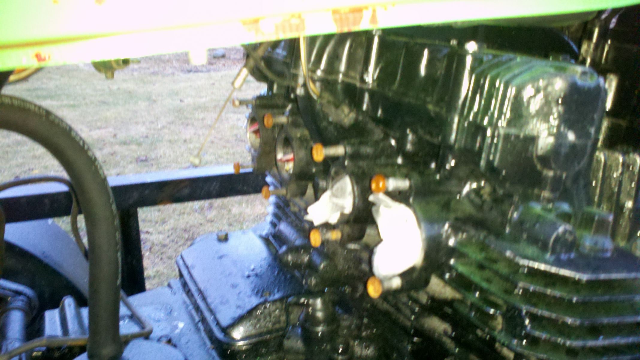

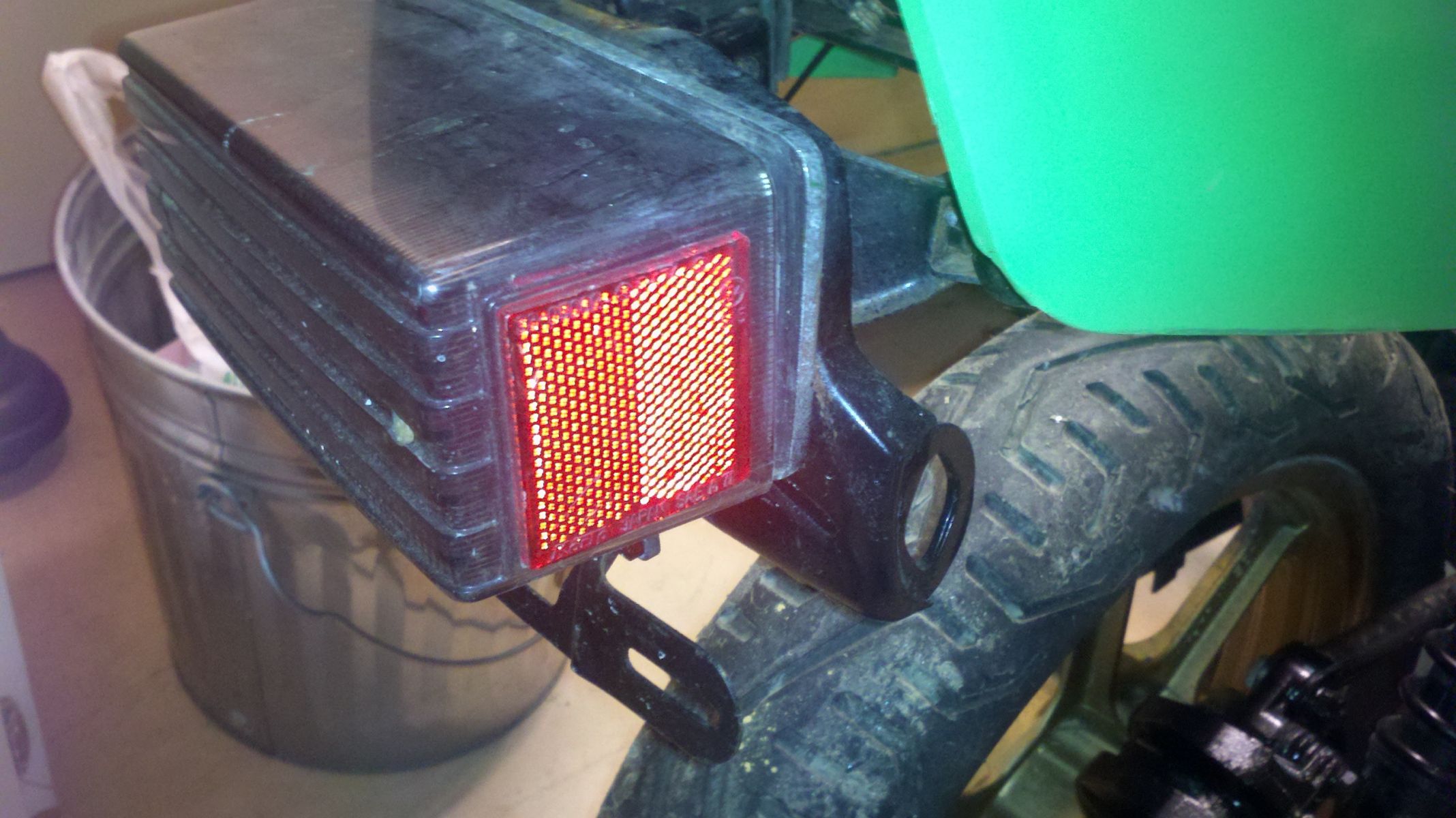

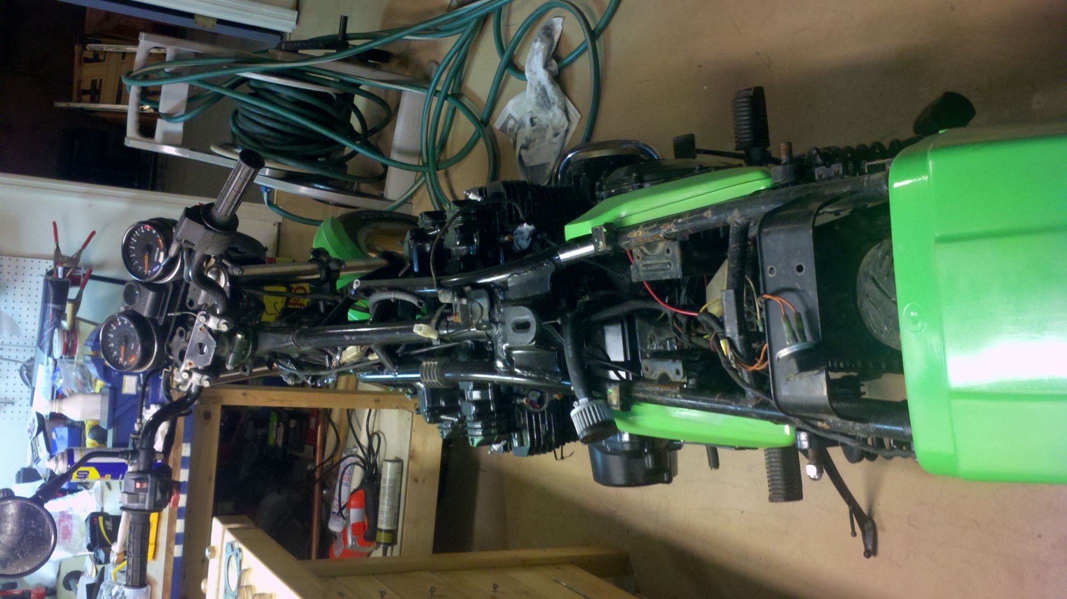

So as I wait for the parts to arrive, I've been on a photo kick.
Parts
Annoying spot on front end... :angry:
Gauges and whatnot
OVERSPRAY. There is no smiley to express my disdain for overspray.
I love this shape.
Big Ol' Taillight.
Frame in need of a good cleaning.
My Favorite pic so far.

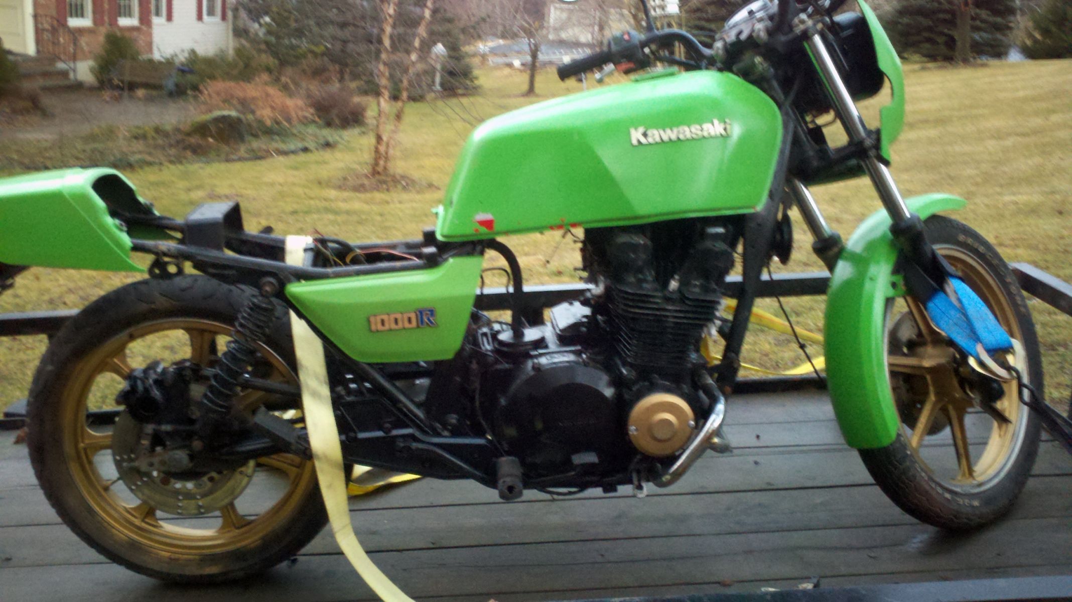

Half put together headlight.
Mag Mopus? Bridgestones
The frame is neat.

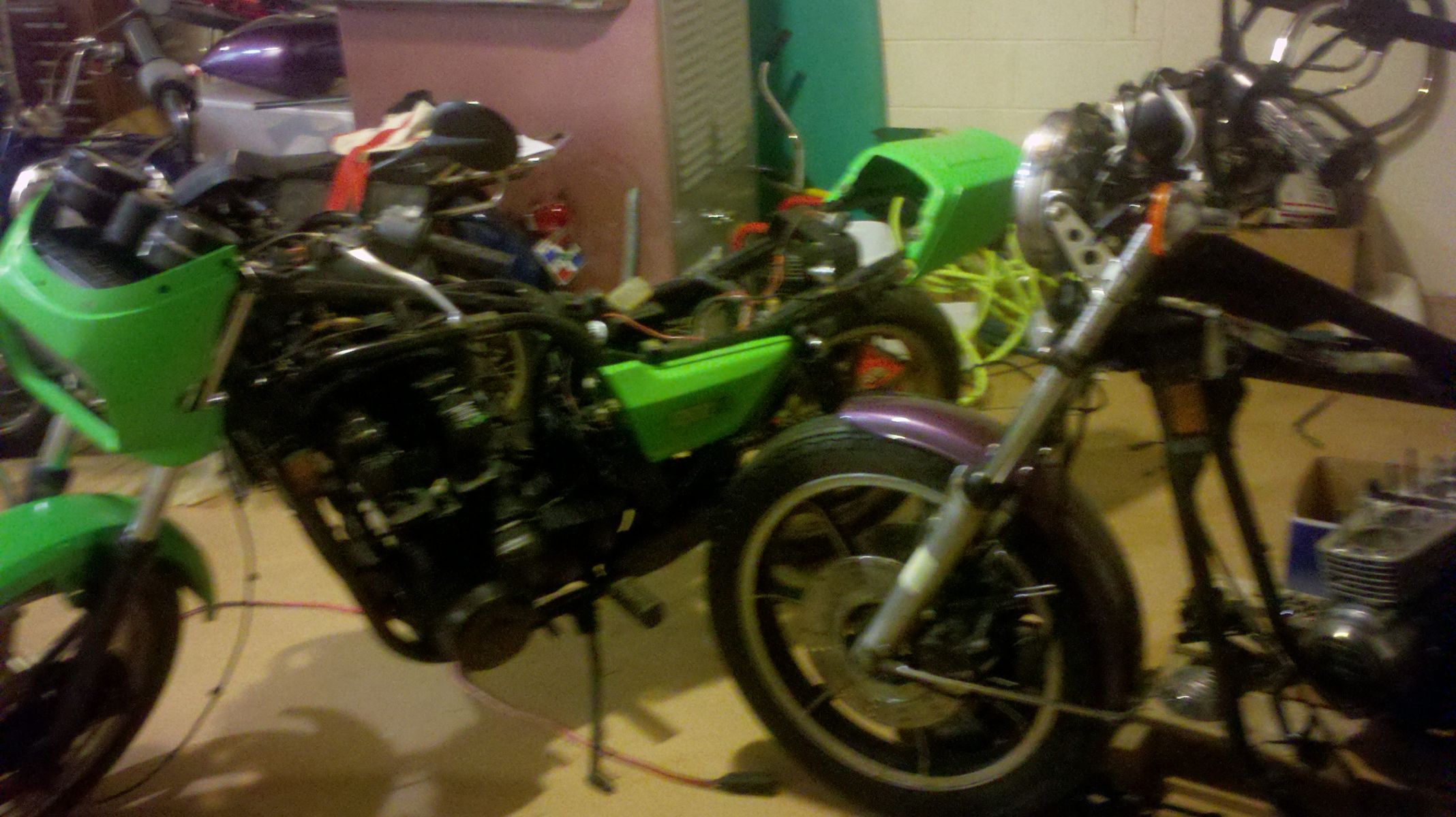

My other bike is displeased.
"Are you KIDDING me? Another one?"
Sorry for the fuzzy pic.
