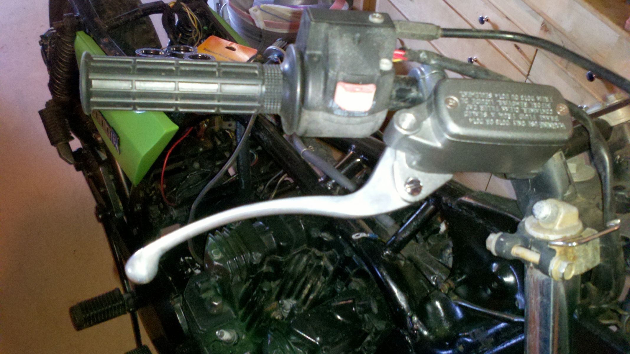

So, I got a brand new master cylinder for the front brakes.
Looks nice, but I might paint it to match the handlebars.

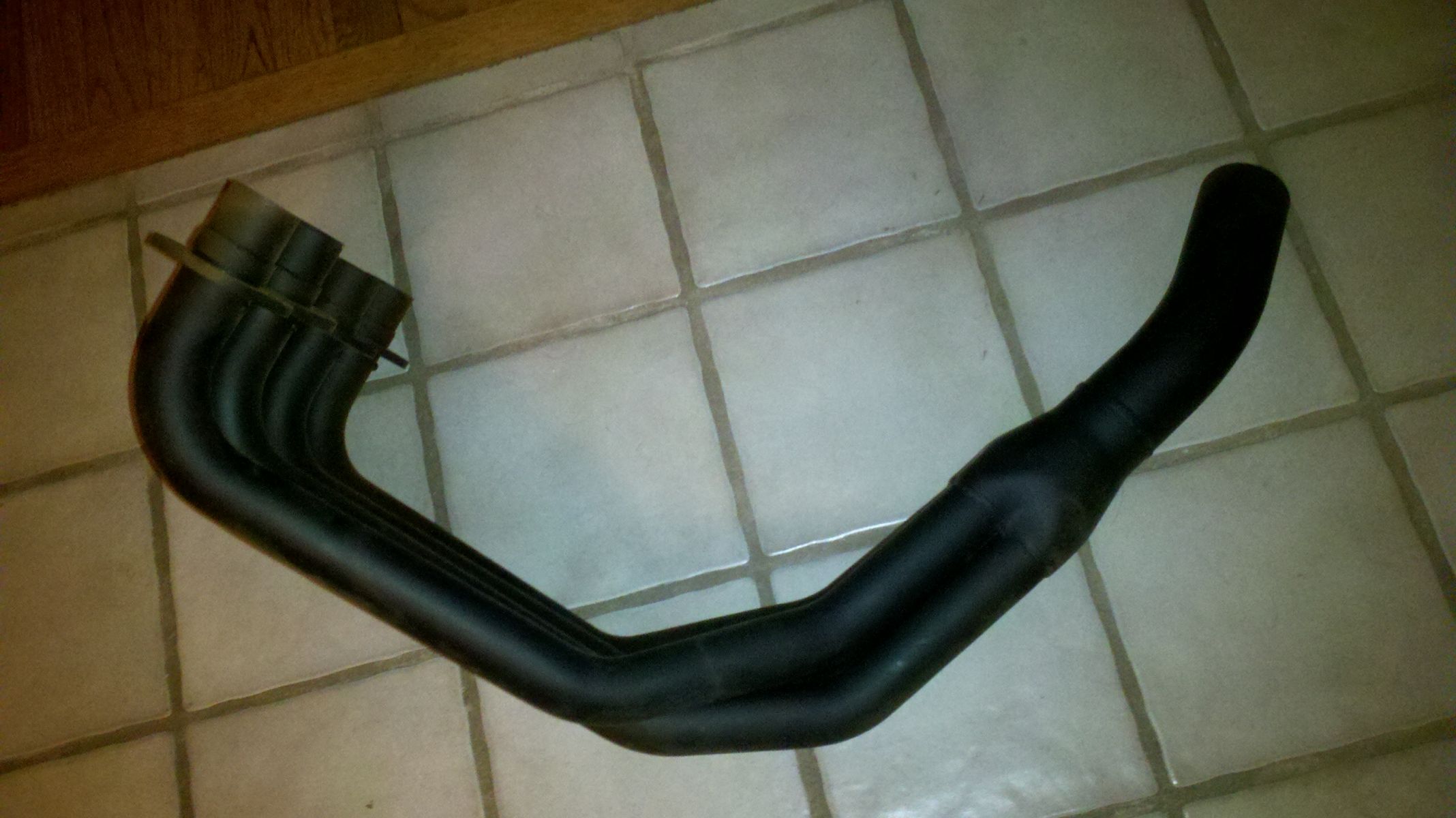

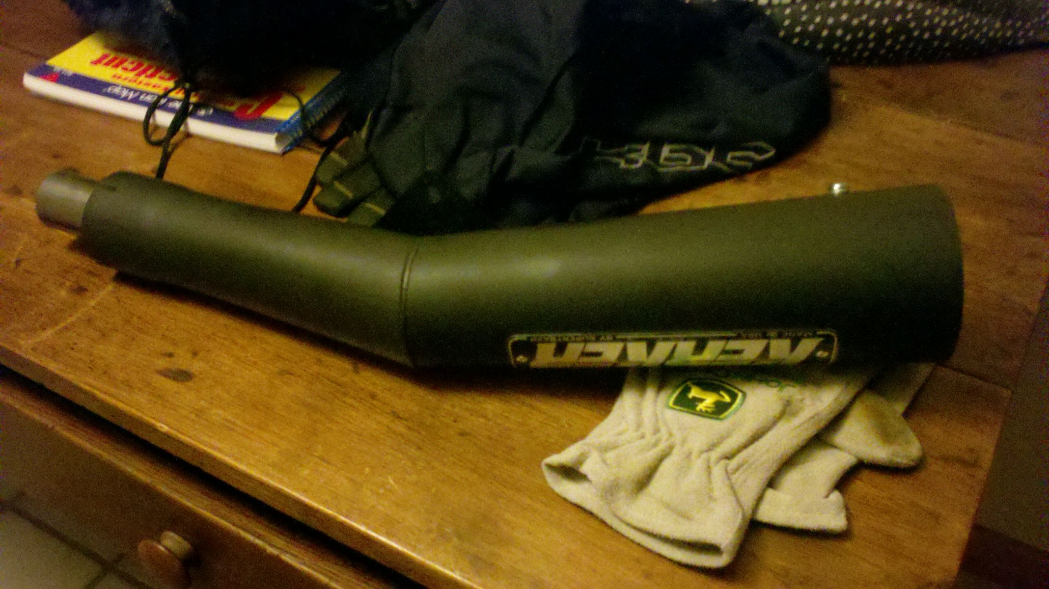

Also, my Kerker exhaust came from Dennis Kirk. A little dusty, but she's a beauty.
