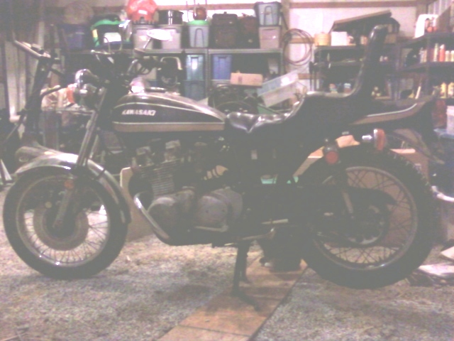

Just joined the forum with my recent acquisition of a 1975 Z1B. Father-in-law gave it to me so starting cost is literally $0. Hope to get it back on the road with a minimum of funds.
After posting in the new members' section, I've come to realize this bike can be worth quite a bit in good shape. Hopefully, I can get it back in decent condition and end up with an enjoyable bike to ride. If it happens to be worth a few $$$, that would be a nice bonus.
Here's the starting point. Bike was running (though not perfectly) when parked 8 years ago. Never was ridden regularly in our family, don't know about previous owners. 18,XXX miles, a LePera seat, and 4 into 1 exhaust. Paint is in less-than-stellar condition, some oxidization on the engine, chrome in decent shape.
I'll post a few photos of initial condition, and later post new pics as things improve.

Looks darn good for $0! As far as paint, you may be able to save the original if the base paint is in good condition. I have seen members here re-clear coat original paint with beautiful results. Will save you money as well. As far as the the engine is concerned. Here is a good topic on what to use to clean aluminum or chrome:
www.kzrider.com/forum/6-paint-a-bodywork...-for-aluminum#468808
But before starting on the cosmetics, you should go through the bike and get it running and address any mechanical issues. Take some precautions when doing the first start like squirting some mystery oil in each cylinder and first using the kick starter with your hand to make sure nothing is frozen from it sitting. Afterwards, you should check the carbs and the fuel tank for gunk and debris. But I am barely touching upon all these things. Search this forum for proper first start prepping and maintenance threads. Don't rush and try to enjoy each step. Take lots of pictures to post. We love pictures.

Search: Soda Blaster. To clean up your engine, then you can follow that up with some Mothers polish if you want.
My tank did the exact same thing when we took it out of storage. I was able to sand off the original clear, mask off the original lines then repainted the blue (in my case) and black lines.
Here's my shoestring budget build: z1ownersclub.com/topic/3666295/1/
As far as the running condition. Clean and inspect all the electrical connectors and apply some dielectric grease to them, clean and rebuild the carbs, do a tune up and replace the points, reset the cam chain tensioner.

Thanks for the tips. Have already ordered and received new air filter, points/condensers, and spark plugs. Planning to pull the carbs tonight for cleaning.
I figure I'll check the valve clearances and squirt some oil around up there before I try to start it. Bike did run when parked, but that was long ago.
Definitely planning to get it running before I start in on the aesthetics. I'll try to post as I go. Having a new baby (4th 4 and under) in 2 weeks, so anything I don't get done soon will probably be waiting a while. Ideally, I'll get the bike fired up before the kid arrives Feb. 3rd (c-section), but we'll see...

Check the vavle clearances after you get it running. There can be rust and who knows what gunked up on them.
Youll be able to spend thousands gettting this bike back on the road and you wont loose a dime when you sell it.
