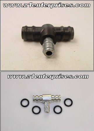

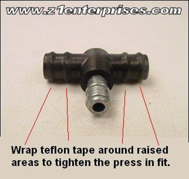

Patton wrote: If an el'cheapo fix is needed for the original style fuel pipe with the raised rubber ridges (no separate o'rings), may wrap the fuel pipe's raised areas with teflon tape to tighten the fit. Yellow teflon tape is supposedly more gasoline tolerant than is the more common white teflon tape.
www.z1enterprises.com/detail.aspx?ID=1910
www.kzrider.com/forum/3-carburetor/49950...e-replacement#499592

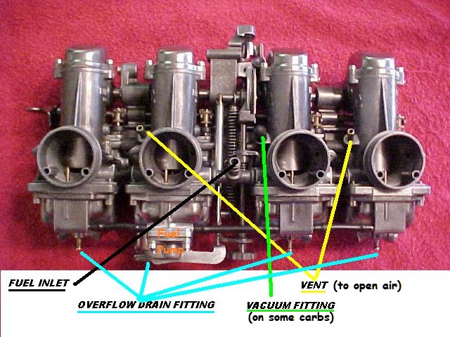

Single fuel line carbs usually have a single fuel pipe situated between #2 and #3 carbs.
Dual fuel line carbs usually have two fuel pipes situated between #1 and #2 carbs and between #3 and #4 carbs.
