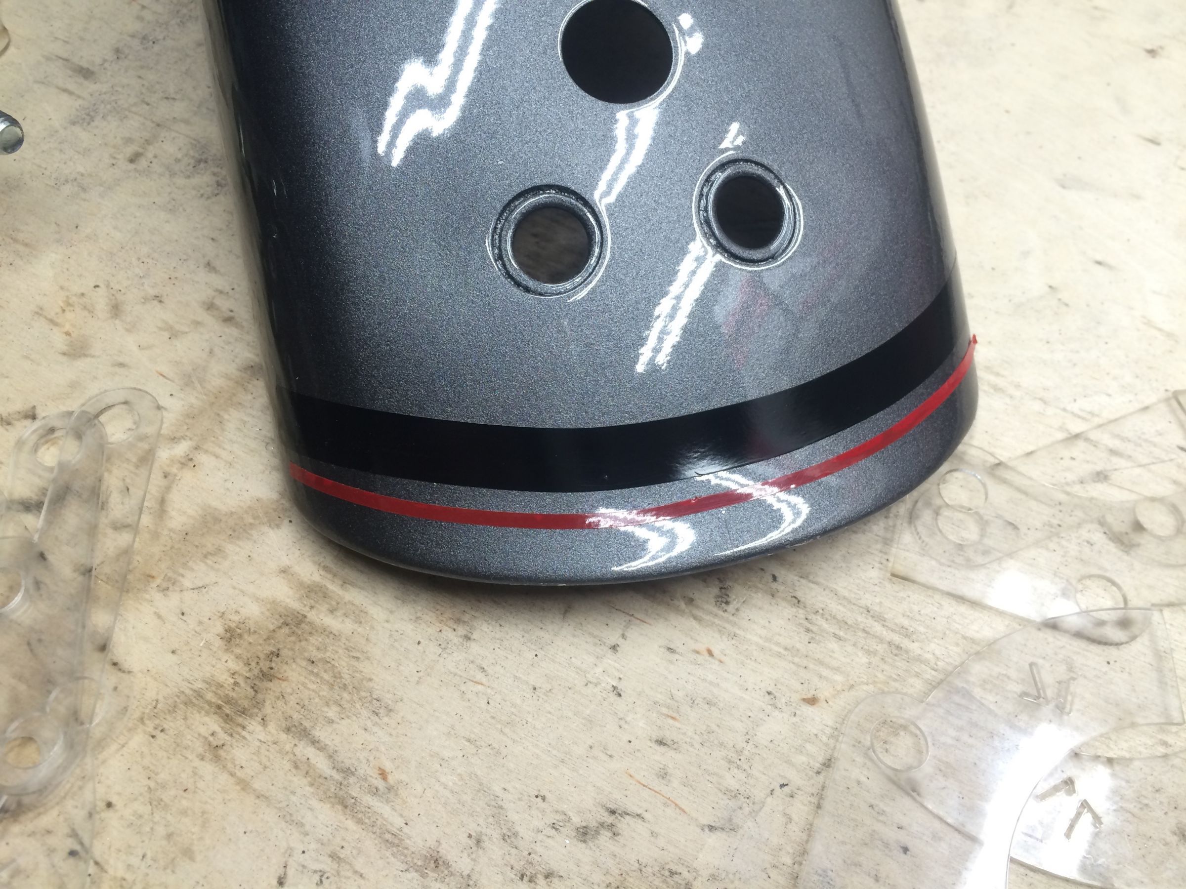

I'm torn in-between doing vinyl pinstripes and clearing over them or painting the pinstripes on and then clearing. I'm worried that if i paint them they wont be very crisp and the red will take many layers to get it bright over the grey. Vinyl is so easy to apply. I bought this vinyl pinstripe but the red is semi-transparant and not nearly as bright as I want it to be. maybe hand pinstriped?

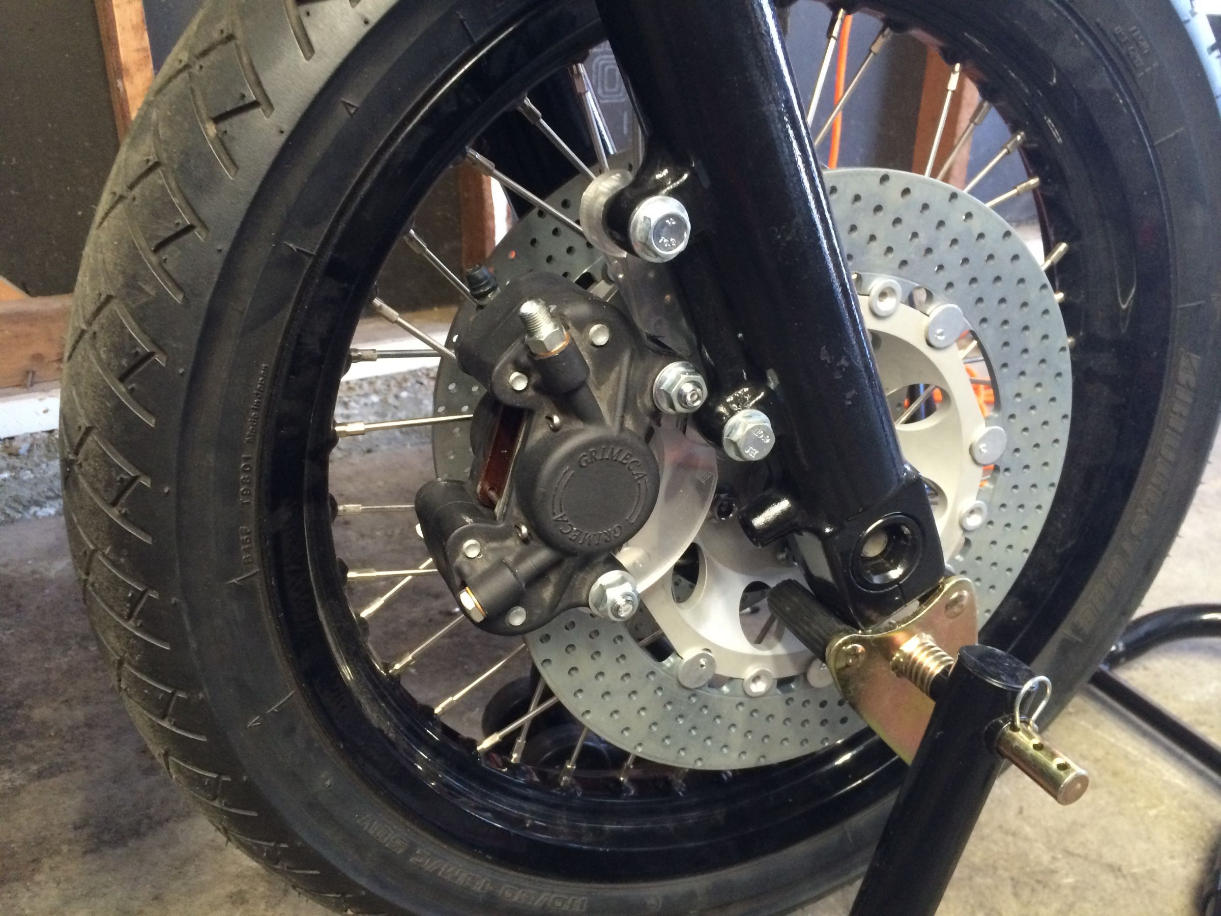

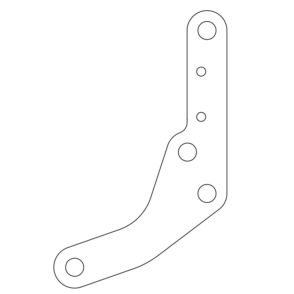

Im finally tackling another one of the things I have been dreading to deal with. When I had the machinist make the caliper mounts he made them so there was not enough clearance between the fork bosses and the holes he milled. Every time I bolted them on they would sit in a different position and didn't seem to be parallel to the disk. I realized the mounts were binding on the fork tubes so I sanded them down so they wouldn't bind. After that the calipers hit the spokes. I put them on the shelf for 2 years.
I drew up a new bracket in CAD and laser cut the profile out of .060" acrylic so I could stack them to get the correct spacing. After some tweaking I have finalized the design. I think its better than the original as i put the bracket behind the fork bosses and caliper so everything tucks in tighter. I am taking one out of Slikwilli's book; I'm going to have the bracket waterjet cut out of 7075 and then manually mill the rest.

So i decided to paint the pinstripes with 1 Shot sign paint. they make a special hardener (4007) and reducer (6001) so that it can be applied under urethane clears. I sprayed a test piece out and prepped the rest of everything.
