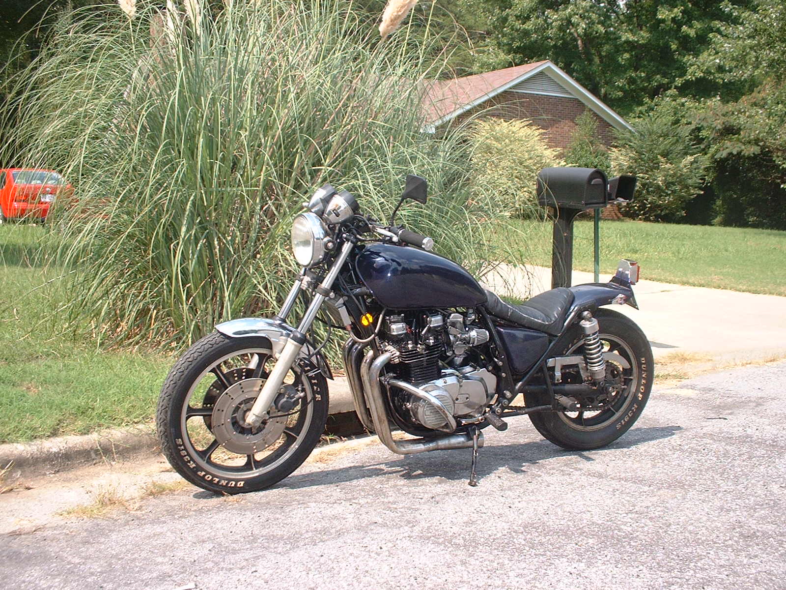

-Recreating this airbox/pod system (credits to kzbobber1)

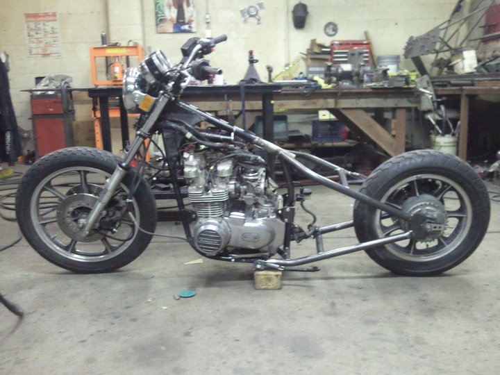

Fun time hacking and grinding
Going to be using the original "triangle which was cut down a little. Will post what it looks like once tacked up. Hopefully going to be mocking up the leaf spring seat soon.
