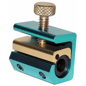

so i would suggest taking your clutch pusher out of your cover and washing it out with some solvent.then give it a re-grease and as chaotic mentioned lube your cables.
something is dragging (capt. obvious again :whistle: )and it is a simple setup.
soo cable,clutch pusher,or pivot,unless you have broken pressure plate springs under the clutch cover on the other side.
these are great for lubing cables easy and fairly clean.worth having for sure.
