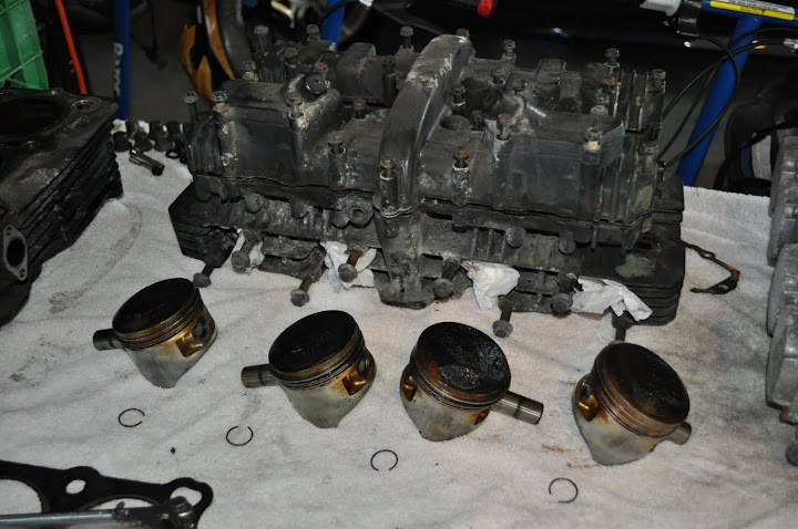

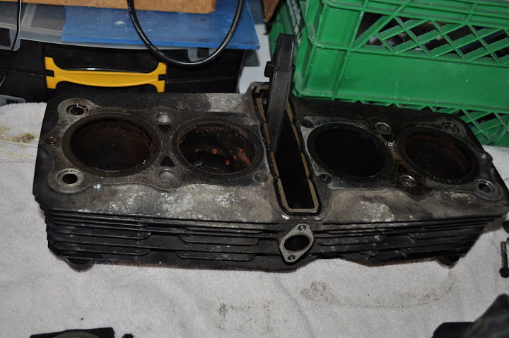

Quick update...
Tore the top end down to inspect things a bit. Quite a bit of carbon build up on the pistons, but nothing unusual. Cylinders looks pretty good (not that it matters much). Head is in good shape.. Rods are nice and tight, no excessive play, so things look good.
This morning I took all the pieces to Joe at Pit Stop Performance in Orlando. Fortunatly for me he is right in my back yard. I live like 20 mins from his shop. Great guy, and very informative. Im sure everyone how has already done business with him knows that.
So here is the plan for the motor as of today. (we know how things change)
Engine:
Full Head Job (guides, springs, etc)
Stage 1 Porting
PSP-3X Cam (.418" Lift, 282 deg @ .030" Lift)
New Studs, Cam Chain, etc..
Cylinder bored to 72mm (1075cc)
MTC 72mm Pistons
Welded Crank
Back Cut tranny.
Thats the nuts of the build, but of course will do all the small stuff, seals, bead blast the block, etc. Should net me a CR of 10.5:1 with a nice solid running platform. Im still debating about uping the valve size, but don't think I will at this point.

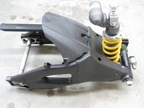

I got the swing arm today and mocked it up. My question is this... What is everyone else doing on the the bottom shock mount? Are you reinforcing the center stand mount at all or just using it as is? Im thinking of welding on some top and bottom plates for extra support. Thoughts?

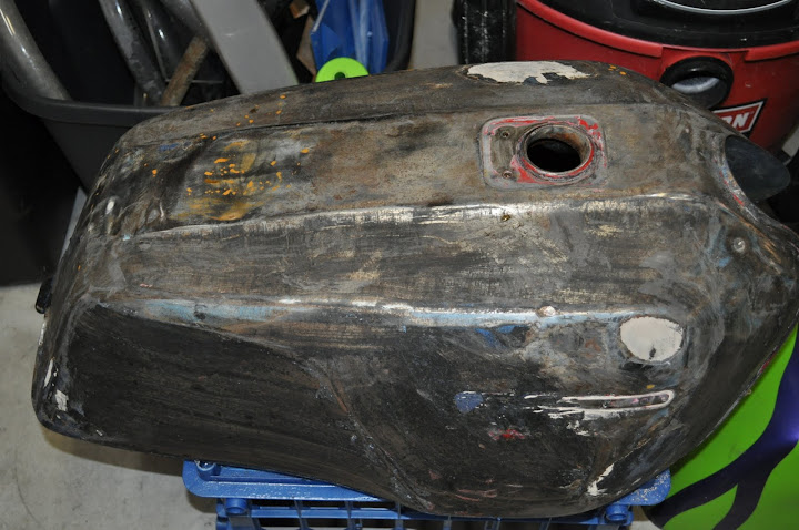

Also stripped the tank.. Someone was not nice to it, found no less then 4 filler spots, but I will take care of that. R&R'd the petcock and the fuel sender unit. Tested it appears to be working fine.

07 Oct 2011 08:59Boostable wrote: What is everyone else doing on the the bottom shock mount? Are you reinforcing the center stand mount at all or just using it as is? Im thinking of welding on some top and bottom plates for extra support. Thoughts?
It really depends on where the bottom linkage mount falls. You need to replicate the donor bike's linkage geometry as close as possible. Sometimes the linkage will fall into the center stand holes but most likely you'll need to cut off the center stand tabs and make new ones for a different location.

07 Oct 2011 19:40StreetfighterKz wrote:Boostable wrote: What is everyone else doing on the the bottom shock mount? Are you reinforcing the center stand mount at all or just using it as is? Im thinking of welding on some top and bottom plates for extra support. Thoughts?
Later, Doug
X2
i see u r off to a nice start. u were asking about frame braceing. well my freind , you'll be happy to know that your frame allready has all the bracing required. all the brace kits try to duplicate what u allready have.

Thanks guys.... Kinda what I thought, it looks like I gota go down about another 1" on the lower to make the linkage sit right. Was hoping it lined up, but want it to be as perfect as possible.
Mark, thats kinda what I thought... Just wanted to be sure...
