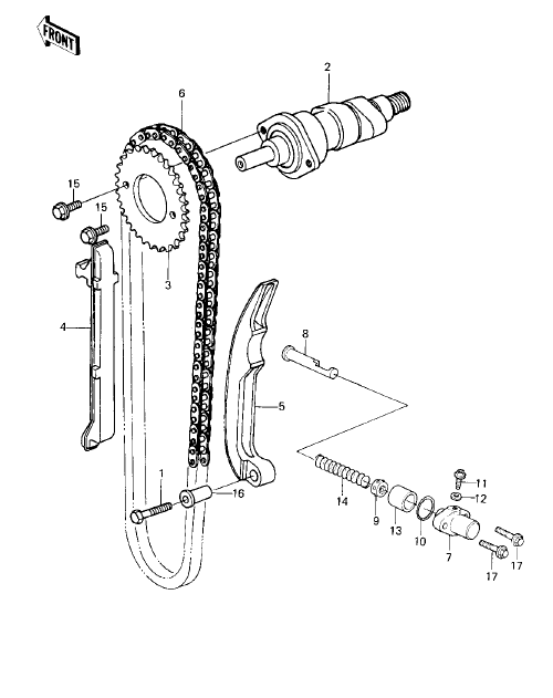

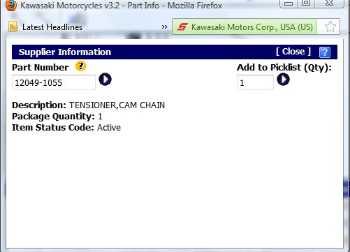

You need to get another cam chain tensioner, that one that you have is no good now. You could possibly have quite a failure if you keep running it. Please replace that before you have a big issue.
I think, from looking at your photo, that the nut on top, which is a locating guide pin, was installed in-correctly. When you tightened it down, the housing broke. I don't know what your finances are, whether you would buy a good used unit or maybe an APE manual tensioner. But if the cam chain is not tensioned properly, to tight wears stuff out, and to lose it can jump time. The tensioner is still an active part from Kawasaki, it is used still on many ATV-Quads.
Glad the lose Pilot got the plug cleaned up. Give your crankcase a sniff, it may well be contaminated with fuel.
