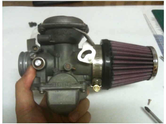

Hey Sham, are you set up with this? Its from the first page of your thread.
If so this would be making your carb stock jetting too lean, and may well be the cause of the high Idle, and crappy running when you try to open the throttle.

Yeh I'm running the pod filter, but I changed the stock jetting to follow someone else's settings for their z250 (someone on the site, don't remember who). So the secondary (said to be in actual fact the primary) jet has been increased from 98 to 120, and the primary (read secondary) has been increased from 68 to 70. These figures are off the top of my head, but I believe that's what was said to have worked, and so that's what I'm running.
