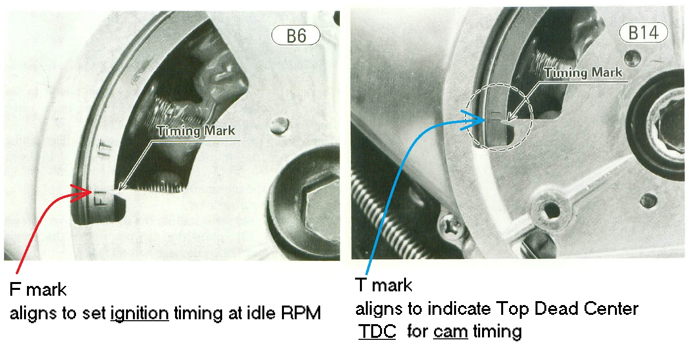

The following pics are from those included in the manual.
I added notations as to the F mark and T mark, in hopes of confirming exactly which is which.

The alignment I did today was to the T mark - my query is I guess what should be happening at this T mark - in my manual, it said that I would reach this T mark after the valve has completed its downward movement, while it was moving back up. So does this mean my timing mark should be aligning with this T mark sometime between the bottom and top of the valve movement (as it is now) or if it should be at the very top (which it isn't currently).
To confuse things more, I'm also reading elsewhere TDC is the position where both valves are closed. This suggests to me that the timing mark should be aligning with the T when the valve is at the very bottom of its movement?
Am I complete wrong here?
