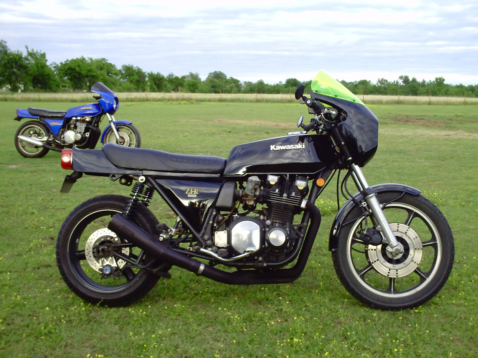

Received the rebuilt motor "top end" Friday...
This weekend it was painted with PJ1 satin black.
Today while things were a bit quite on the work front,the wife and I refitted the motor to the frame.
She amazes me with her strength...for a women thats 5 foot nothing and 50 kilos in weight.
Heres the pics...still need to refit the brake calipers...tins to be painted and carburettors have to be cleaned and reinstalled.
Yet to paint the black inners around the Kawasaki on the engine covers.
Every single nut and bolt and washer has been cleaned on the bench grinder with the wire wheel and refitted using heaps of Inox MX3 as I go.

that is coming along very nicely.
i get the feeling you have done this before :lol: .
all the attention to detail is showing .
keep us posted,
keep us posted,
