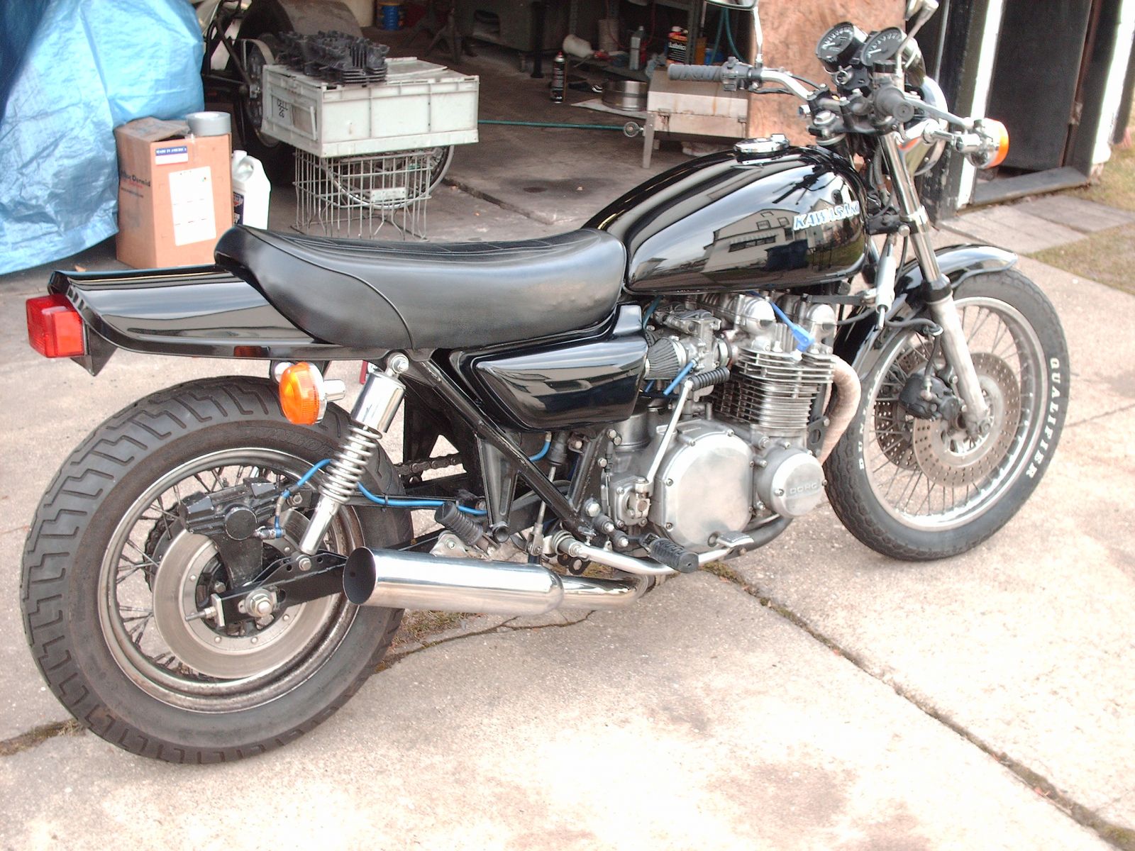

- z1kzonly
- Posts: 2815
- Thanks: 527
Re: This SUCKS!!! A word of advice would be AWESOME!
12 May 2011 22:56
I have a blacked out 77 KZ1000 that has rusted Euro style sport bars.
Want black ones without painting them!
[/quote]
I bought this bike in Ohio, I am going to paint the front lower legs black. I don't know what this back light is? But I am putting a KZ1000 Tail light and fender on it. The previous owner did this, welded some silly part in there. Plus , I will lower it, change the position on the swingarm, shock mount. then it will be for sale. It is fast, 1045cc, dyna, .410 cams, 32mm flat slide Mikuni's.
Runs like a bear!!
[/quote]
Runs like a bear!!
