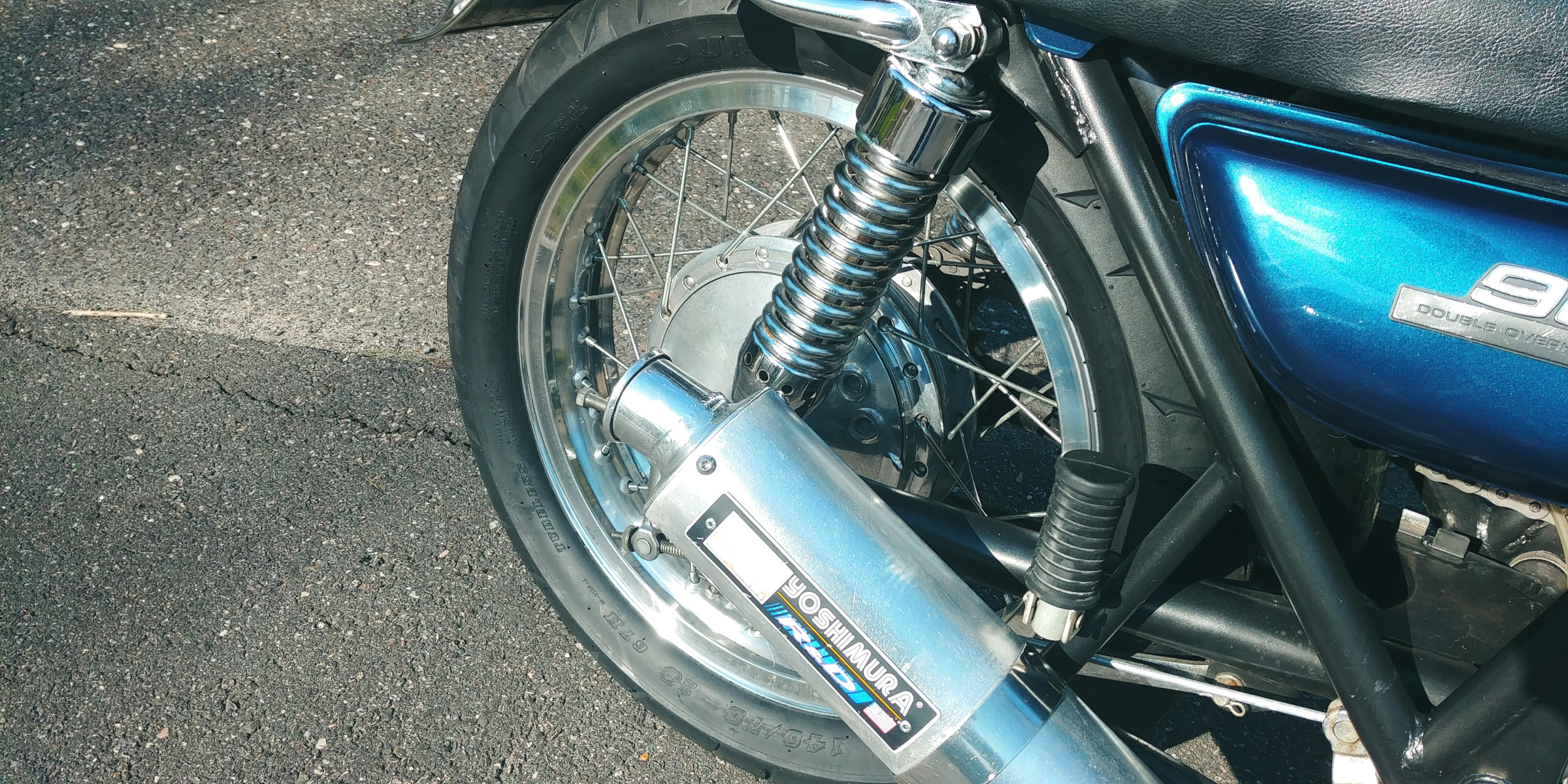

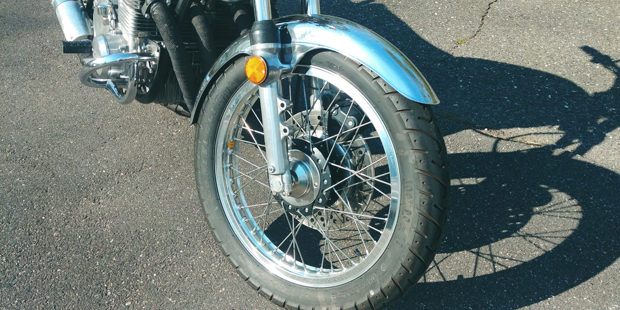

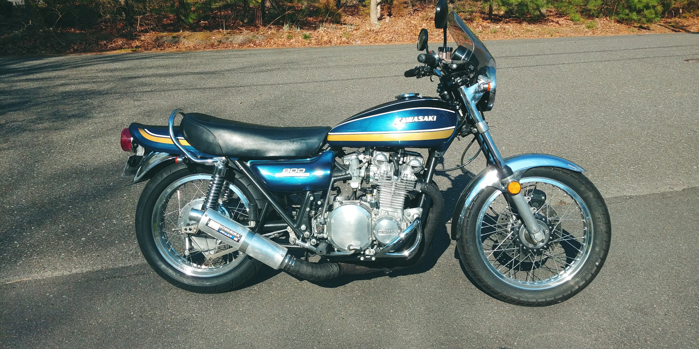

Bringing this thread back from the dead since I made a bunch of changes.
First off, swapped out the Euro bend handlebars for the Emgo 23-12565. I never liked how the Euro bars bent down like clip-ons. With a MX background the new bars are wide, and flat. Just how I like them.
Also swapped out the directionals for some real nice polished cast aluminum ones, I think another Emgo product. Highly recommended, but to mount to the headlight is a bitch.
New Racetech fork springs. I was going to lower the ZRX shocks to 11.5" but decided to just buy a set at that length to see if I liked it or not. To mod the KYBs that much there would be no return. So we'll see how it goes, so far so good.
Last I swapped out the rims for Akront (repop) with a wider rear rim and tire. Went with a 3" rim and a 140 tire. Would liked to have gone 150 but Id rather play it safe on this one.
Last is the exhaust. I made a thread on it but basically remived the left side Hooker and fabbed up another system from parts. Sounds great, runs great.
Also snapped the hi/lo headlight switch......again. lol

12 Apr 2020 06:00 - 12 Apr 2020 06:05Kidkawie wrote: ... Went with a 3" rim and a 140 tire. Would liked to have gone 150 but Id rather play it safe on this one.
Nice bike Kidkawie! Always been partial to that '75 blue livery.
Widest tires on (16" Lester) 3" rims we've run is 130, and a few of those kiss the torque link. How do you obtain clearance between the tire sidewall and the torque link?
Good Ridin'
slmjim & Z1BEBE

12 Apr 2020 10:05slmjim+Z1BEBE wrote:Kidkawie wrote: ... Went with a 3" rim and a 140 tire. Would liked to have gone 150 but Id rather play it safe on this one.
Good Ridin'
slmjim & Z1BEBE
Its very close, but not rubbing, and I still have to address it. But it looks like I can space the arm out with just a couple washers. I could run it as-is but noticed that option installing the wheel.
