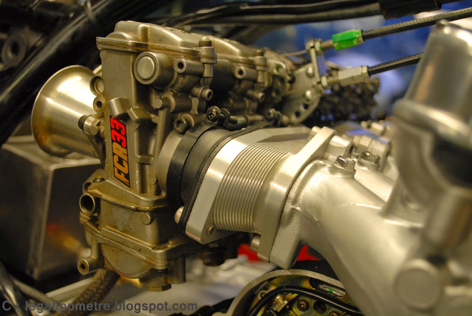

Re: Oh NO! What have I done! My new KZ1300
10 Jul 2014 07:22
6 FCR33's and those custom intake manifolds would probably tap my entire engine budget....
Aren't those like $1000 for a set of four...used?

The 6 bank FCR33's are available from Japan.... for the low, low price of $2,100 and change.
japan.webike.net/products/9638344.html
I also found out the Cosworth in the UK makes race pistons for the 1300's, 63mm bore with 11.5 to 1 compression, that ought to haul ass...
Attachment fcr_3061.jpg not found

22 Jul 2014 16:43Tyler wrote: The 6 bank FCR33's are available from Japan.... for the low, low price of $2,100 and change.
:woohoo: Oh yea!
