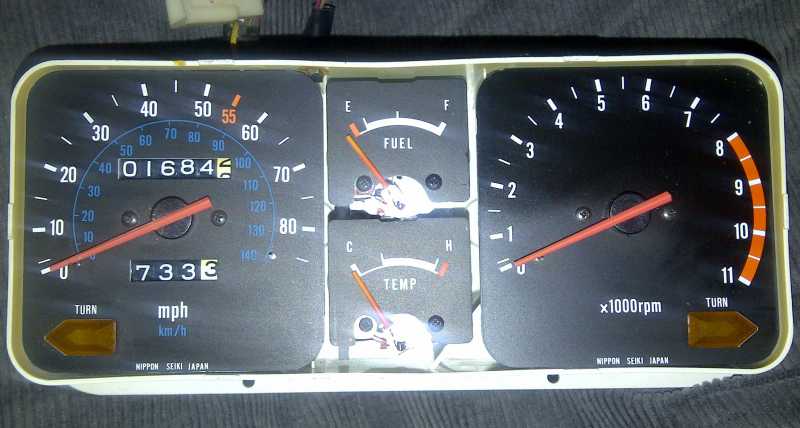

The finished product soldered in place.
I hope to have them back together soon. I got my tank back as well, so with a little work I should be able to fire her up.
