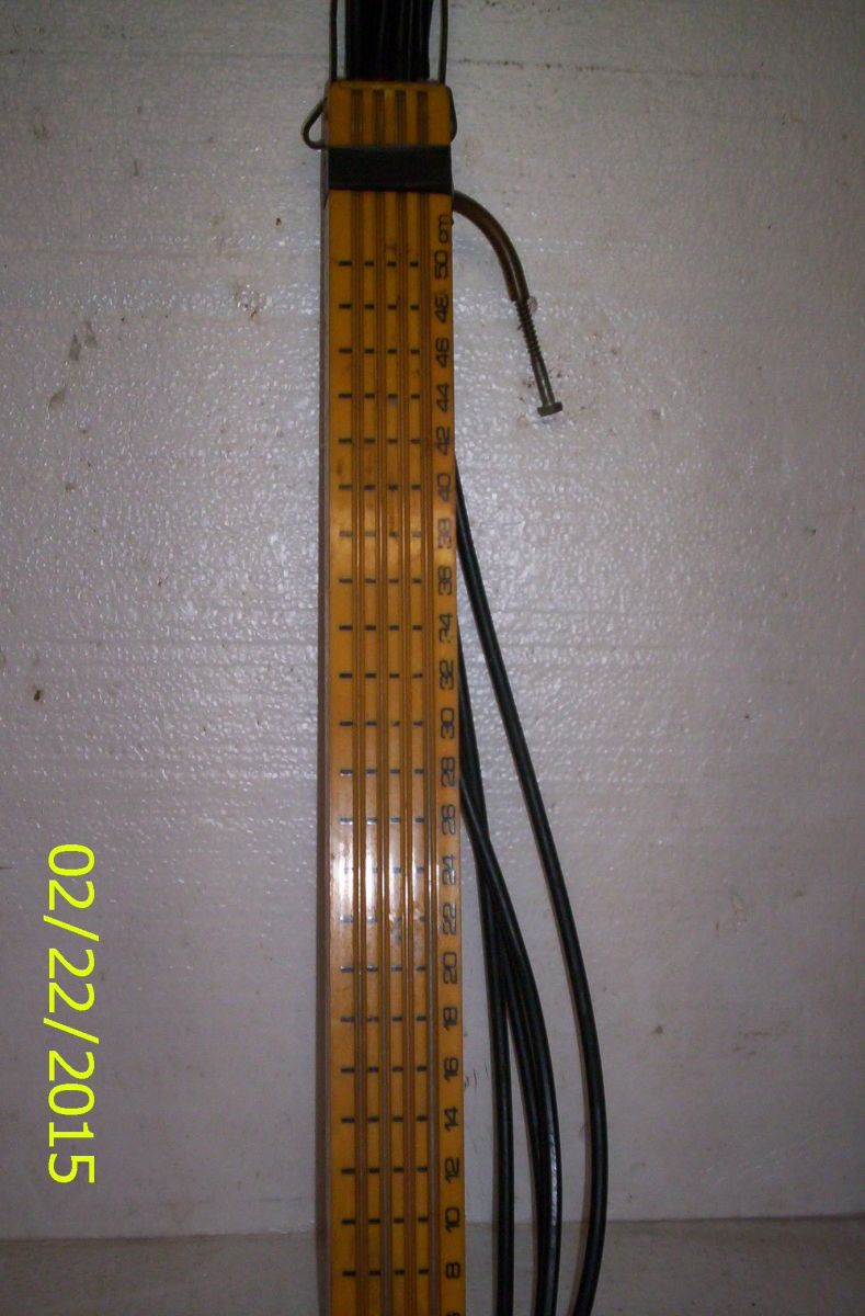

I picked up a carb balancing tool, I am pretty happy with it, and it can be used as a generic vacuum gauge if need be too. Its not a monometer, each slide is its own gauge. Its a Morgan Carbtune, the exchange rate is pretty favorable right now so its not that much more expensive than the alternatives.
