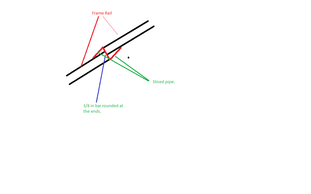

I was planning on cutting the frame originally at the cradle. Then I was going to weld in 3/8th in steal slid in between the cut and rounded off to match the radius of the frame tubing. Then I have going to slice tubing that was the same size as the frame and welding it in. Making almost a diamond shape. I attached a crude Paint representation of what I'm talking about.
This would be if you were looking at it from the top.
I honestly think that would be the easiest way to go, provide plenty of support and keeps everything in line. Just lathe out some spacer for the swingarm and motor mounts and I'd be done. I believe it would be a total of 6 cuts and splices. 2 on the top of the cradle 2 at the bottom and 2 on the back bracing for the tail.

mod the swingarm
that's my .02.
it's your bike :whistle: .
