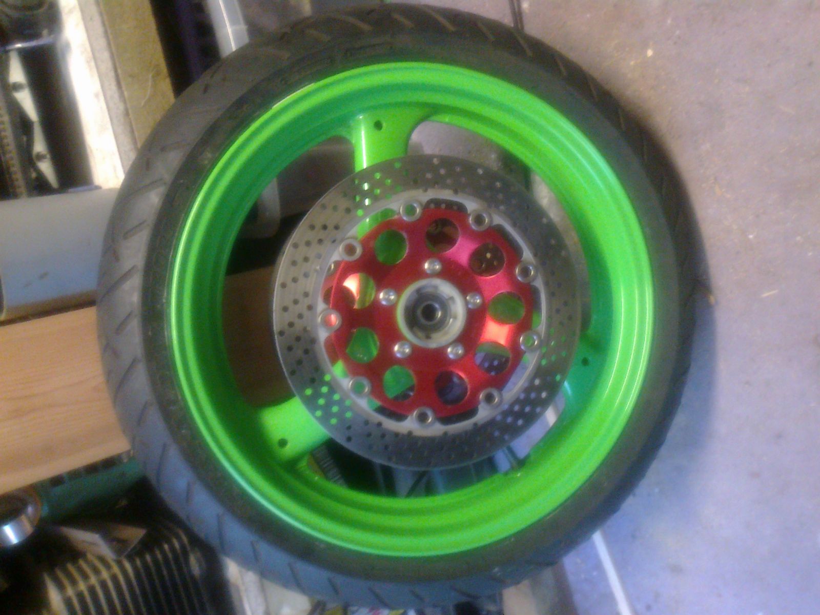

14 Jul 2011 17:18

- Posts: 7442
Re: KZ650 Streetfighter Project
16 Jul 2011 18:50
sweet!
green and red reminds me of christmas. :lol:
- cherrymetal
- Posts: 95
20 Jul 2011 14:00
Probably be christmas before the wheels are fitted at this rate!!
