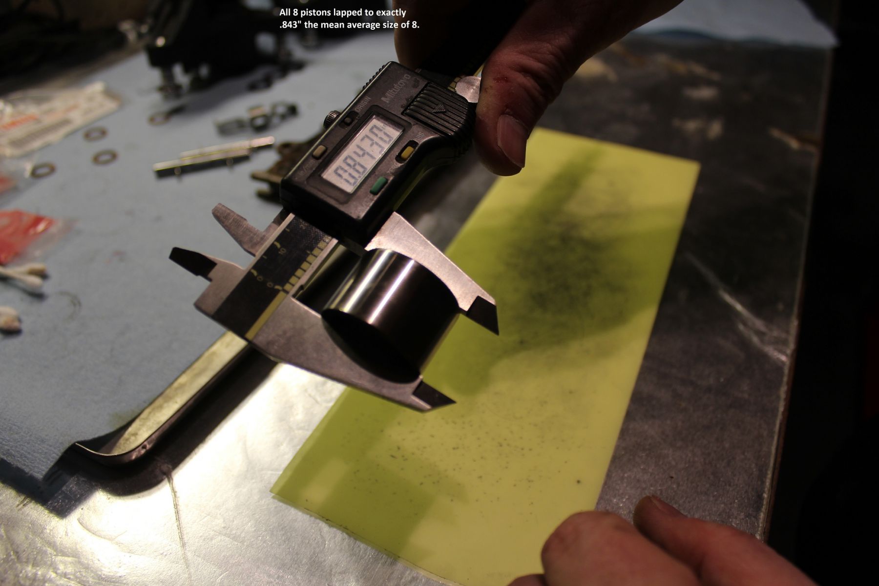

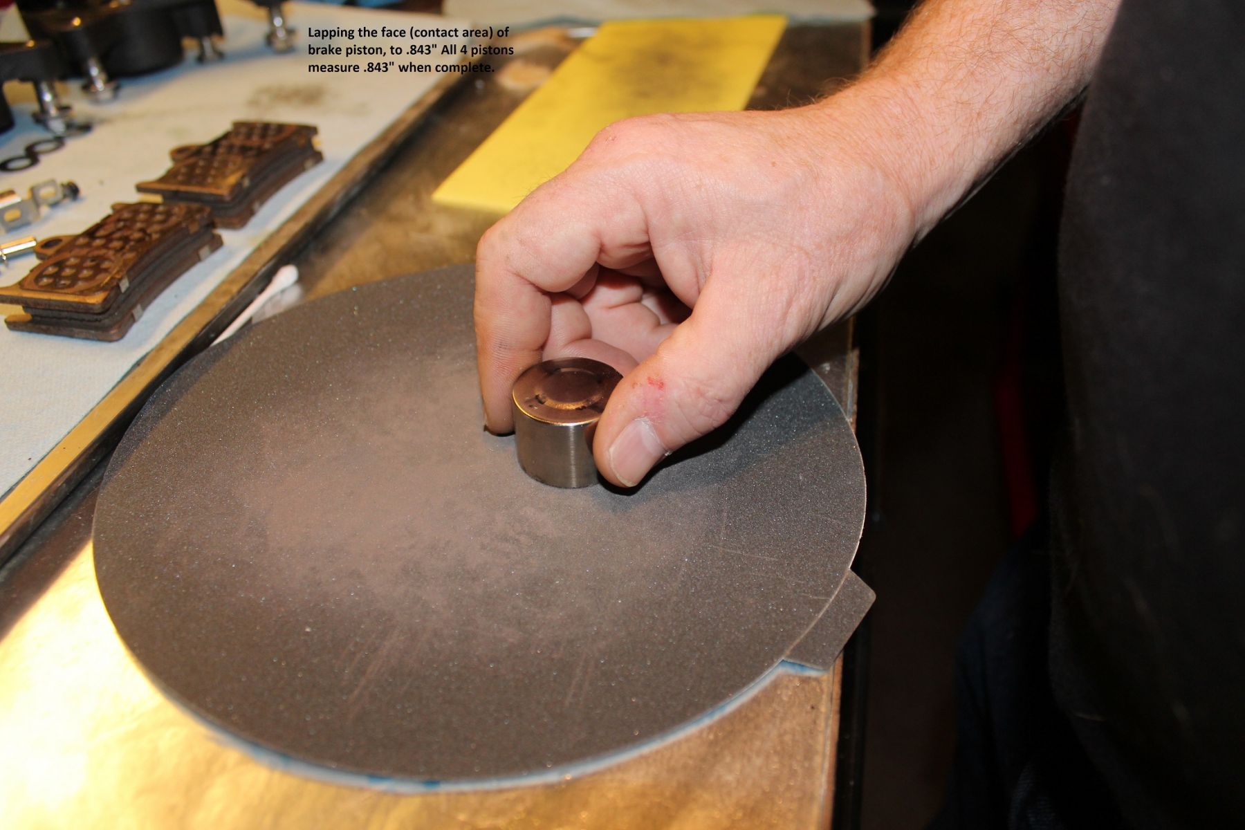

27 Jan 2012 02:27 - 27 Jan 2012 02:28Then I hand lapped each piston to exactly the same length. This I am unsure of wheter it will help, but another great friend of mine, always made sure the brake drums on the cars he did were all the exact same diameter, so they all engage at the same time.
This makes sense so I thought I would try it. The pistons had a .003" range of size difference. .8435"-.8465", now they all measure exactly .843".
We'll see if this all helps the "feel' of the front brakes on the track.
Just thought I would share this, to see if any of you have input.

Oh sorry about the Cutlass !! That is unfortunate. I learned of this with my 71 Dart, another resto project. My buddy Dan was painstakingly measuring and cutting on the drums, so I asked "why"? He also hand polished the drum surface... he was a brake "Surgeon". the car would stop beautifully as long as you did not cook em (over 90 mph in a hurry). But hey that was the Mopar right !!
That car would stop Dead straight... very unusual for a Mopar.

very interesting. i never thought about polishing the pistons. good job. dont know if i could feel that kind off subtlety, but why not try. i did polish the damping rods in my forks though. u may want to do that. i bought racetech gold valves, and springs for my 01 cbr6 track bike (very similar to your R6). in the instructions, it recommends polishing them with 400 wet dry to improve sticsion. i used 400 then 600.
i bought braided lines,a newer zx6 radial master, and Friction Performance pads for my brake upgrades. they work as good as i need. no trouble getting the back wheel off the ground with 2 fingers. the pads give me a more sensitive and progressive feel. most notably while trail braking.
put some cable ties around your fork legs, to measure there travel while braking. if u are using almost all of the travel u need more stronger springs or more preload .
