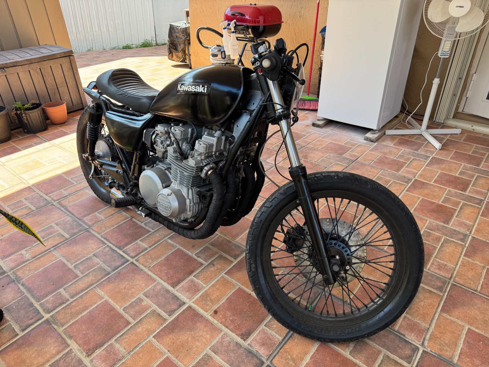

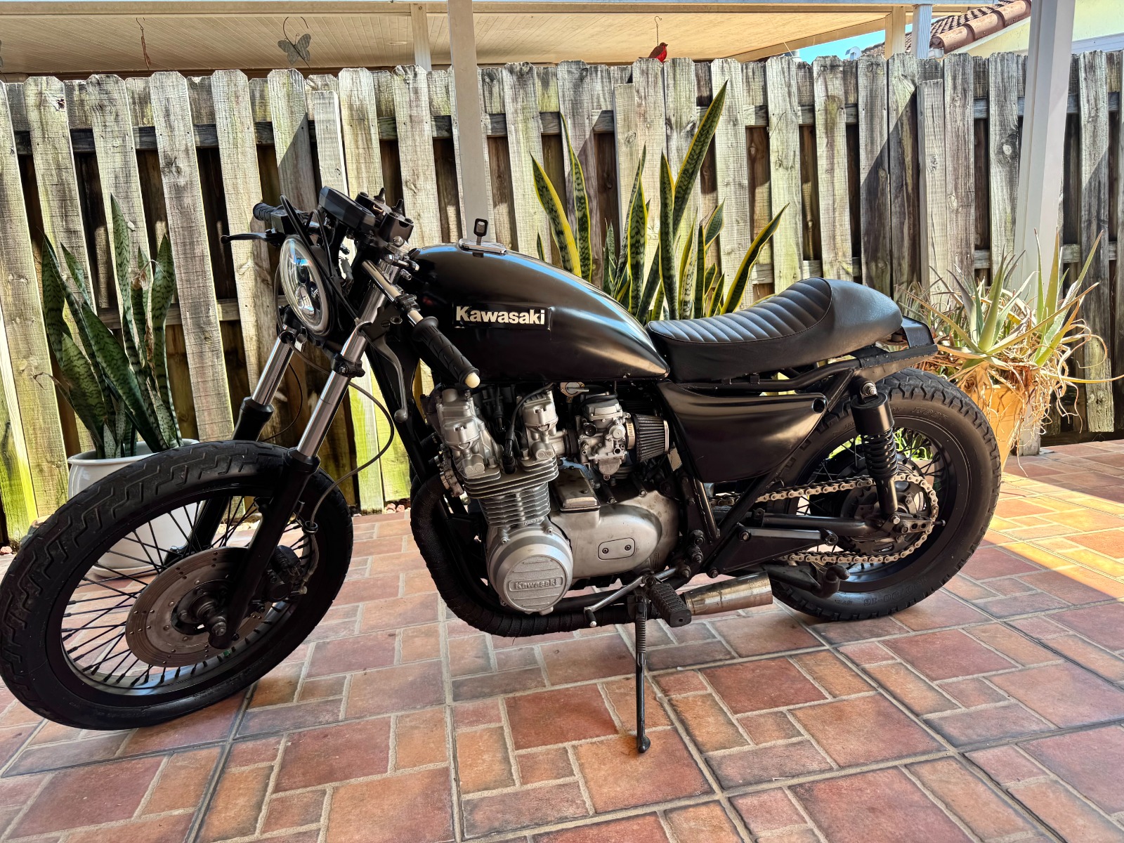

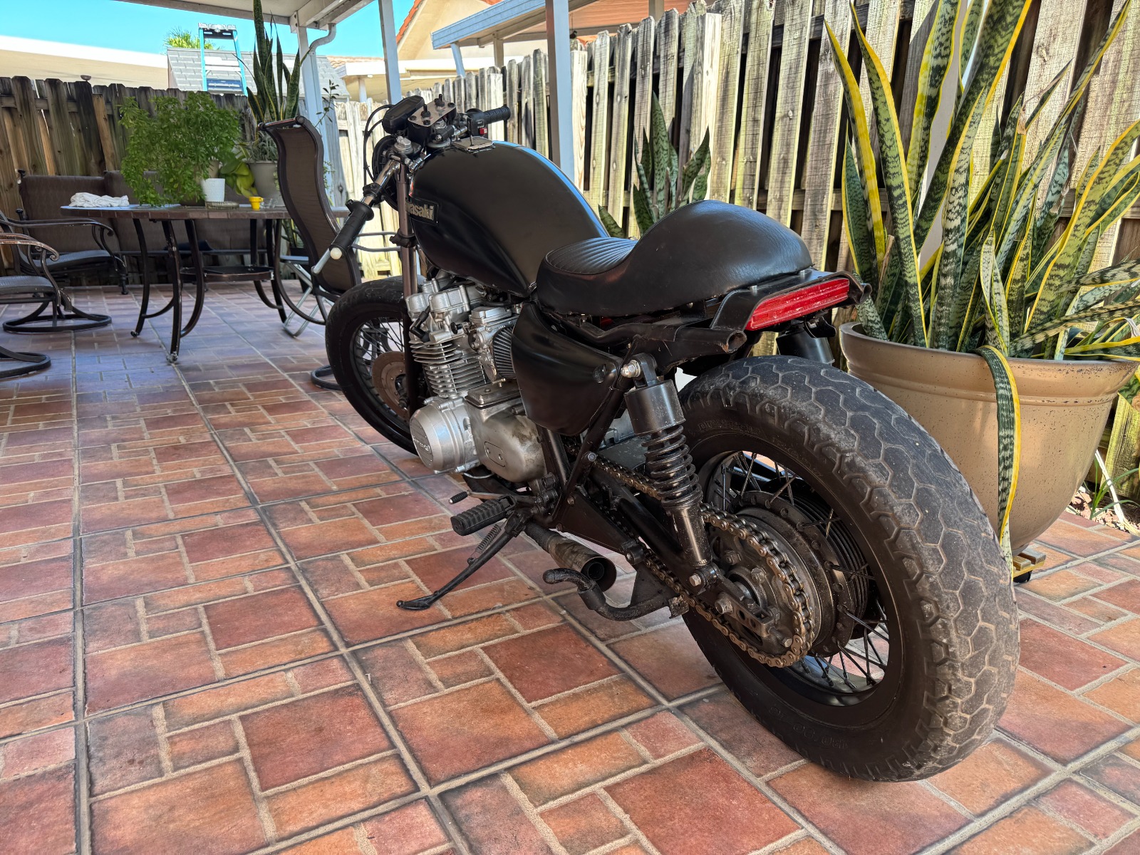

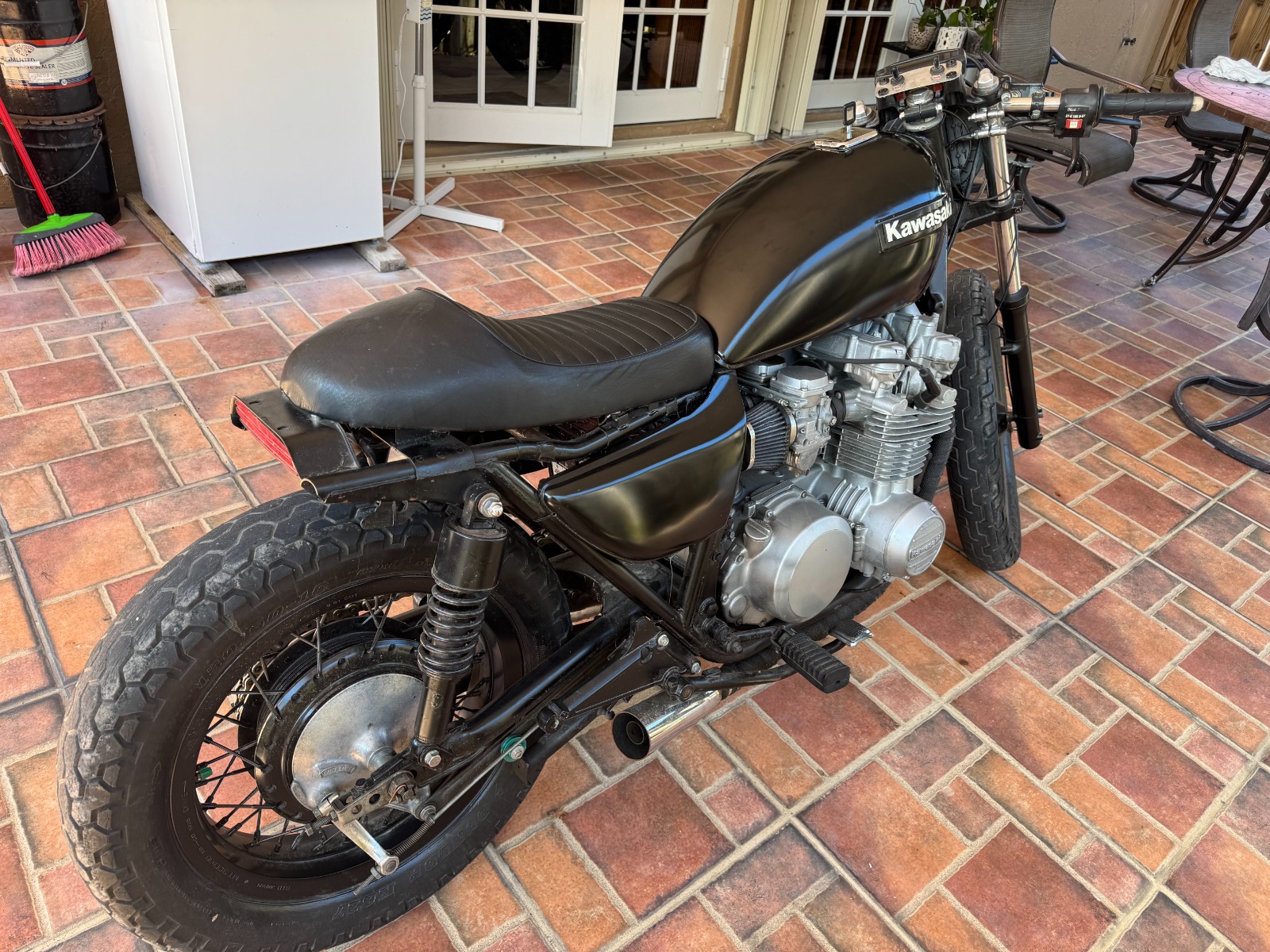

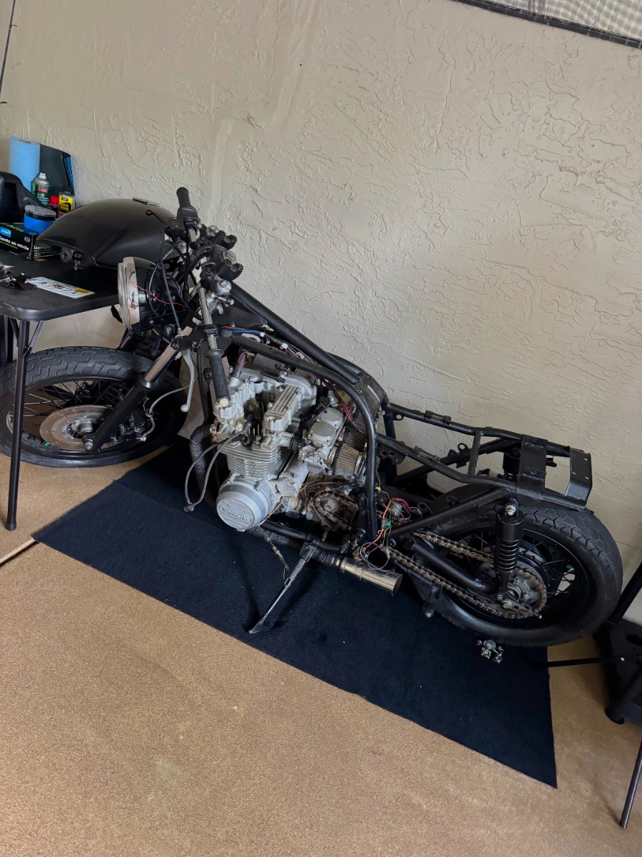

28 Aug 2026 22:50 - 29 Aug 2026 11:41How's it going everyone ? Thanks for the add. Hoping to learn a few things on here as I build my first cafe racer out of my 1982 KZ650 CSR. Not my first bike but definitely my first in depth build.
Little bit about myself, I'm a machinist and have always been a car enthusiast. So wrenching and building cars has always been a passion.
Question I do have is, What aftermarket gas tank, other model KZ, or any make/model bike tank could I swap to give it that cafe racer look ?
I am aware the brackets will need to be modified and to be honest I'm looking for the least amount of work.
On to the photos. First 4 photos is how I bought it and last photo is how it currently sits as I wait on parts.

30 Aug 2026 11:54Welcome in!What aftermarket gas tank, other model KZ, or any make/model bike tank could I swap to give it that cafe racer look ?
I’m nit exactly sure what your definition of “cafe racer look” means for a gas tank. Long? Knee dents, etc? Maybe put a pic of what you’re trying to imitate?

Looks to me like a '81-82 CSR model (H1-H2) 1983's have different engine covers. They have a unique frame, seat, and gas tank.
Not sure if any other KZ model tanks would fit, some use different front posts and rear locators.
If you need more info most of it is on this web site :
www.jarlef.no/Kawasaki/Series/Z/650/z650sr.htm
Scroll down to the bottom for CSR.
Most of the best KZ650 Cafe builds are done starting with B models, as they were the lightest with the wire wheels and the bigger gas tank (easy to hammer knee dents)

02 Sep 2026 20:52 - 02 Sep 2026 21:08So the tank I’m looking for is something that sits a little bit lower and has a bit of a slant cut where the seat meets. B1/B2 KZ tank or like the photos I provided.

07 Sep 2026 10:24Those aren’t the Mikuni BS32 CV? What makes you say otherwise?BTW - Those are not stock carbs, not sure what they are off.

07 Sep 2026 11:49Not sure if the photos of the carbs I attached help identify exactly what they are. Looked for a small stamped number and nothing. This is all fairly new to me. I come more from a car background. So I’m here for all the learnings I can possibly get.to the best of my knowledge only the 1000 J3 and ELR had the BS34 with enrichment valves ? And maybe other brands?BTW - Those are not stock carbs, not sure what they are off.

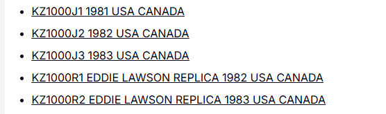

They look like regular BS34 but with enrichment valves (the unit on the left of the carb with three screws holding the cover) According to CMNSL in Kawasaki world the below are the only 4cyl models to have the enrichment valves (several 125 and 250 models had them also)
