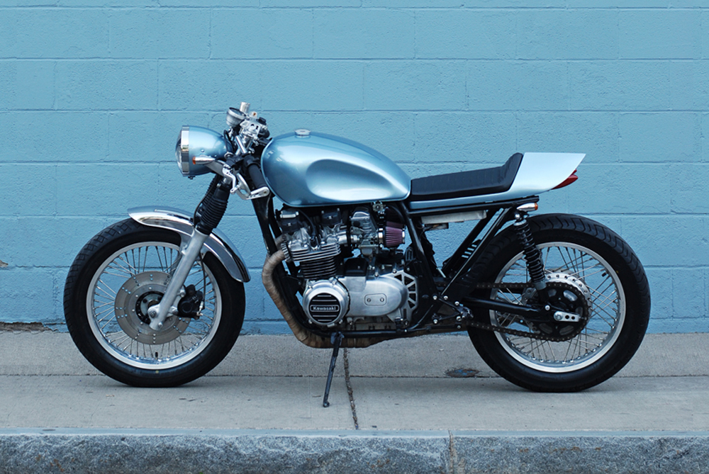

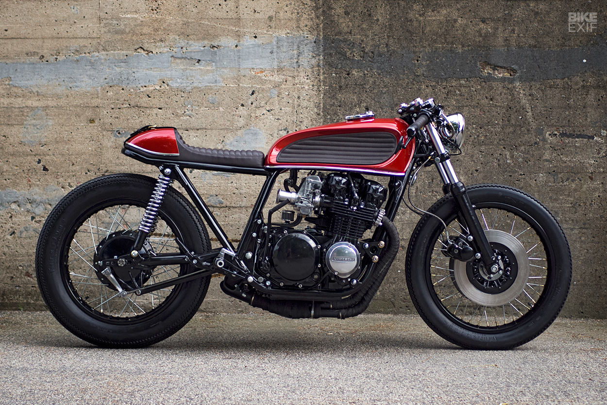

02 Sep 2026 20:52 - 02 Sep 2026 21:08So the tank I’m looking for is something that sits a little bit lower and has a bit of a slant cut where the seat meets. B1/B2 KZ tank or like the photos I provided.

02 Sep 2026 20:58 - 02 Sep 2026 21:03It is a 82 CSR H2. I’m fine with re fabricating the mounts. Thank you for the link. I’ll definitely check it out. wrote:

Here is a example of a cafe bike done on a B model (note tank difference) :
Its important to look for pictures of the same model bike so you can see what it will look like.

Today 10:24Those aren’t the Mikuni BS32 CV? What makes you say otherwise?BTW - Those are not stock carbs, not sure what they are off.
Here is a example of a cafe bike in that exact CSR model :
www.returnofthecaferacers.com/kawasaki-c...va-kz650-cafe-racer/
and thank you for the examples. I will do more research. I was just curious if other model kz tanks could work with mine with some minor fab work.
