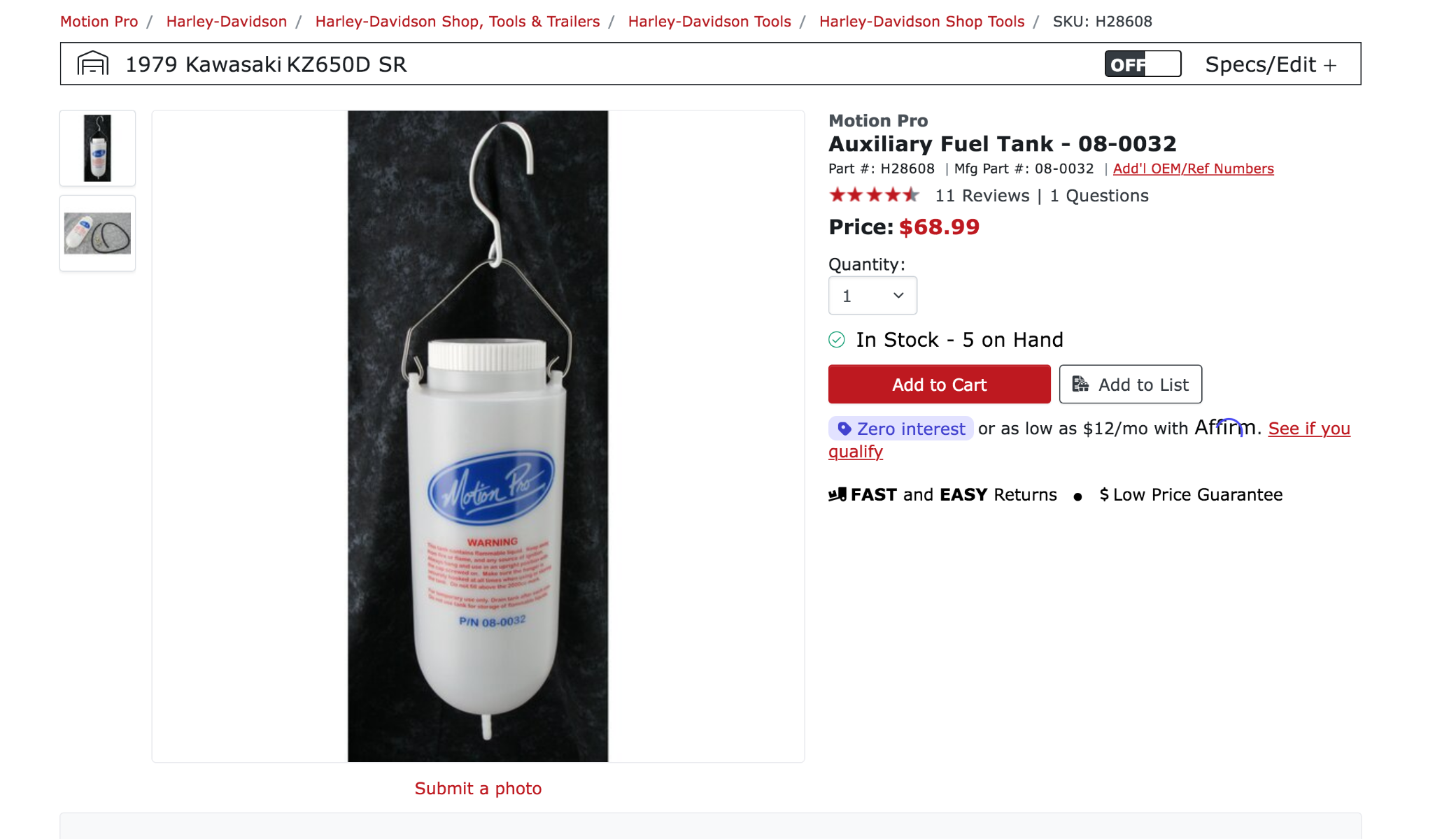

If it were mine, I would:
Pull the tank.
Buy a new battery. install.
Get new plugs, install.
Buy a Motion Pro remote gas device and connect it to the carbs. Block off the vac line.
Get the freshest gas you can and set up the remote fuel tank.
Push it outside and then turn the gas on. It will probably leak fuel out of the float bowls until the gaskets fatten back up.
Push the button and see what happens.

I found a on/off fuel tap that mounts into a 1/2"(I think) hole drilled into a one gallon plastic gas can I had laying around. I found it in the lawnmower section at the hardware store for $5. It has a hose barb the right size for the fuel line. It was cheaper than the Motion Pro tank.

I lost my 400F in a fire. And a truck. I've learned not to jerry-rig stuff when it comes to fuel.

It's not jerry rigged, it's a Briggs and Stratton fuel tap for their plastic fuel tank.

That's funny. You are telling the OP to put gas to this bike and see what happens. No way in hell I'd do that. Those carbs would come straight off for a full rebuild before hitting the starter button.
