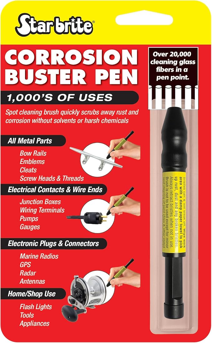

Fiberglass pens also work for cleaning contacts gently and without spray solutions like contact cleaner:
(That's a representative sample; I am not familiar with that brand.)

07 May 2026 04:59Thanks Nerdy. Didn't know they existed.Fiberglass pens also work for cleaning contacts gently and without spray solutions like contact cleaner:
slmjim used a typewriter eraser for field - cleaning certain contact surfaces in photocopy / printer / scanner equipment. The rubber conforms to shapes, and enough fine abrasive content to clean & polish without removing excess material.
