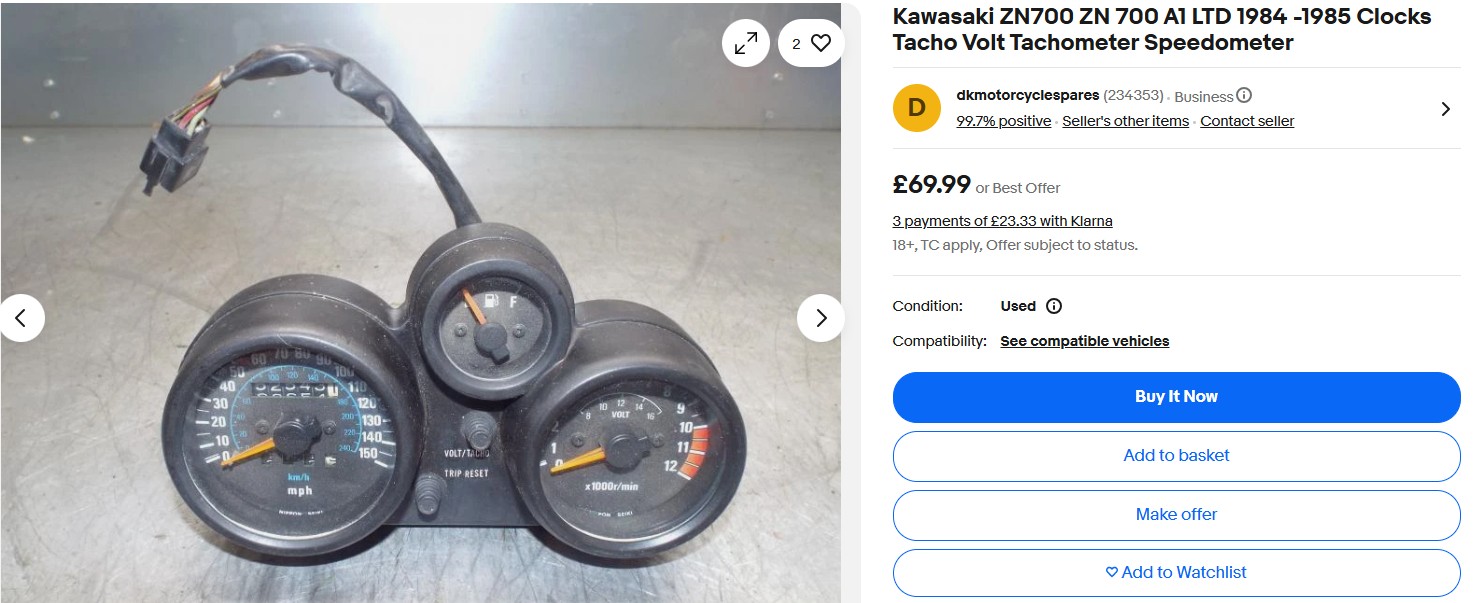

I could be wrong, as I'm not an expert on that exact motorcycle, but for sure the paint has be redone, and I don't believe the guages are even remotely close to original to the 700cc model, so there is no telling what the miles may be in truth. A KZ650/700/750 at 40,000 miles will have multiple oil leaks if not repaired from the multiple orings used everywhere. If repaired they will return after some time. I don't mean to criticize, just saying my opinion and experience. The cam chain is not a big problem, but the idler roller sprockets have rubber centers that go away to dust and the tensioner is not the best. I assume it has the single row chain like a KZ650.

22 Jan 2026 02:04 - 22 Jan 2026 02:05Clocks look right to me ?I could be wrong, as I'm not an expert on that exact motorcycle, but for sure the paint has be redone, and I don't believe the guages are even remotely close to original to the 700cc model, so there is no telling what the miles may be in truth. A KZ650/700/750 at 40,000 miles will have multiple oil leaks if not repaired from the multiple orings used everywhere. If repaired they will return after some time. I don't mean to criticize, just saying my opinion and experience. The cam chain is not a big problem, but the idler roller sprockets have rubber centers that go away to dust and the tensioner is not the best. I assume it has the single row chain like a KZ650.
