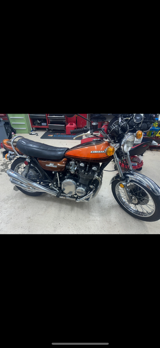

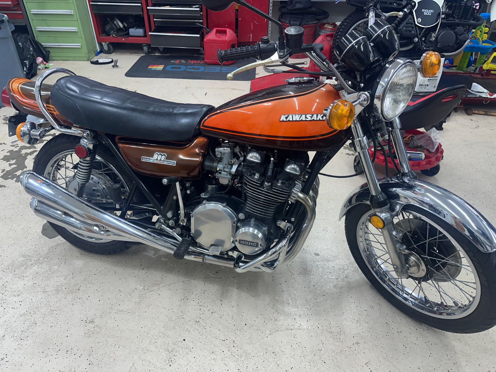

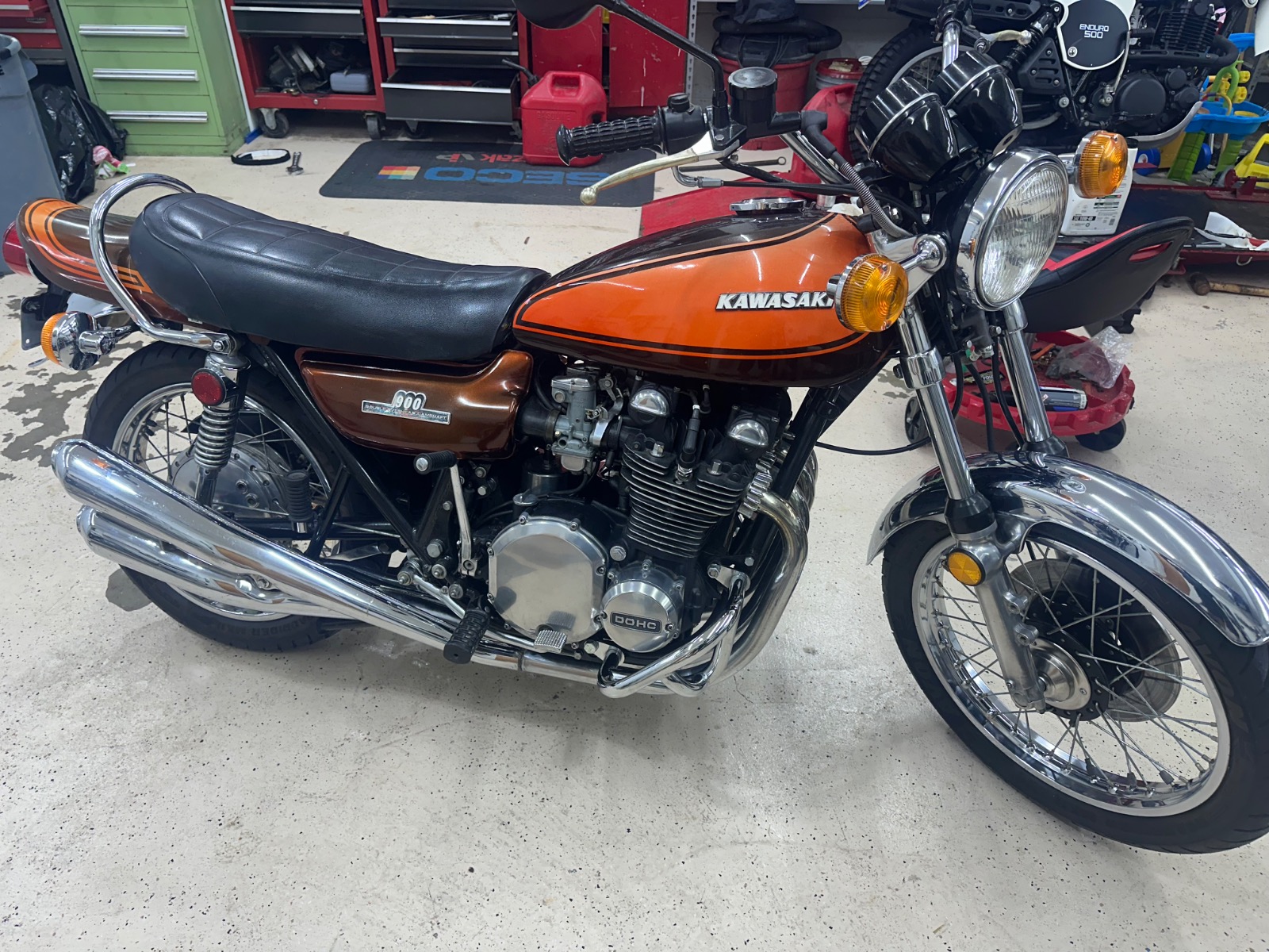

16 Dec 2025 11:02 - 16 Dec 2025 15:21Hi all,
I have a cylinder head gasket oil leak 73 z1 so planning on stripping the head and barrel off
125 psi on all cylinders
plan to hone and fit new rings if bores are in spec
28000 miles presume original pistons
what do you all recommend for good base and head gaskets and rings
located USA
thanks in advance
Mike

IMD or NPR rings. With the tariffs I would go with NPR. Retro cycles sells them on ebay. About $75 for the set. Cometic for the base gasket and OEM for the head gasket. Should be able to find a OEM head gasket or Versa if you cant. I would also replace those old cam sprockets with Liska sprockets while you in there. Use the solid mounts they offer for the center sprocket. If you really want to freshen things up you can split the cases and replace the cam chain with a heavy-duty DID from APE. Not that big of a deal to split the cases.Clean the cases and use Locktit 518 to seal it back up.
Looks like the bike is pretty much original. How long have you had it.

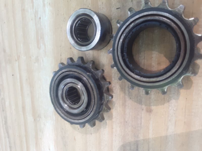

Forgot to mention sf4t7. Those HD camchains with heavier sideplates, not peanut style, are hard on original tensioners/cam sprockets where they have the rubber coating. I've seen those when used fling the bonded rubber right off those. And bizarre but last camchain i'd gotten from APE had split rollers, don't believe that's a good thing!!

Hey Clay, this is what I found last winter when I had the cylinder off. A time bomb waiting to demolish my engine!

I have owned it for over 10 years bought it covered in grease out of Arizona
got it running last year when I stupidly sold my 75 low mile z1 for a new kitchen
but it was never really dialed in so plan to keep it and ride

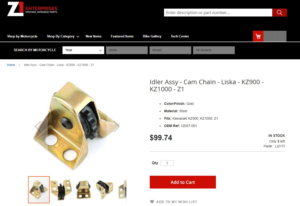

Wow idler assembly $238 from partzilla ?
- Posts: 6881
- Thanks: 4331
Re: First Post Gasket set & rings recommendation 73 z1
17 Dec 2025 06:25Wow idler assembly $238 from partzilla ?
The following user(s) said Thank You: Nessism, sf4t7
- sf4t7
- Posts: 1038
- Thanks: 890
17 Dec 2025 06:58
Yes Wookie, that's the idler.
Mike, you should also check the front and rear tensioner parts, the front and rear sprockets at the head to cylinder joint, and the idler roller at the base of the cylinders. Also the little rubber blocks at those points.
Tensioners, sprockets, roller, and rubber blocks are all available from Z1E also. The Liska billet sprockets, tensioner, and top idler make a little more noise than the rubber damped originals but they're bulletproof.

Wookie nothing against Z1E but are they "really" Liska's? I've seen a lot of copycats starting years ago. And since Jeff Saunders isn't still at the helm, those cats that bought him out will peddle anything to make a buck. I miss Jeff, might give him a call later. Sf4, i've plenty of those wrecked ones too, ha. But still have great ones. P4, that's why it retained it's nice appearance!! Preserved in a slather of mucky oily residue and in the arid Arizona climate. Looks like shaded too! Otherwise the Arizona Sun would of wrecked the paint, ha.
