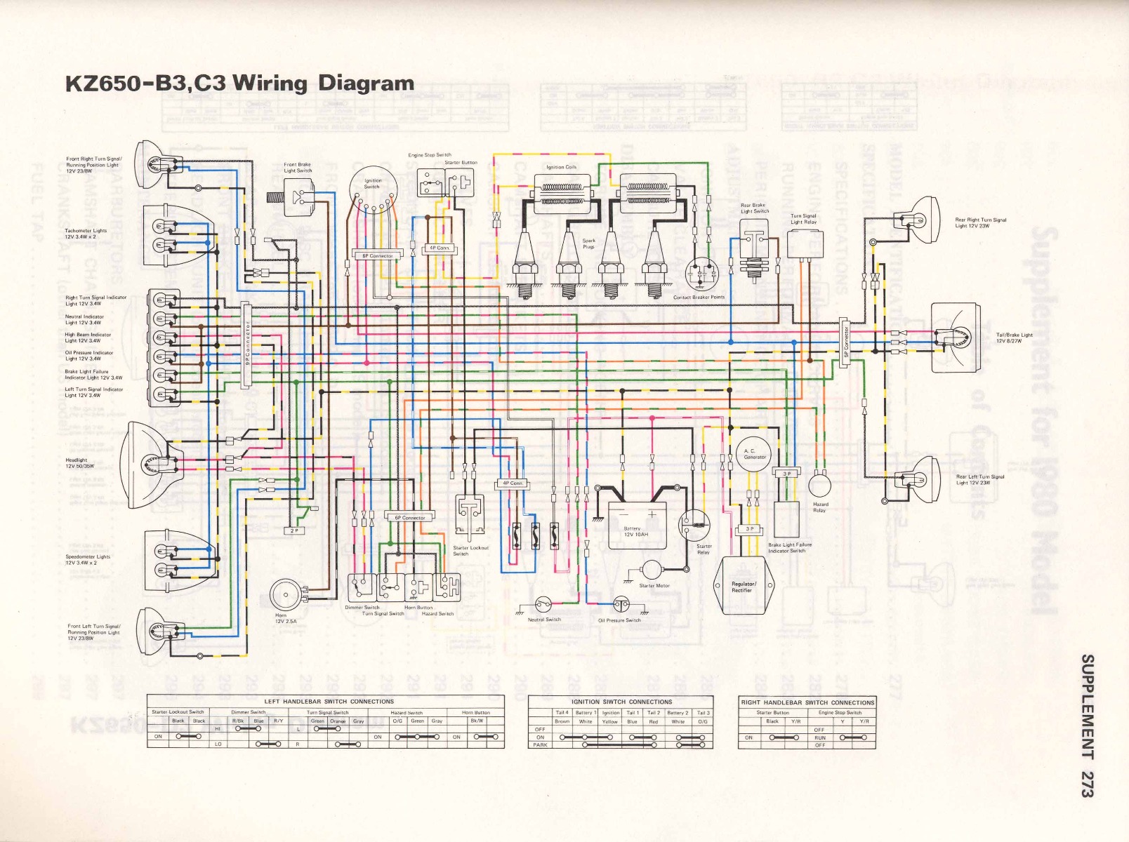

I did not see one in the filebase other than a West German one for the B# and C3. I have this one from a scan of a manual. Not sure that you need it but thought it might add to the topic.

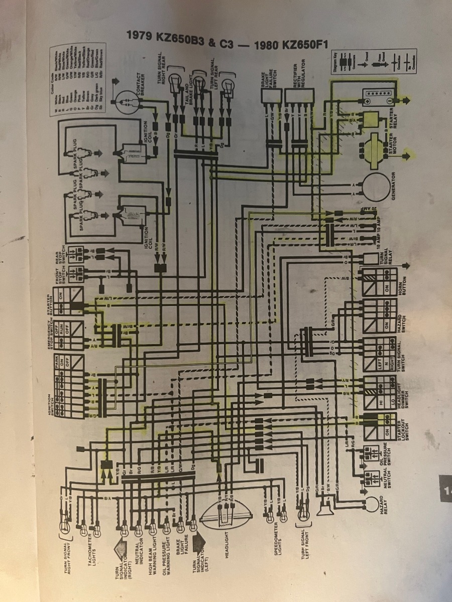

Thank you for the file gd4now - I have been using this diagram from the clymer manual. Yours is drawn differently and the colors are helpful. Thanks. The more information the better.

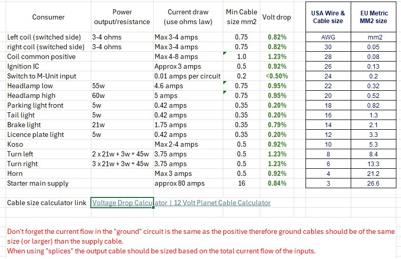

24 Oct 2025 03:17Single core cable is intended for buildings and "fixed structures" it is absolutely not suitable for automotive use. Aside from the lack of flexibility it is susceptible to fracturing due to "vibration fatigue". You should use "thin wall" multistrand cable. Thin wall refers to the insulation, automotive only uses 12v (generally) so thin wall is best for flexibility and also to prevent ending up with a loom the size of a "baby's arm". With regards gauge you need to look at the current flow in the circuit then use a calculator (there is a link to one in my elec fault finding guide) to establish wiring gauge which ensures a "volt drop" of less than 0.2v. Below is an example of a chart I put together for another member ref wire gauge for his projectthank you for the input Nessism -
