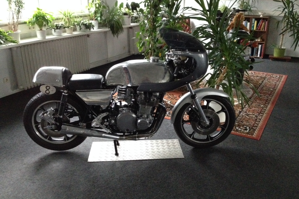

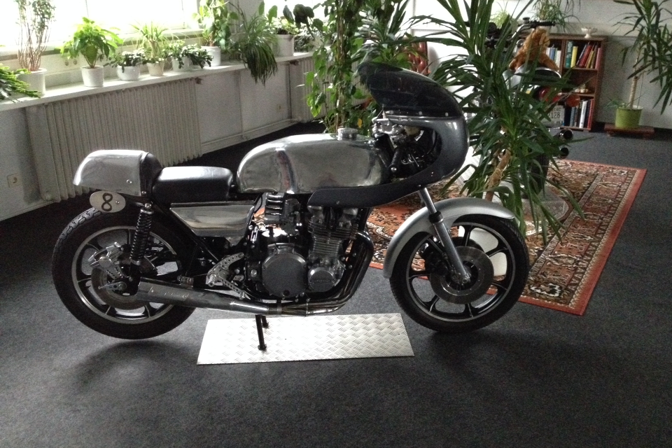

I once had a 1977 KZ1000 LTD that I converted slightly into a cafe racer. This frame had centerstand mounts and a centerstand. But of course, I can't guarantee that it was factory-installed like that...
Greetings, Joe
