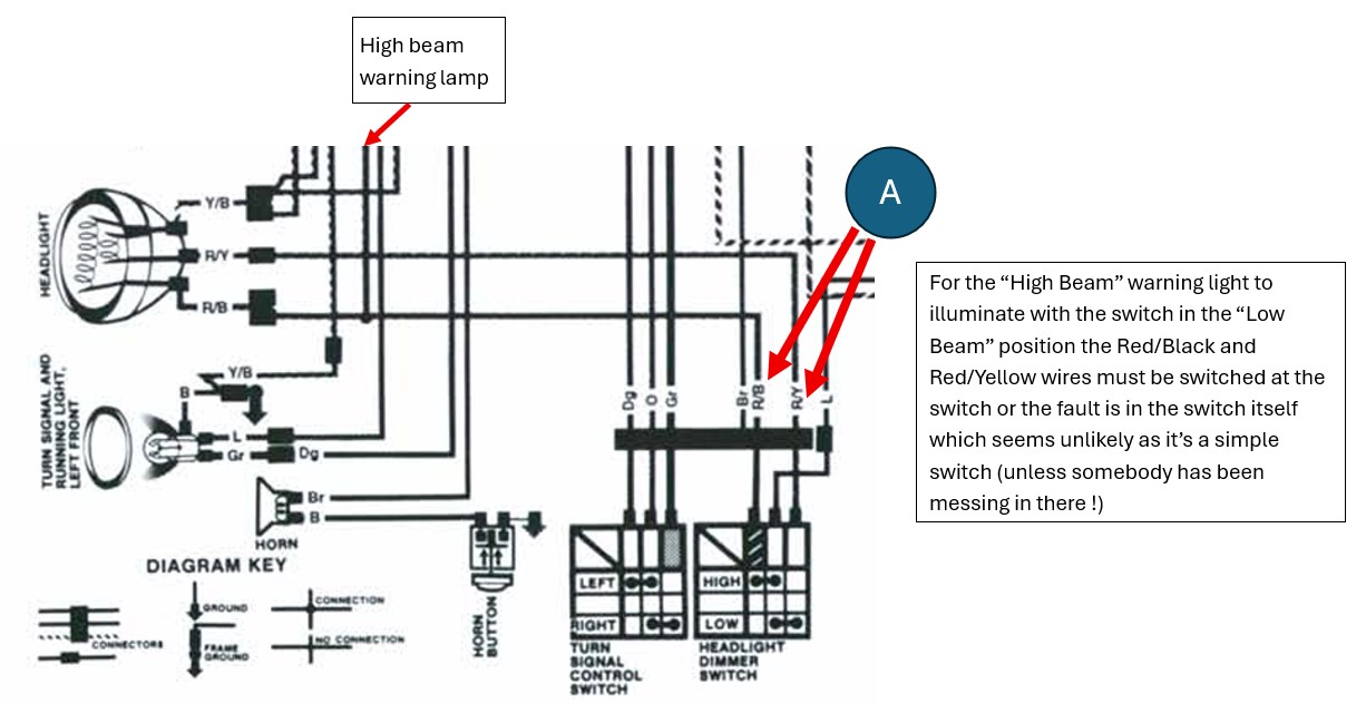

06 Jul 2025 11:40Wires are crossed either at the switch or the headlamp (does the High Beam warning light work when the switch is in the high position ?)Got the original signals installed and wallah! They work and blink. Now I just need to figure out why my low beam is on when the dimmer switch is on high beam and vice versa....

The high beam indicator works when the high beam is on, which is at the low beam position on the dimmer switch.

Okay i looked at the switch and realized that he definitely did not mess with it. I switched the red-yellow and black-red wires at the headlight to see what happened. The high and low beam were aligned with the switch but the high beam indicator stayed the way it was earlier---activated on low and deactivated on high.
This lead me to believe that the wiring for the high beam indicator was messed with. Sure enough, I looked at the bullet connector for the black-red wire behind the headlight it was connected to the yellow-red wire!!!!! the yellow-red and black-red wires were switched. I put them back and everything worked properly. I'm pretty sure that most or all of my electronic troubles have been officially resolved so thank you for your guidance 🙏 😌
