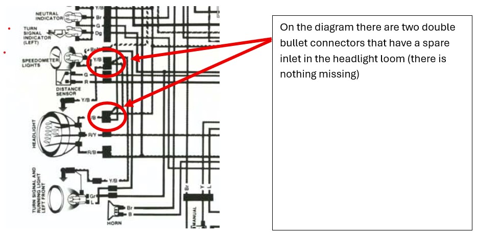

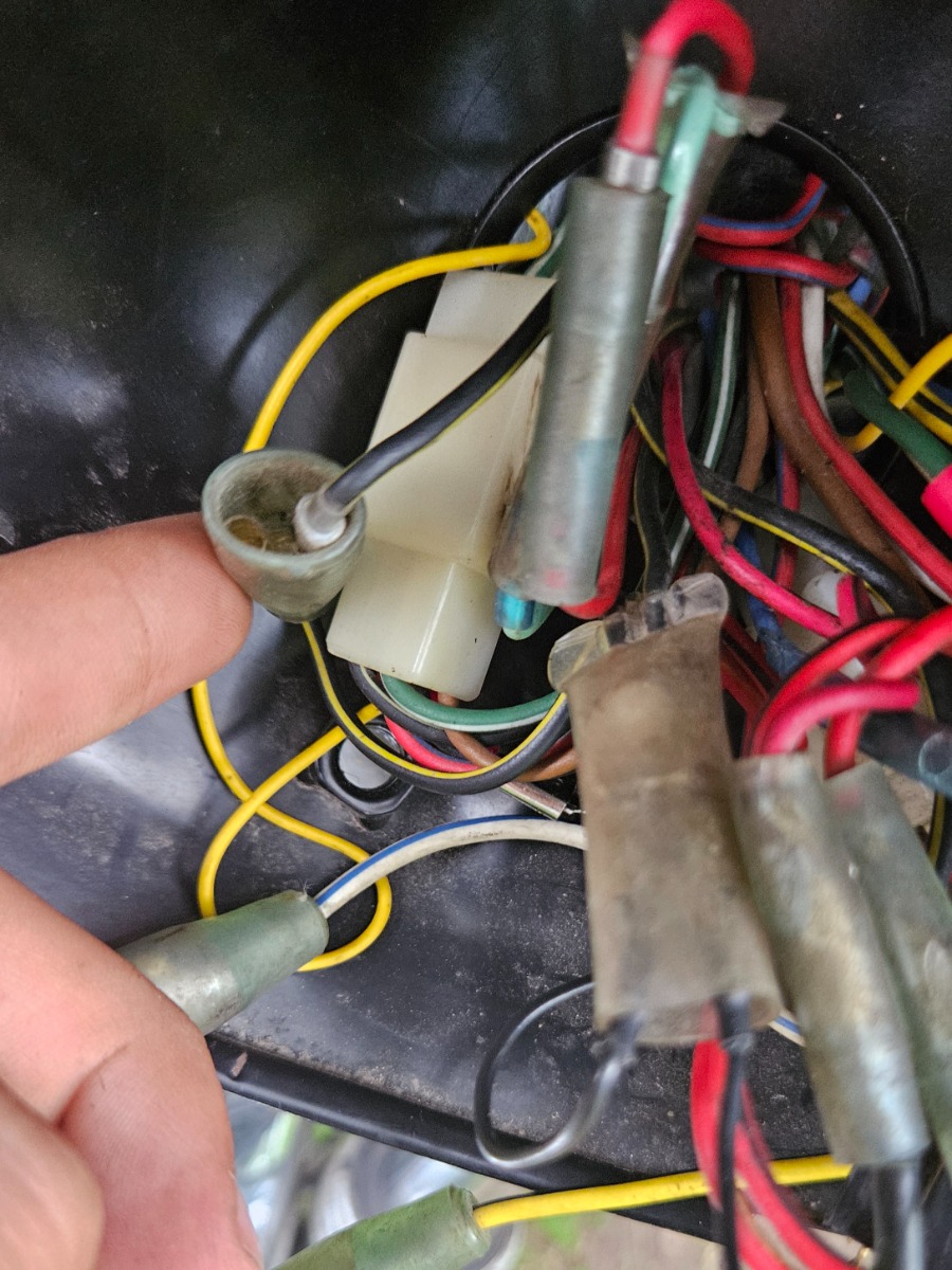

Currently my problem is that the last owner was not very kind to this beast and messed it up a lot. My turn signals don't blink when I activate them so went looking into the wiring and found a connector in the headlight area that is supposed to have a ground wire attached to it, but it is broken off.
After seeing that I looked into the wiring diagram and found what wire is supposed to be connected.
Right now, I'm curious where that wire grounds to so that I can connect it back. Hopefully that would resolve the blinker issue so there is one less thing that keeps me up at night.

Is the relay you have 2 pin (it should be) with a brown wire (ign live in) and an orange wire (output to the switch) you know the wiring is ok because the lights illuminate when you operate the switch which means the ign live is passing through the relay

Yeah it is 2 pin. I know the relay works now because I checked for continuity with no power so there wasn't any connection. That tells me that the relay is not sticking and is activating when I use my turn signal. If there was continuity with no power, that would tell me that the relay is sticking in the ON position. Tell me if I'm wrong about this.
I think it might be these aftermarket turn signals that I have. It's hard to tell if they are LED or not but I have OEM turn signals coming in the mail soon. I'll be happy about this because then I'll have running lights in the front.
Right now I'm now concerned about that missing ground wire. It grounds something so that thing may not be working properly. I may be wrong but it really appears to be grounding the front turn signals and maybe the headlight, but I am not very good at reading these diagrams 😅. Is there a rudimentary option to fix this or should I leave it be?

01 Jul 2025 01:40You might benefit from reading my "elec fault finding guide" link is in my signature.Yeah it is 2 pin. I know the relay works now because I checked for continuity with no power so there wasn't any connection.(what does this statement mean please, what are you actually checking and how?)
That tells me that the relay is not sticking and is activating when I use my turn signal. If there was continuity with no power, that would tell me that the relay is sticking in the ON position. Tell me if I'm wrong about this. Do you understand how a mechanical flasher relay works ? (see explanation below if not)
I think it might be these aftermarket turn signals that I have. It's hard to tell if they are LED or not but I have OEM turn signals coming in the mail soon If they are LED that would definitely cause issues with a mechanical relay (my understanding from your original post was that you already had the replacement OEM items) LED's can work with a different type of flasher relay but with a mechanical unit will either flash "too fast" or "not at all" due the the lower current draw.

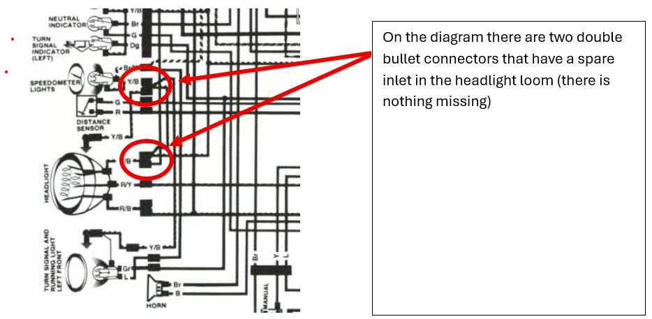

Right now I'm now concerned about that missing ground wire. It grounds something so that thing may not be working properly See the below diagram, there are multiple "spare" ground inputs built into the factory loom.
I may be wrong but it really appears to be grounding the front turn signals and maybe the headlight the turn signals and the headlight (if it works) must be grounded or they wouldn't illuminate so yes, I think you are wrong, but I am not very good at reading these diagrams 😅. Is there a rudimentary option to fix this or should I leave it be? You appear to be falling into the trap of "overthinking" the issue which is quite simple (easily done if electrics aren't your bag)
Mechanical flasher unit:
Inside the unit one contact is mounted on a bi-metal strip, when the turn signals are switched on current flows through the bi-metal strip and contacts to the turn signal switch
That current flow generates "heat" which causes the bi-metal strip to bend and open the contacts (flasher off)
As soon as the current flow is broken by the open contacts the bi-metal strip "cools" and bends back closing the contacts (flasher on)
This cycle repeats until the flasher switch is tuned off. The flash speed is determined by the current drawn by the lamps (flashers speed up when a bulb has failed)
LED's don't draw enough current to activate the bi-metal strip correctly if at all.
The following user(s) said Thank You: bound
